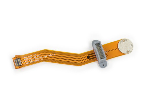

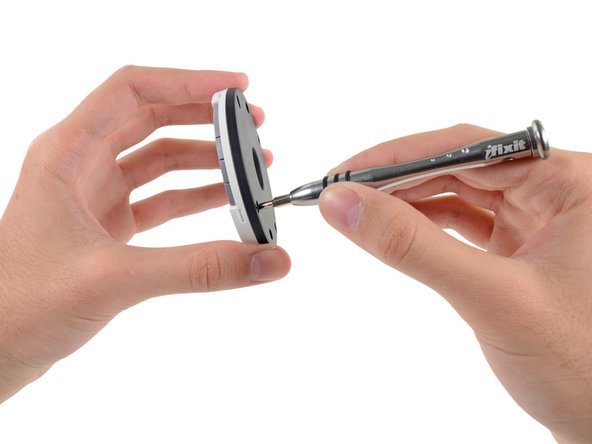

    • The back of the Nest display has two ports: a micro USB port that can be used for charging (and possibly hacking the Nest's software), and a proprietary 20-pin connector that fits onto the base unit's matching plug.
    • Removing a few screws allows us to separate the Nest display's rear panel from the rest of the unit and continue our exploration.
    • We'd like to point out that these screws can in fact be removed with the included driver. Way to make your product's internals accessible, Nest!

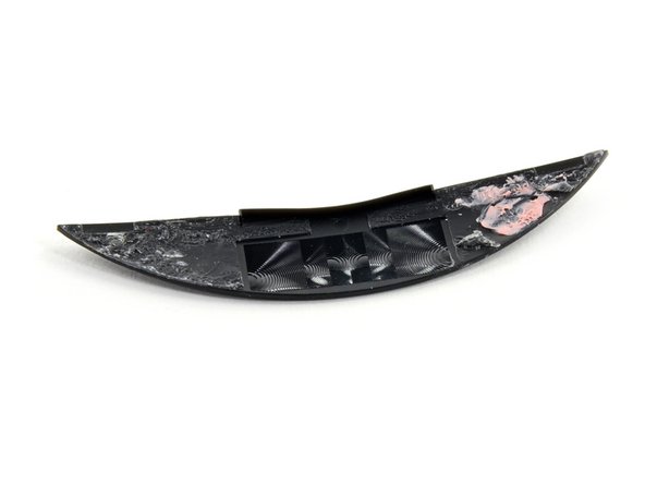

    • Our first foray into the front panel involves peeling off the small plastic plate adhered below the screen. Mild adhesive holds it securely in place, but is easily dispatched with a little patient spudgering.
    • The plastic plate turns out to actually be a window for infrared light, and is fitted with an array of Fresnel lenses that are used to widen the motion sensors' field of view and increase their range.
