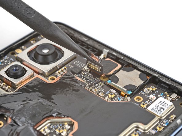

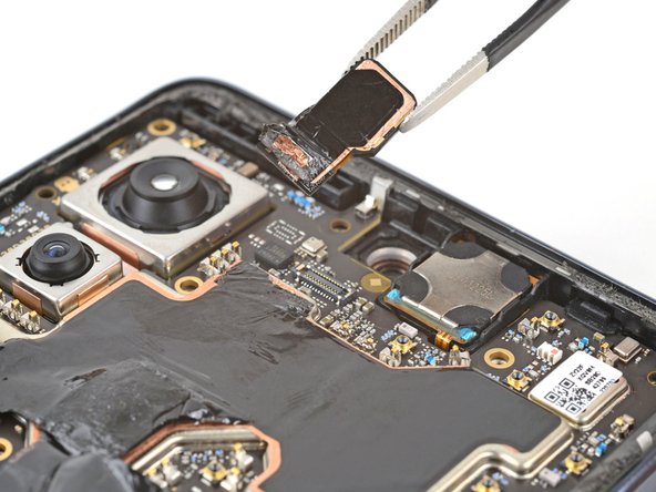

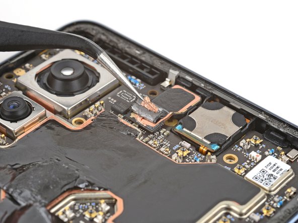

  25. Motorola Edge (2022) Front Camera Replacement, Peel the camera tape: crwdns2935265:025crwdnd2935265:01crwdnd2935265:02crwdne2935265:0 Motorola Edge (2022) Front Camera Replacement, Peel the camera tape: crwdns2935265:025crwdnd2935265:02crwdnd2935265:02crwdne2935265:0
    • Use tweezers to peel back the tape that connects the front camera to the motherboard.
  26. Motorola Edge (2022) Front Camera Replacement, Remove the front camera: crwdns2935265:026crwdnd2935265:01crwdnd2935265:03crwdne2935265:0 Motorola Edge (2022) Front Camera Replacement, Remove the front camera: crwdns2935265:026crwdnd2935265:02crwdnd2935265:03crwdne2935265:0 Motorola Edge (2022) Front Camera Replacement, Remove the front camera: crwdns2935265:026crwdnd2935265:03crwdnd2935265:03crwdne2935265:0
    • Use the pointed end of a spudger to pry up and disconnect the front camera's press connector.
    • Use your fingers or tweezers to remove the camera.
