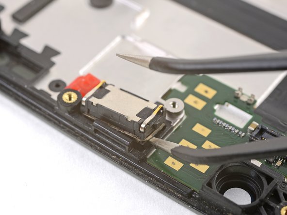

  14. Motorola Droid Turbo 2 Earpiece Speaker Replacement, Earpiece Speaker: crwdns2935265:014crwdnd2935265:01crwdnd2935265:02crwdne2935265:0 Motorola Droid Turbo 2 Earpiece Speaker Replacement, Earpiece Speaker: crwdns2935265:014crwdnd2935265:02crwdnd2935265:02crwdne2935265:0
    • The earpiece speaker module is very delicate and prone to breaking. Be gentle when handling the module.
    • Insert a pointed end of a pair of tweezers into a corner as far down as possible.
    • Pry very slightly to help loosen the earpiece speaker module.
    • Repeat the process in the remaining corners.

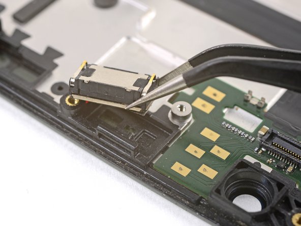

  15. Motorola Droid Turbo 2 Earpiece Speaker Replacement: crwdns2935265:015crwdnd2935265:01crwdnd2935265:03crwdne2935265:0 Motorola Droid Turbo 2 Earpiece Speaker Replacement: crwdns2935265:015crwdnd2935265:02crwdnd2935265:03crwdne2935265:0 Motorola Droid Turbo 2 Earpiece Speaker Replacement: crwdns2935265:015crwdnd2935265:03crwdnd2935265:03crwdne2935265:0
    • Continue to pry with the point of a pair of tweezers until the earpiece module feels loose.
    • Remove the earpiece module.
