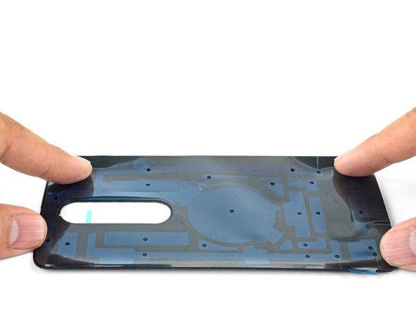

    • Set the pre-cut adhesive strip next to the rear cover so that it is properly oriented—the pull tabs should point to the bottom left corner of the cover.
    • Optionally, you can tape the pre-cut adhesive strip into position for easier application.
    • Lay the pre-cut adhesive strip over the rear cover, aligning it to the long edges.
    • Tape one long edge of the pre-cut adhesive strip to the rear cover, locking the alignment in place while allowing the strip to still swing.
  4. Motorola Droid Turbo 2 Rear Cover Adhesive Guide: crwdns2935265:04crwdnd2935265:01crwdnd2935265:02crwdne2935265:0 Motorola Droid Turbo 2 Rear Cover Adhesive Guide: crwdns2935265:04crwdnd2935265:02crwdnd2935265:02crwdne2935265:0
    • Peel and remove the clear plastic liner from the pre-cut adhesive strip.
    • This will expose adhesive facing the rear cover, so don't remove the liner until you are ready to begin placement.
  5. Motorola Droid Turbo 2 Rear Cover Adhesive Guide: crwdns2935265:05crwdnd2935265:01crwdnd2935265:03crwdne2935265:0 Motorola Droid Turbo 2 Rear Cover Adhesive Guide: crwdns2935265:05crwdnd2935265:02crwdnd2935265:03crwdne2935265:0 Motorola Droid Turbo 2 Rear Cover Adhesive Guide: crwdns2935265:05crwdnd2935265:03crwdnd2935265:03crwdne2935265:0

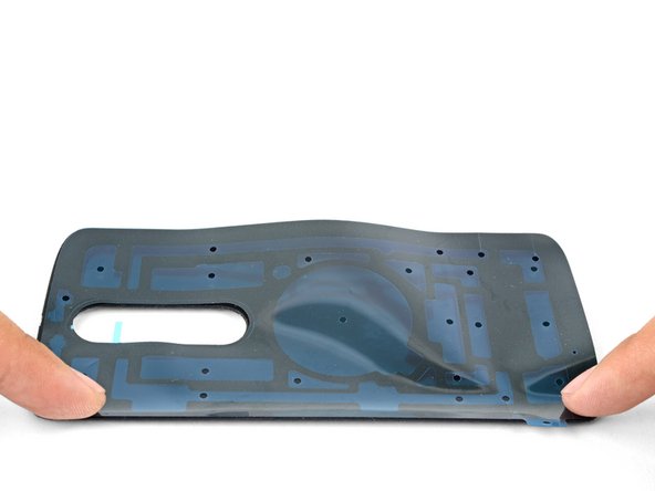

    • The exposed adhesive is very sticky and prone to adhering to surfaces unintentionally. Be careful while handling and aligning the adhesive.
    • Align the adhesive strip to a long edge of the rear cover.
    • If you have previously taped the adhesive strip to the rear cover, the strip should already be aligned.
    • Beginning from the alignment edge, use your fingers to press the adhesive strip onto the rear cover.

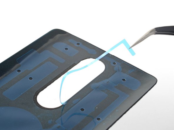

    • Pull and remove the blue liner tab located in the rear cover's rear camera hole.
    • This will expose a ring of adhesive around the hole, which will hold the rear camera plate in place.
