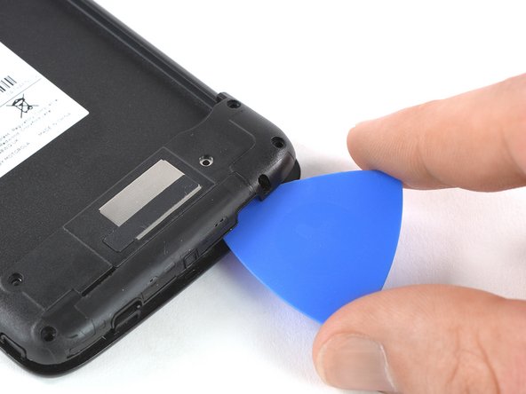

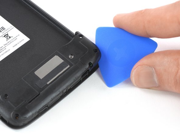

    • Insert a thumbnail, or spudger, into the notch on the bottom right corner to start separating the phone unit from the back cover.
    • Move it to the bottom left corner and pry the phone unit out of the back cover until you can get a good grip.

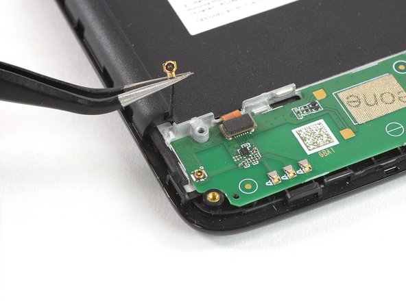

  19. Moto C Screen Assembly Replacement: crwdns2935265:019crwdnd2935265:01crwdnd2935265:03crwdne2935265:0 Moto C Screen Assembly Replacement: crwdns2935265:019crwdnd2935265:02crwdnd2935265:03crwdne2935265:0 Moto C Screen Assembly Replacement: crwdns2935265:019crwdnd2935265:03crwdnd2935265:03crwdne2935265:0
    • Fold the motherboard over the battery cavity to access the coaxial cable connectors.
  20. Moto C Screen Assembly Replacement: crwdns2935265:020crwdnd2935265:01crwdnd2935265:02crwdne2935265:0 Moto C Screen Assembly Replacement: crwdns2935265:020crwdnd2935265:02crwdnd2935265:02crwdne2935265:0
    • Use a pair of tweezers to pry up and disconnect the antenna cable from the back of the motherboard.
  21. Moto C Screen Assembly Replacement: crwdns2935265:021crwdnd2935265:01crwdnd2935265:01crwdne2935265:0
    • Remove the motherboard.

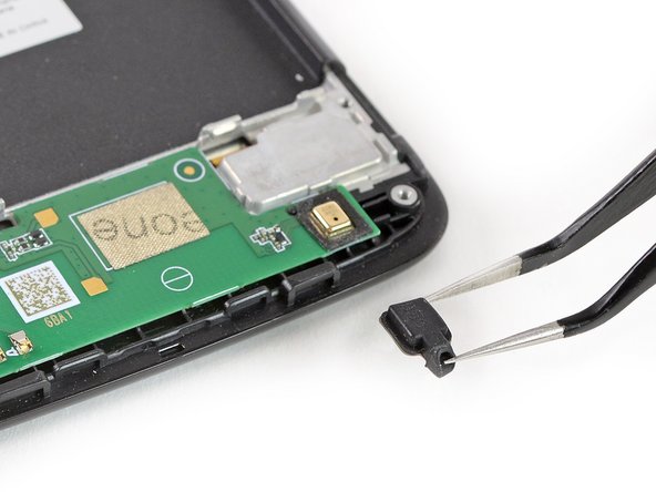

    • Use a pair of tweezers to remove the rubber gasket that covers the microphone on the bottom right of the daughterboard.

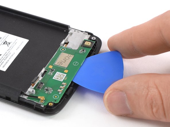

  25. Moto C Screen Assembly Replacement: crwdns2935265:025crwdnd2935265:01crwdnd2935265:01crwdne2935265:0
    • Prepare an iOpener and apply it to the bottom part of the display for at least two minutes to loosen the adhesive beneath the daughterboard.
  26. Moto C Screen Assembly Replacement: crwdns2935265:026crwdnd2935265:01crwdnd2935265:03crwdne2935265:0 Moto C Screen Assembly Replacement: crwdns2935265:026crwdnd2935265:02crwdnd2935265:03crwdne2935265:0 Moto C Screen Assembly Replacement: crwdns2935265:026crwdnd2935265:03crwdnd2935265:03crwdne2935265:0

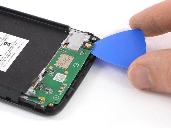

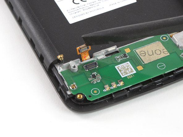

    • Apply an opening pick to the bottom right corner of the daughterboard.
    • Carefully slide the opening pick under the daughterboard to cut the adhesive underneath.
    • Slide the opening pick from right to left to cut all the adhesive.

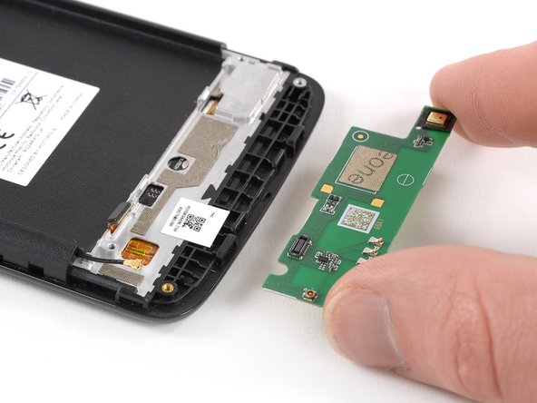

  27. Moto C Screen Assembly Replacement: crwdns2935265:027crwdnd2935265:01crwdnd2935265:02crwdne2935265:0 Moto C Screen Assembly Replacement: crwdns2935265:027crwdnd2935265:02crwdnd2935265:02crwdne2935265:0
    • Twist the opening pick to lift the daughterboard until you can get a good grip.
    • Remove the daughterboard.

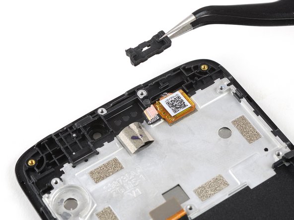

  28. Moto C Screen Assembly Replacement, Earpiece Speaker: crwdns2935265:028crwdnd2935265:01crwdnd2935265:02crwdne2935265:0 Moto C Screen Assembly Replacement, Earpiece Speaker: crwdns2935265:028crwdnd2935265:02crwdnd2935265:02crwdne2935265:0
    • Remove the ear piece speaker.
    • When reassembling, be sure to properly orient the earpiece speaker such that the gold contacts are pointing away from the top edge.

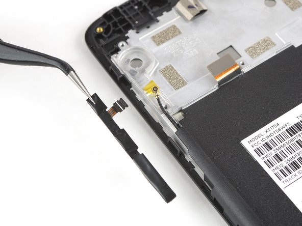

  29. Moto C Screen Assembly Replacement, Screen Assembly: crwdns2935265:029crwdnd2935265:01crwdnd2935265:02crwdne2935265:0 Moto C Screen Assembly Replacement, Screen Assembly: crwdns2935265:029crwdnd2935265:02crwdnd2935265:02crwdne2935265:0
    • Use a pair of tweezers to grab and remove the charging port rubber gasket.
  30. Moto C Screen Assembly Replacement: crwdns2935265:030crwdnd2935265:01crwdnd2935265:03crwdne2935265:0 Moto C Screen Assembly Replacement: crwdns2935265:030crwdnd2935265:02crwdnd2935265:03crwdne2935265:0 Moto C Screen Assembly Replacement: crwdns2935265:030crwdnd2935265:03crwdnd2935265:03crwdne2935265:0
    • Use a pair of tweezers to gently peel off and remove the power and volume buttons.

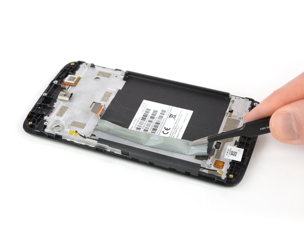

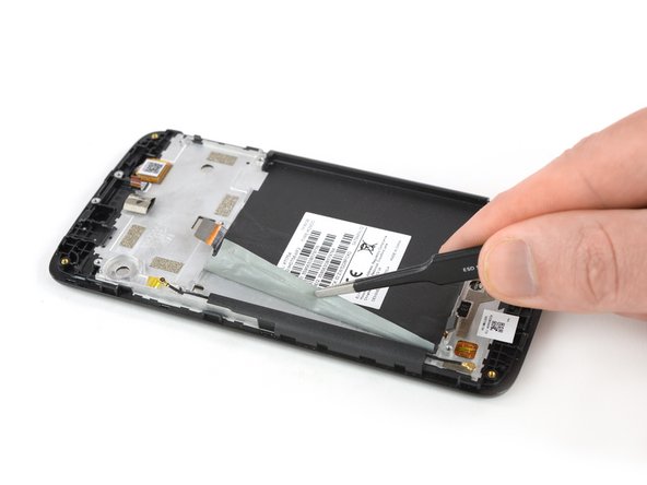

  31. Moto C Screen Assembly Replacement: crwdns2935265:031crwdnd2935265:01crwdnd2935265:01crwdne2935265:0
    • Prepare an iOpener and apply it for at least two minutes on the back of the phone to loosen the adhesive tape that sits on top of the display flex cable.
  32. Moto C Screen Assembly Replacement: crwdns2935265:032crwdnd2935265:01crwdnd2935265:03crwdne2935265:0 Moto C Screen Assembly Replacement: crwdns2935265:032crwdnd2935265:02crwdnd2935265:03crwdne2935265:0 Moto C Screen Assembly Replacement: crwdns2935265:032crwdnd2935265:03crwdnd2935265:03crwdne2935265:0

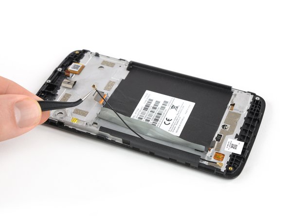

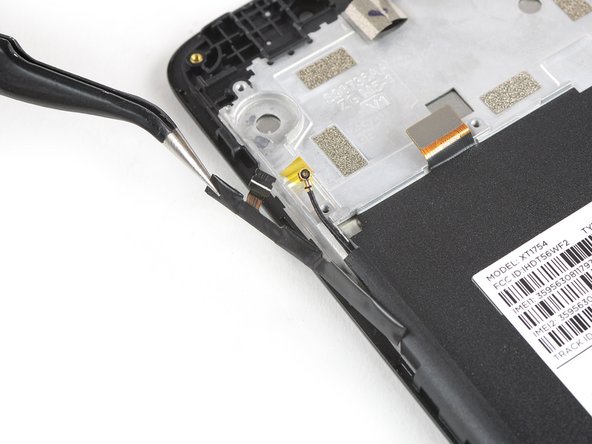

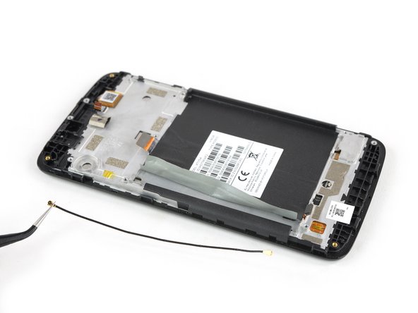

    • Use a pair of tweezers to peel the adhesive tape off the left side where the antenna cable runs and fold it out of the way.
  33. Moto C Screen Assembly Replacement: crwdns2935265:033crwdnd2935265:01crwdnd2935265:03crwdne2935265:0 Moto C Screen Assembly Replacement: crwdns2935265:033crwdnd2935265:02crwdnd2935265:03crwdne2935265:0 Moto C Screen Assembly Replacement: crwdns2935265:033crwdnd2935265:03crwdnd2935265:03crwdne2935265:0
    • Use a pair of tweezers to pull the antenna cable out of its routing and remove it.
