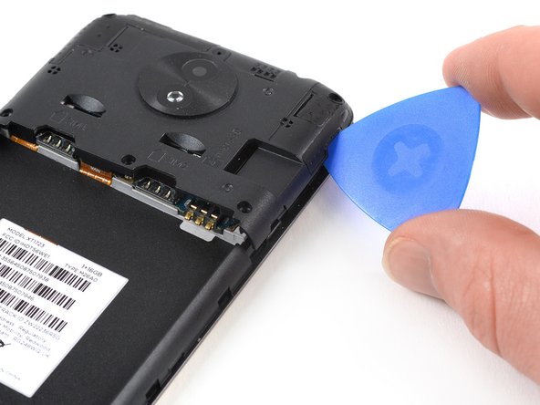

      • Power off your phone before beginning disassembly.
      • Insert a thumbnail, or spudger, into the notch on the bottom right to start separating the phone unit from the back cover.
      • Move to the bottom left corner and pry the phone unit out of the back cover until you can get a good grip.

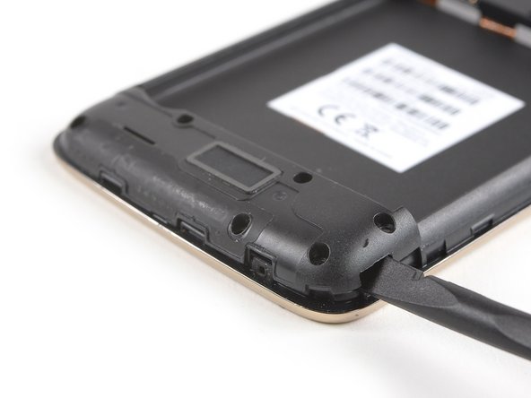

      • Apply a spudger to the right side of the daughterboard cover.
      • Twist the spudger sideways to pry up the daughterboard cover until you get a good grip.
      • Remove the daughterboard cover.

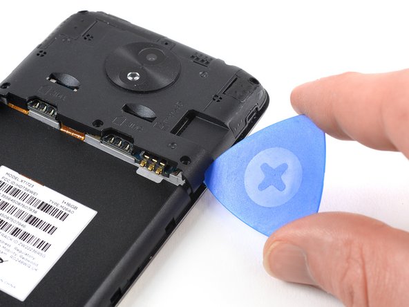

      • Apply an opening pick to the bottom right corner of the motherboard cover.
      • Twist the opening pick to free the motherboard cover out of the plastic clamps on the right side of the phone.
    3. Moto C Plus Screen Assembly Replacement: crwdns2935265:08crwdnd2935265:01crwdnd2935265:02crwdne2935265:0 Moto C Plus Screen Assembly Replacement: crwdns2935265:08crwdnd2935265:02crwdnd2935265:02crwdne2935265:0
      • Repeat the previous step on the left side of the motherboard cover to free it out of the plastic clamps.
      • Pry up the motherboard cover until you can get a good grip.
      • Remove the motherboard cover.

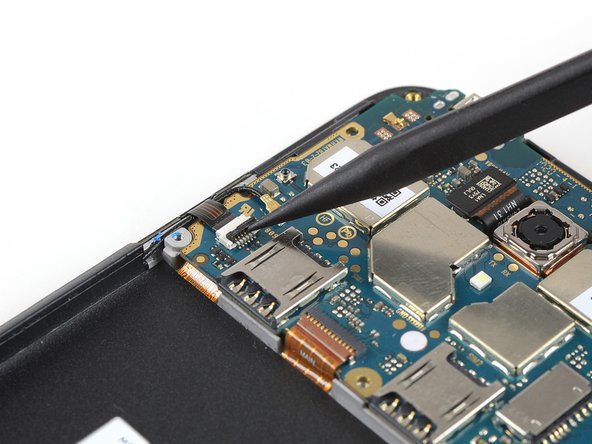

      • Use the tip of a spudger to lift the latch on the power and volume button ZIF connector.
    3. Moto C Plus Screen Assembly Replacement: crwdns2935265:011crwdnd2935265:01crwdnd2935265:02crwdne2935265:0 Moto C Plus Screen Assembly Replacement: crwdns2935265:011crwdnd2935265:02crwdnd2935265:02crwdne2935265:0
      • Use a pair of tweezers to pull the power and volume button flex cable out of the ZIF connector.
      • Fold the power and volume button flex cable out of the way.

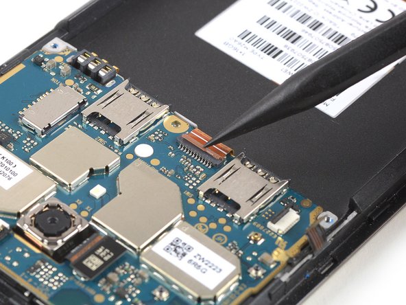

    5. Moto C Plus Screen Assembly Replacement: crwdns2935265:013crwdnd2935265:01crwdnd2935265:02crwdne2935265:0 Moto C Plus Screen Assembly Replacement: crwdns2935265:013crwdnd2935265:02crwdnd2935265:02crwdne2935265:0

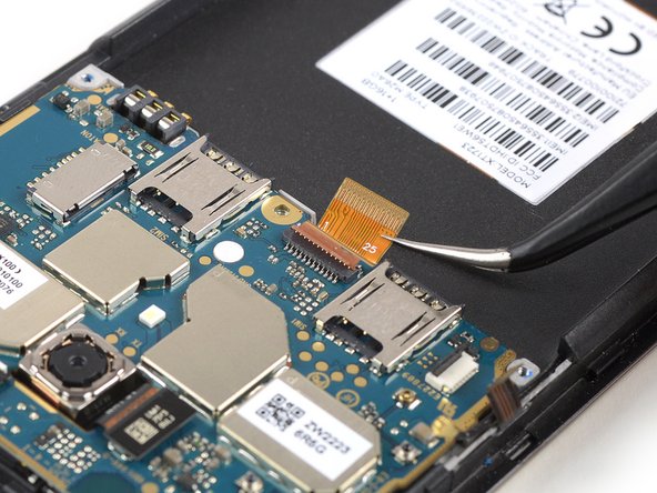

      • Use the tip of a spudger to open the interconnect cable ZIF connector by lifting the brown flap.
      • When reassembling make sure the white line on the cable aligns with the closed flap.
    6. Moto C Plus Screen Assembly Replacement: crwdns2935265:014crwdnd2935265:01crwdnd2935265:02crwdne2935265:0 Moto C Plus Screen Assembly Replacement: crwdns2935265:014crwdnd2935265:02crwdnd2935265:02crwdne2935265:0
      • Use a pair of tweezers to pull the interconnect flex cable out of the ZIF connector.

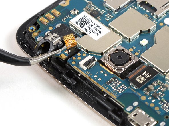

    7. Moto C Plus Screen Assembly Replacement: crwdns2935265:015crwdnd2935265:01crwdnd2935265:02crwdne2935265:0 Moto C Plus Screen Assembly Replacement: crwdns2935265:015crwdnd2935265:02crwdnd2935265:02crwdne2935265:0
      • Use the tip of a spudger to open the flap of the ZIF connector next to the headphone jack.
    8. Moto C Plus Screen Assembly Replacement: crwdns2935265:016crwdnd2935265:01crwdnd2935265:02crwdne2935265:0 Moto C Plus Screen Assembly Replacement: crwdns2935265:016crwdnd2935265:02crwdnd2935265:02crwdne2935265:0
      • Use a pair of tweezers to pull the flex cable out of the ZIF connector.

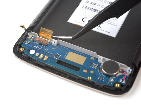

    1. Moto C Plus Screen Assembly Replacement, Daughterboard: crwdns2935265:020crwdnd2935265:01crwdnd2935265:02crwdne2935265:0 Moto C Plus Screen Assembly Replacement, Daughterboard: crwdns2935265:020crwdnd2935265:02crwdnd2935265:02crwdne2935265:0
      • Disconnect the antenna cable and fold it out of the way.

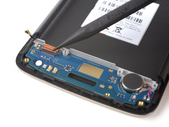

    2. Moto C Plus Screen Assembly Replacement: crwdns2935265:021crwdnd2935265:01crwdnd2935265:02crwdne2935265:0 Moto C Plus Screen Assembly Replacement: crwdns2935265:021crwdnd2935265:02crwdnd2935265:02crwdne2935265:0
      • Use the tip of a spudger to open the brown flap of the ZIF connector that holds the interconnect cable in its place.
    3. Moto C Plus Screen Assembly Replacement: crwdns2935265:022crwdnd2935265:01crwdnd2935265:02crwdne2935265:0 Moto C Plus Screen Assembly Replacement: crwdns2935265:022crwdnd2935265:02crwdnd2935265:02crwdne2935265:0

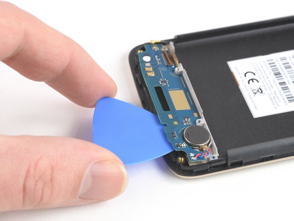

    4. Moto C Plus Screen Assembly Replacement: crwdns2935265:023crwdnd2935265:01crwdnd2935265:01crwdne2935265:0

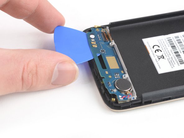

      • Prepare an iOpener and apply it to the bottom part of the display for at least two minutes to loosen the adhesive beneath the daughterboard.
    5. Moto C Plus Screen Assembly Replacement: crwdns2935265:024crwdnd2935265:01crwdnd2935265:03crwdne2935265:0 Moto C Plus Screen Assembly Replacement: crwdns2935265:024crwdnd2935265:02crwdnd2935265:03crwdne2935265:0 Moto C Plus Screen Assembly Replacement: crwdns2935265:024crwdnd2935265:03crwdnd2935265:03crwdne2935265:0
      • Apply an opening pick to the bottom edge of the daughterboard.
      • Carefully slide the opening pick under the daughterboard to cut the adhesive underneath.
      • Take care to cut the adhesive underneath the vibration motor.
      • Slide the opening pick from right to left to cut all the adhesive.
    6. Moto C Plus Screen Assembly Replacement: crwdns2935265:025crwdnd2935265:01crwdnd2935265:01crwdne2935265:0
      • Remove the daughterboard including the soldered-on vibration motor.

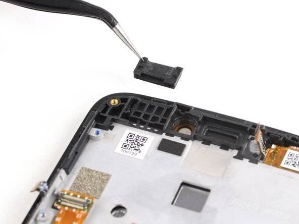

    1. Moto C Plus Screen Assembly Replacement, Earpiece Speaker: crwdns2935265:026crwdnd2935265:01crwdnd2935265:01crwdne2935265:0

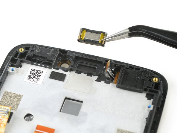

      • Use an iOpener and apply it to the top edge of the display to loosen the adhesive beneath the earpiece speaker.
    2. Moto C Plus Screen Assembly Replacement: crwdns2935265:027crwdnd2935265:01crwdnd2935265:02crwdne2935265:0 Moto C Plus Screen Assembly Replacement: crwdns2935265:027crwdnd2935265:02crwdnd2935265:02crwdne2935265:0
      • Use a pair of tweezers to carefully grab and remove the earpiece speaker.

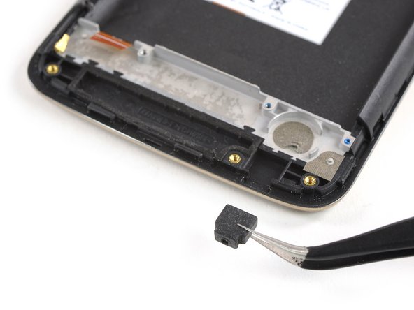

    3. Moto C Plus Screen Assembly Replacement: crwdns2935265:030crwdnd2935265:01crwdnd2935265:02crwdne2935265:0 Moto C Plus Screen Assembly Replacement: crwdns2935265:030crwdnd2935265:02crwdnd2935265:02crwdne2935265:0
      • Use a pair of tweezers to grab and remove the microphone rubber gasket at the bottom right end of your phone.

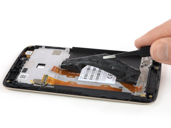

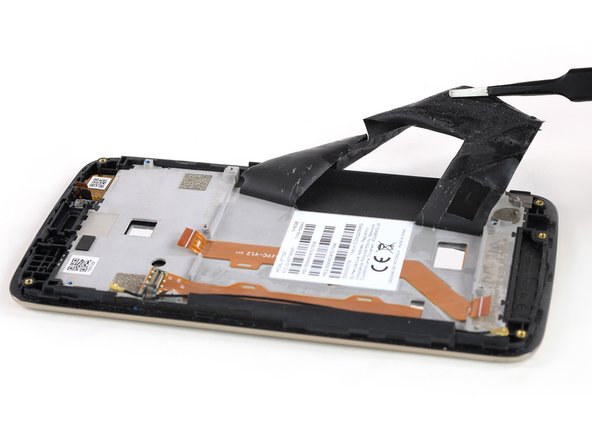

    4. Moto C Plus Screen Assembly Replacement: crwdns2935265:031crwdnd2935265:01crwdnd2935265:01crwdne2935265:0
      • Use an iOpener to loosen the adhesive tape that sits on top of the interconnect and display flex cable. Apply the iOpener on the tape for at least two minutes.
    5. Moto C Plus Screen Assembly Replacement: crwdns2935265:032crwdnd2935265:01crwdnd2935265:03crwdne2935265:0 Moto C Plus Screen Assembly Replacement: crwdns2935265:032crwdnd2935265:02crwdnd2935265:03crwdne2935265:0 Moto C Plus Screen Assembly Replacement: crwdns2935265:032crwdnd2935265:03crwdnd2935265:03crwdne2935265:0
      • Use a pair of tweezers to gently peel the adhesive tape off the flex cables and fold it out of the way.

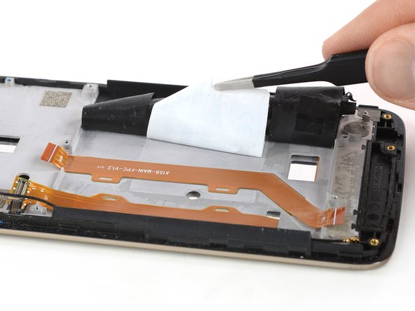

    6. Moto C Plus Screen Assembly Replacement: crwdns2935265:033crwdnd2935265:01crwdnd2935265:02crwdne2935265:0 Moto C Plus Screen Assembly Replacement: crwdns2935265:033crwdnd2935265:02crwdnd2935265:02crwdne2935265:0
      • Use a pair of tweezers to gently peel the product sticker off the interconnect cable.
      • In case you can't remove the sticker or it starts to rip apart you can re-apply an iOpener to loosen the adhesive.
    7. Moto C Plus Screen Assembly Replacement: crwdns2935265:034crwdnd2935265:01crwdnd2935265:02crwdne2935265:0 Moto C Plus Screen Assembly Replacement: crwdns2935265:034crwdnd2935265:02crwdnd2935265:02crwdne2935265:0
      • Use a pair of tweezers to grab and carefully peel up the interconnect flex cable.
      • Remove the interconnect flex cable.

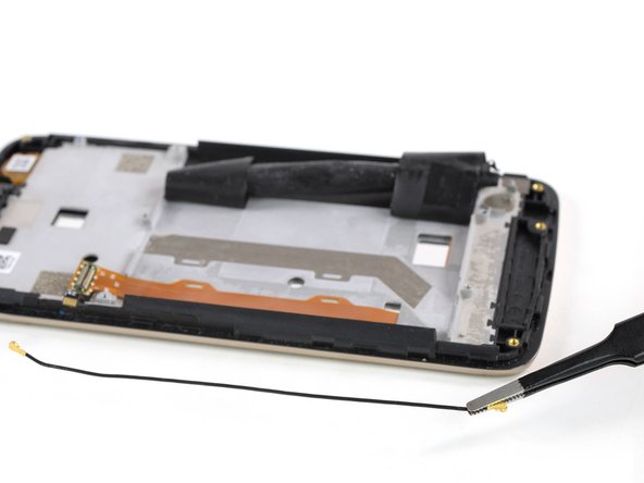

    8. Moto C Plus Screen Assembly Replacement: crwdns2935265:035crwdnd2935265:01crwdnd2935265:02crwdne2935265:0 Moto C Plus Screen Assembly Replacement: crwdns2935265:035crwdnd2935265:02crwdnd2935265:02crwdne2935265:0
      • Use a pair of tweezers to remove the antenna cable.
