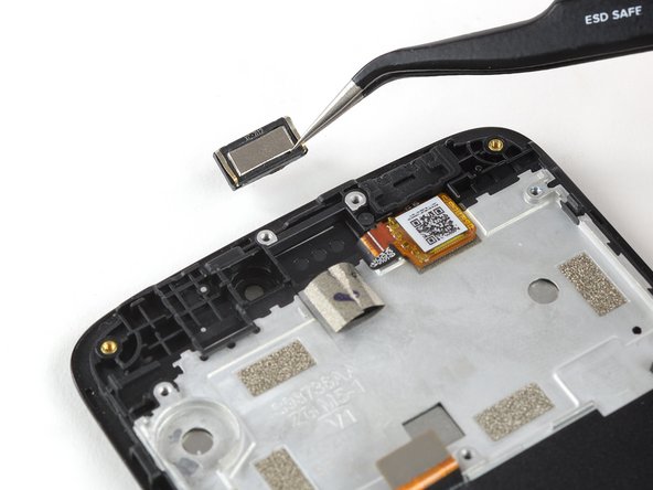

  19. Moto C Earpiece Speaker Replacement, Earpiece Speaker: crwdns2935265:019crwdnd2935265:01crwdnd2935265:02crwdne2935265:0 Moto C Earpiece Speaker Replacement, Earpiece Speaker: crwdns2935265:019crwdnd2935265:02crwdnd2935265:02crwdne2935265:0
    • Remove the ear piece speaker.
    • When reassembling, be sure to properly orient the earpiece speaker such that the gold contacts are pointing away from the top edge.
