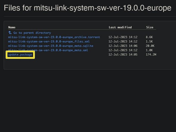

  4. Mitsubishi Hands Free Module Firmware Update (MMCS NR-242), Download the Firmware: crwdns2935265:04crwdnd2935265:01crwdnd2935265:02crwdne2935265:0 Mitsubishi Hands Free Module Firmware Update (MMCS NR-242), Download the Firmware: crwdns2935265:04crwdnd2935265:02crwdnd2935265:02crwdne2935265:0
  5. Mitsubishi Hands Free Module Firmware Update (MMCS NR-242), Move the File: crwdns2935265:05crwdnd2935265:01crwdnd2935265:01crwdne2935265:0
    • The flash drive needs to be formatted to FAT32 and should not be larger than 16GB. Additionally the MMCS can be a bit picky and might not accept all flash drives. If it can't read your flash drive, just try a different one.
    • Copy the update.package file to the root directory of the USB flash drive.
