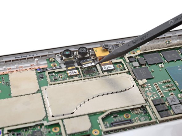

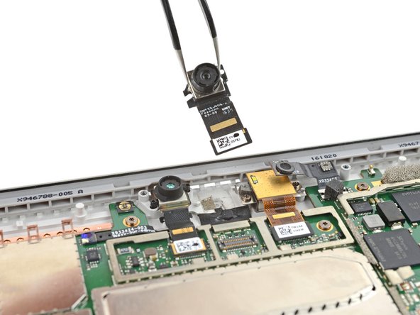

  31. Microsoft Surface Pro 4 Front Camera Replacement, Remove the upper EMI shield: crwdns2935265:031crwdnd2935265:01crwdnd2935265:03crwdne2935265:0 Microsoft Surface Pro 4 Front Camera Replacement, Remove the upper EMI shield: crwdns2935265:031crwdnd2935265:02crwdnd2935265:03crwdne2935265:0 Microsoft Surface Pro 4 Front Camera Replacement, Remove the upper EMI shield: crwdns2935265:031crwdnd2935265:03crwdnd2935265:03crwdne2935265:0
    • Insert one point of a pair of pointed tweezers into a gap in the corner of the EMI shield covering the camera connectors.
    • Use the tweezers to pry the EMI shield away from the motherboard as much as you can without bending it.
    • Try not to deform the shield too much—you will need to reinstall it during reassembly.
    • Remove the EMI shield.
  32. Microsoft Surface Pro 4 Front Camera Replacement, Disconnect the front camera: crwdns2935265:032crwdnd2935265:01crwdnd2935265:02crwdne2935265:0 Microsoft Surface Pro 4 Front Camera Replacement, Disconnect the front camera: crwdns2935265:032crwdnd2935265:02crwdnd2935265:02crwdne2935265:0
    • Use the pointed end of your spudger to disconnect the front camera from the motherboard.
  33. Microsoft Surface Pro 4 Front Camera Replacement, Heat the front camera: crwdns2935265:033crwdnd2935265:01crwdnd2935265:01crwdne2935265:0
    • Turn over your device so the back is facing up.
    • Place a heated iOpener on the cameras for one minute.
  34. Microsoft Surface Pro 4 Front Camera Replacement, Remove the front camera: crwdns2935265:034crwdnd2935265:01crwdnd2935265:02crwdne2935265:0 Microsoft Surface Pro 4 Front Camera Replacement, Remove the front camera: crwdns2935265:034crwdnd2935265:02crwdnd2935265:02crwdne2935265:0
    • Remove the iOpener.
    • Turn your device back over.
    • Use tweezers or your fingers to remove the front camera.
    • During reassembly, you can either reuse the residual adhesive or clean it with highly-concentrated isopropyl alcohol (over 90%) and install new adhesive.
