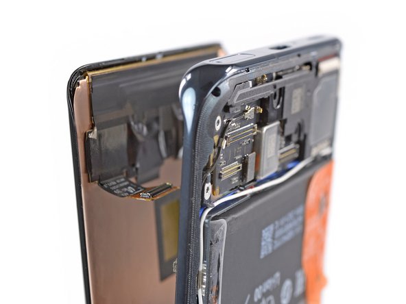

Use this guide to remove or replace the screen on your Xiaomi Mi 11.
If the frame is deformed, it's important to replace it to make sure the new screen will mount correctly and won’t suffer damage from uneven pressure.
Note: This guide instructs you to replace only the screen while leaving the original frame and motherboard in place. However, some replacement screens for this phone come pre-installed in a new frame (a.k.a. chassis), which requires a very different procedure. Make sure you have the correct part before starting this guide.
Before you begin this procedure, be sure to have a set of replacement adhesives for both the back panel and the screen.
Note: In this guide we’re using a teardown device. This means that the motherboard has been deshielded during the teardown procedure. You can still do all the repairs with this guide but your motherboard will look like this.

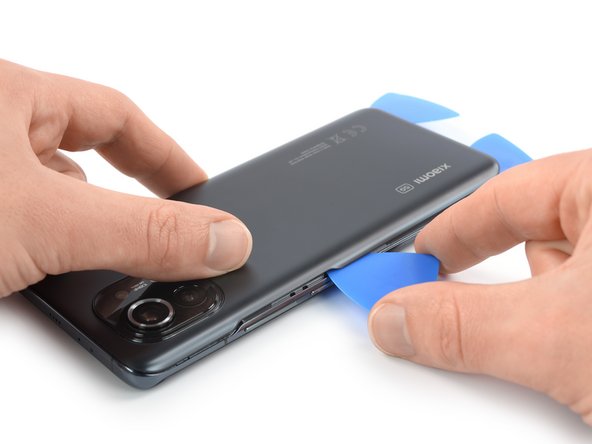

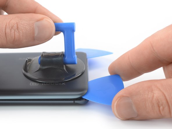

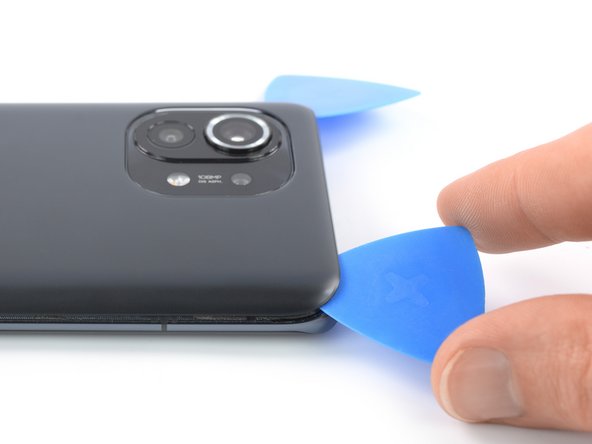

    2. Mi 11 Screen Replacement, Insert an opening pick: crwdns2935265:02crwdnd2935265:01crwdnd2935265:03crwdne2935265:0 Mi 11 Screen Replacement, Insert an opening pick: crwdns2935265:02crwdnd2935265:02crwdnd2935265:03crwdne2935265:0 Mi 11 Screen Replacement, Insert an opening pick: crwdns2935265:02crwdnd2935265:03crwdnd2935265:03crwdne2935265:0
      • Secure a suction handle to the bottom edge of the rear glass, as close to the edge as possible.
      • If the rear glass is cracked, the suction handle may not stick. Try lifting it with strong tape, or superglue the suction handle in place and allow it to cure so you can proceed.
      • Lift the back cover with the suction handle to create a small gap between the back cover and the frame.
      • In case you have trouble creating a gap, apply more heat to further soften the adhesive. Follow the iOpener instructions to avoid overheating.
      • Insert an opening pick into the gap you created.
      • Slide the opening pick to the bottom right corner to slice the adhesive.
      • Leave the opening pick in place to prevent the adhesive from resealing.

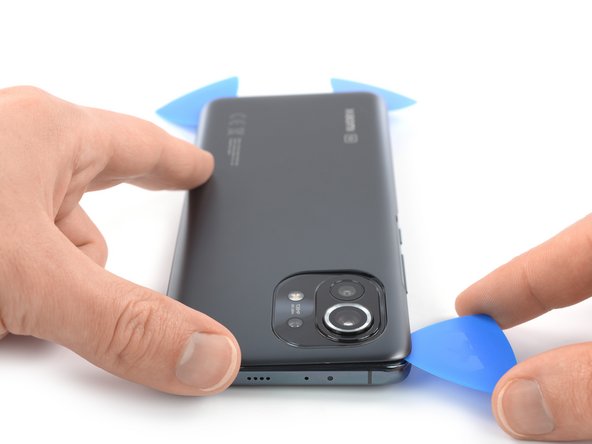

    3. Mi 11 Screen Replacement, Slice the adhesive: crwdns2935265:03crwdnd2935265:01crwdnd2935265:02crwdne2935265:0 Mi 11 Screen Replacement, Slice the adhesive: crwdns2935265:03crwdnd2935265:02crwdnd2935265:02crwdne2935265:0
      • Insert a second opening pick at the bottom edge of your phone.
      • Slide the opening pick to the bottom left corner to slice the adhesive.

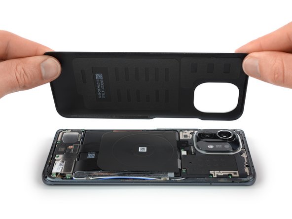

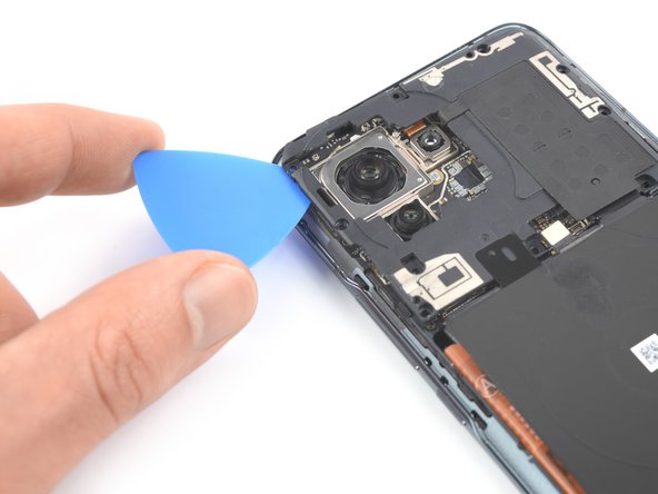

    7. Mi 11 Screen Replacement, Remove the rear glass: crwdns2935265:07crwdnd2935265:01crwdnd2935265:02crwdne2935265:0 Mi 11 Screen Replacement, Remove the rear glass: crwdns2935265:07crwdnd2935265:02crwdnd2935265:02crwdne2935265:0
      • Remove the rear glass.
      • Apply new adhesive where necessary after cleaning the relevant areas with isopropyl alcohol (>90%).
      • Secure the new rear glass with pre-cut adhesive or double-sided adhesive tape. After installing the rear glass, apply strong, steady pressure to your phone for several minutes to help the adhesive form a good bond—a stack of heavy books works well.

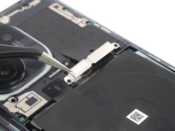

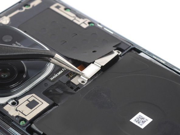

    2. Mi 11 Screen Replacement, Remove the metal bracket: crwdns2935265:09crwdnd2935265:01crwdnd2935265:03crwdne2935265:0 Mi 11 Screen Replacement, Remove the metal bracket: crwdns2935265:09crwdnd2935265:02crwdnd2935265:03crwdne2935265:0 Mi 11 Screen Replacement, Remove the metal bracket: crwdns2935265:09crwdnd2935265:03crwdnd2935265:03crwdne2935265:0
      • Use a pair of tweezers to remove the connector bracket by pulling it in the direction of the battery.

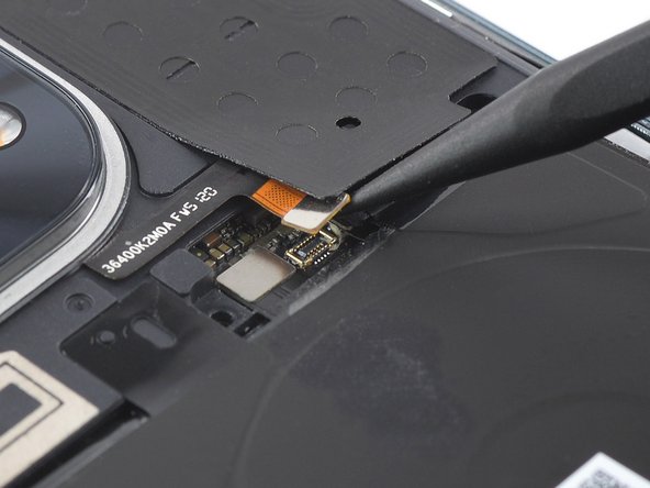

    3. Mi 11 Screen Replacement, Disconnect the flash assembly: crwdns2935265:010crwdnd2935265:01crwdnd2935265:02crwdne2935265:0 Mi 11 Screen Replacement, Disconnect the flash assembly: crwdns2935265:010crwdnd2935265:02crwdnd2935265:02crwdne2935265:0
      • Use the pointed end of a spudger to disconnect the flash assembly cable by prying the connector straight up from its socket.

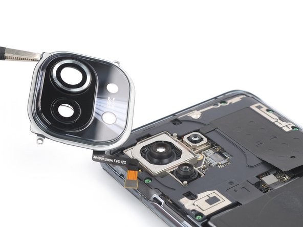

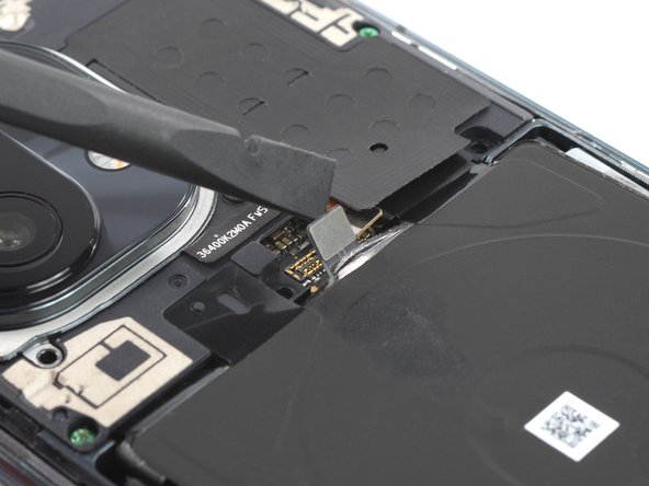

    5. Mi 11 Screen Replacement, Remove the camera cover: crwdns2935265:012crwdnd2935265:01crwdnd2935265:02crwdne2935265:0 Mi 11 Screen Replacement, Remove the camera cover: crwdns2935265:012crwdnd2935265:02crwdnd2935265:02crwdne2935265:0
      • Use your fingers or a pair of tweezers to carefully lift the camera cover including the flash assembly off the camera lenses and remove it.

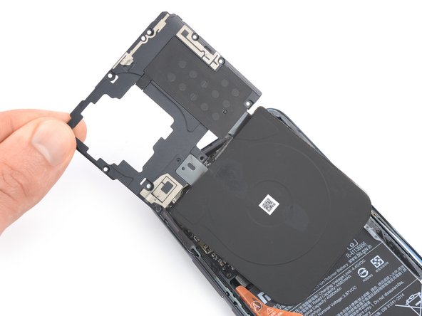

    6. Mi 11 Screen Replacement, Unfasten the motherboard cover screws: crwdns2935265:013crwdnd2935265:01crwdnd2935265:01crwdne2935265:0
      • Use a Phillips screwdriver to remove the five 3.9 mm-long screws securing the motherboard cover.
    7. Mi 11 Screen Replacement, Pry up the motherboard cover: crwdns2935265:014crwdnd2935265:01crwdnd2935265:02crwdne2935265:0 Mi 11 Screen Replacement, Pry up the motherboard cover: crwdns2935265:014crwdnd2935265:02crwdnd2935265:02crwdne2935265:0
      • Insert an opening pick underneath the bottom left edge of the motherboard cover.
      • Slide the opening pick along the left edge of the motherboard cover and pry it up.
    8. Mi 11 Screen Replacement, Remove the motherboard cover: crwdns2935265:015crwdnd2935265:01crwdnd2935265:02crwdne2935265:0 Mi 11 Screen Replacement, Remove the motherboard cover: crwdns2935265:015crwdnd2935265:02crwdnd2935265:02crwdne2935265:0
      • Remove the motherboard cover.

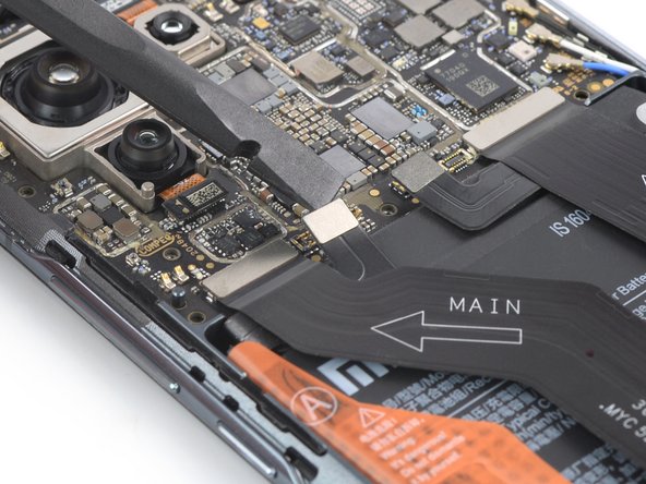

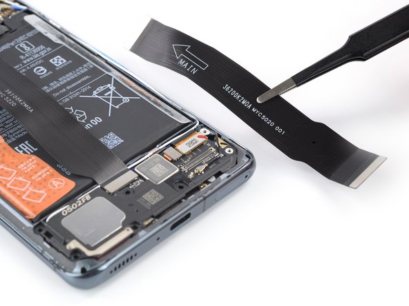

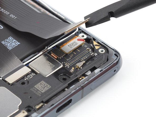

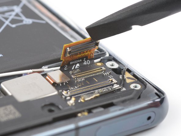

    1. Mi 11 Screen Replacement, Disconnect the right interconnect cable: crwdns2935265:017crwdnd2935265:01crwdnd2935265:02crwdne2935265:0 Mi 11 Screen Replacement, Disconnect the right interconnect cable: crwdns2935265:017crwdnd2935265:02crwdnd2935265:02crwdne2935265:0
      • Use a spudger to disconnect the right interconnect cable from the motherboard by prying the connector straight up from its socket.
    2. Mi 11 Screen Replacement, Remove the right interconnect cable: crwdns2935265:018crwdnd2935265:01crwdnd2935265:03crwdne2935265:0 Mi 11 Screen Replacement, Remove the right interconnect cable: crwdns2935265:018crwdnd2935265:02crwdnd2935265:03crwdne2935265:0 Mi 11 Screen Replacement, Remove the right interconnect cable: crwdns2935265:018crwdnd2935265:03crwdnd2935265:03crwdne2935265:0
      • Use a spudger to disconnect the right interconnect cable from the daughterboard by prying the connector straight up from its socket.
      • Remove the right interconnect cable.

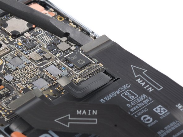

    3. Mi 11 Screen Replacement, Disconnect the display flex cable: crwdns2935265:019crwdnd2935265:01crwdnd2935265:02crwdne2935265:0 Mi 11 Screen Replacement, Disconnect the display flex cable: crwdns2935265:019crwdnd2935265:02crwdnd2935265:02crwdne2935265:0
      • Use a spudger to disconnect the display flex cable by prying the connector straight up from its socket.

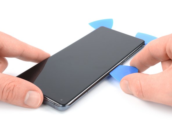

    4. Mi 11 Screen Replacement, Loosen the display adhesive: crwdns2935265:020crwdnd2935265:01crwdnd2935265:01crwdne2935265:0
      • Apply a heated iOpener or a heat gun to the screen for two minutes to loosen the adhesive underneath.

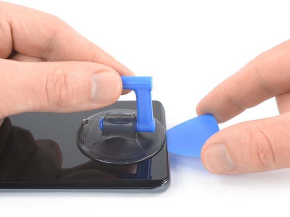

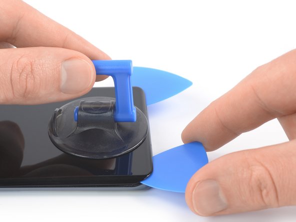

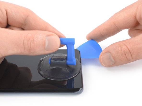

    5. Mi 11 Screen Replacement, Insert an opening pick: crwdns2935265:021crwdnd2935265:01crwdnd2935265:03crwdne2935265:0 Mi 11 Screen Replacement, Insert an opening pick: crwdns2935265:021crwdnd2935265:02crwdnd2935265:03crwdne2935265:0 Mi 11 Screen Replacement, Insert an opening pick: crwdns2935265:021crwdnd2935265:03crwdnd2935265:03crwdne2935265:0
      • Once the screen is warm to the touch, apply a suction cup to the bottom edge of the phone.
      • If your screen is badly cracked, covering it with a layer of clear packing tape may allow the suction cup to adhere. Alternatively, very strong tape may be used instead of the suction cup. If all else fails, you can superglue the suction cup to the screen.
      • Lift the screen with the suction handle to create a small gap between the screen and the frame.
      • Insert an opening pick in the gap between the midframe and the screen.
      • Slide the opening pick to the bottom right corner of the screen to slice its adhesive. Leave the opening pick in place to prevent the adhesive from resealing.
    6. Mi 11 Screen Replacement, Slice the adhesive: crwdns2935265:022crwdnd2935265:01crwdnd2935265:02crwdne2935265:0 Mi 11 Screen Replacement, Slice the adhesive: crwdns2935265:022crwdnd2935265:02crwdnd2935265:02crwdne2935265:0

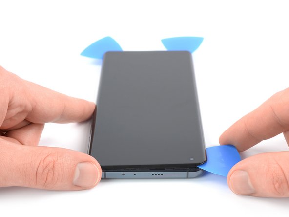

      • Insert a second opening pick and slide it to the bottom left corner of the screen to cut the adhesive.
      • Leave the opening picks in place to prevent the adhesive from resealing.
    7. Mi 11 Screen Replacement: crwdns2935265:023crwdnd2935265:01crwdnd2935265:03crwdne2935265:0 Mi 11 Screen Replacement: crwdns2935265:023crwdnd2935265:02crwdnd2935265:03crwdne2935265:0 Mi 11 Screen Replacement: crwdns2935265:023crwdnd2935265:03crwdnd2935265:03crwdne2935265:0
      • If the adhesive becomes hard to cut, it has most likely cooled down. Use your iOpener or heat gun to for 1-2 minutes to reheat it.

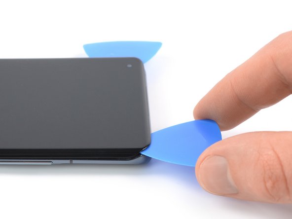

      • Insert a third opening pick underneath the bottom left corner of the screen.
      • Slide the opening pick along the left edge of the screen to slice the adhesive. Leave it in the top left corner to prevent the adhesive from resealing.

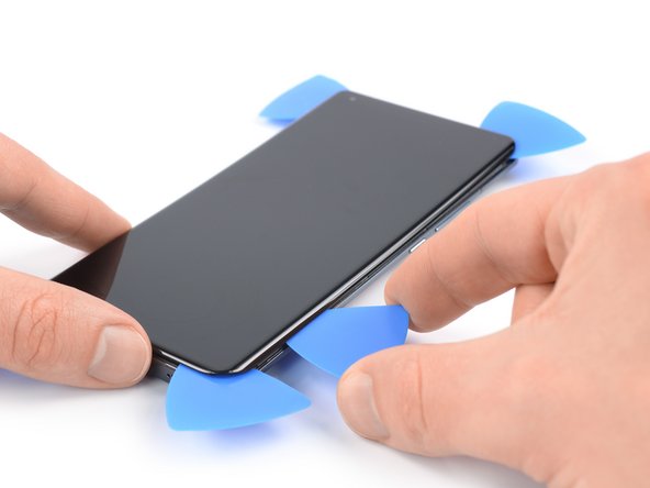

    8. Mi 11 Screen Replacement: crwdns2935265:024crwdnd2935265:01crwdnd2935265:02crwdne2935265:0 Mi 11 Screen Replacement: crwdns2935265:024crwdnd2935265:02crwdnd2935265:02crwdne2935265:0
      • When you slice near the front facing camera, insert only the tip of the opening pick to avoid damaging or smearing the camera.
      • Insert a fourth opening pick at the top left corner of the screen.
      • Slide the opening pick along the top edge of the phone to slice the adhesive.
      • Leave the opening pick in the top right corner of the screen to prevent the adhesive from resealing.
    9. Mi 11 Screen Replacement: crwdns2935265:025crwdnd2935265:01crwdnd2935265:02crwdne2935265:0 Mi 11 Screen Replacement: crwdns2935265:025crwdnd2935265:02crwdnd2935265:02crwdne2935265:0
      • Insert a fifth opening pick and slide it along the right edge of the phone to slice the remaining adhesive.
      • Do not try to remove the display all the way yet, the display cable is still threaded through the frame.

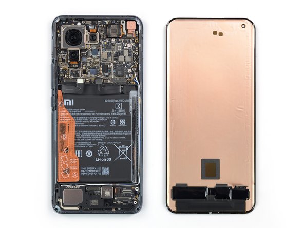

    10. Mi 11 Screen Replacement, Remove the screen: crwdns2935265:026crwdnd2935265:01crwdnd2935265:03crwdne2935265:0 Mi 11 Screen Replacement, Remove the screen: crwdns2935265:026crwdnd2935265:02crwdnd2935265:03crwdne2935265:0 Mi 11 Screen Replacement, Remove the screen: crwdns2935265:026crwdnd2935265:03crwdnd2935265:03crwdne2935265:0
      • Thread the display flex cable through the gap in the midframe and remove the screen.
      • Apply new adhesive where it's necessary after cleaning the relevant areas with isopropyl alcohol (>90%).
