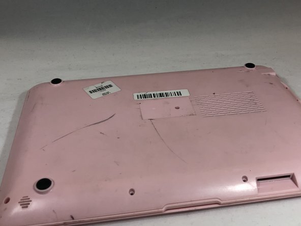

    • Place the netbook top down, with the opening of the netbook facing you.
  2. Maylong MN-1000P Bottom Cover Replacement: crwdns2935265:02crwdnd2935265:01crwdnd2935265:01crwdne2935265:0
    • Remove the six 6mm Phillips #00 screws from the netbook.

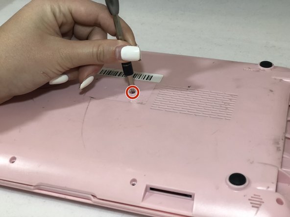

    • Remove the sticker in the middle of the netbook.
    • Remove the middle 6mm Phillips #00 screw.

    • Using two plastic opening tools, pry off the bottom of the netbook by going around the edges.
  5. Maylong MN-1000P Bottom Cover Replacement: crwdns2935265:05crwdnd2935265:01crwdnd2935265:01crwdne2935265:0
    • Remove the bottom of the netbook by lifting the corners.
