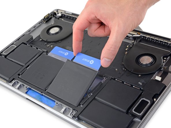

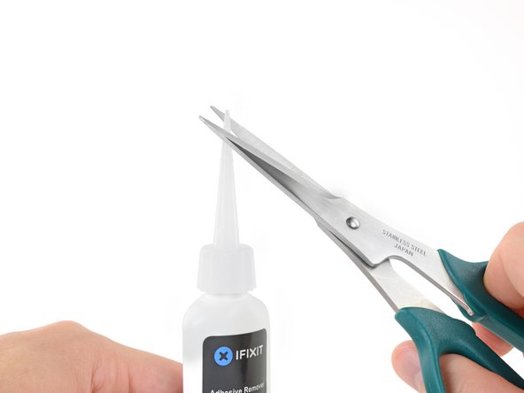

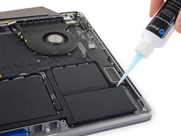

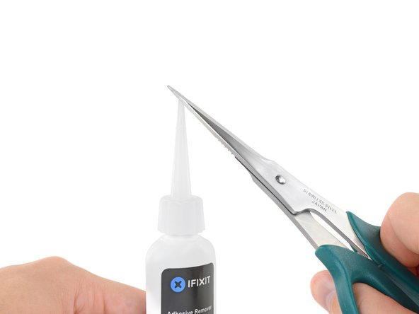

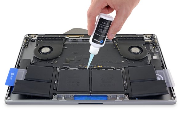

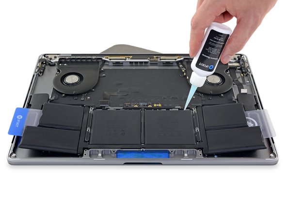

Use this guide to safely remove the glued-in battery from your 16” MacBook Pro with the help of an iFixit kit with adhesive remover. The adhesive remover is designed to weaken the glue securing the battery, allowing you to remove it with ease.
iFixit adhesive remover is flammable. Follow this procedure in a well-ventilated area. Do not smoke or work near an open flame.
To minimize risk of damage, turn on your MacBook and allow the battery to fully discharge before starting this procedure. A charged lithium-ion battery can create a dangerous and uncontrollable fire if accidentally punctured. If your battery looks puffy or swollen, take extra precautions.
After replacing the battery, reset SMC before performing the battery calibration procedure.
Note: The solvent used to dissolve the battery adhesive can damage certain plastics. Follow all instructions and take care where you apply the adhesive remover.

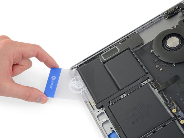

    2. MacBook Pro 16" 2019 Battery Replacement, Unclip lower case: crwdns2935265:03crwdnd2935265:01crwdnd2935265:02crwdne2935265:0 MacBook Pro 16" 2019 Battery Replacement, Unclip lower case: crwdns2935265:03crwdnd2935265:02crwdnd2935265:02crwdne2935265:0
      • Press a suction handle into place near the front edge of the lower case, between the screw holes.
      • Pull up on the suction handle just enough to open a small gap under the lower case.
    3. MacBook Pro 16" 2019 Battery Replacement: crwdns2935265:04crwdnd2935265:01crwdnd2935265:03crwdne2935265:0 MacBook Pro 16" 2019 Battery Replacement: crwdns2935265:04crwdnd2935265:02crwdnd2935265:03crwdne2935265:0 MacBook Pro 16" 2019 Battery Replacement: crwdns2935265:04crwdnd2935265:03crwdnd2935265:03crwdne2935265:0

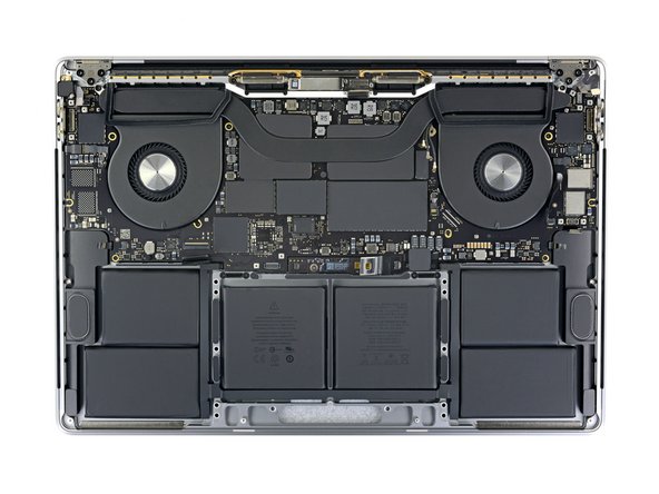

    7. MacBook Pro 16" 2019 Battery Replacement, Remove lower case: crwdns2935265:08crwdnd2935265:01crwdnd2935265:03crwdne2935265:0 MacBook Pro 16" 2019 Battery Replacement, Remove lower case: crwdns2935265:08crwdnd2935265:02crwdnd2935265:03crwdne2935265:0 MacBook Pro 16" 2019 Battery Replacement, Remove lower case: crwdns2935265:08crwdnd2935265:03crwdnd2935265:03crwdne2935265:0
      • Remove the lower case.
      • To reinstall the lower case:
      • Set it in place and align the sliding clips near the display hinge. Press down and slide the cover toward the hinge. It should stop sliding as the clips engage.
      • When the sliding clips are fully engaged and the lower case looks correctly aligned, press down firmly on the lower case to engage the four hidden clips underneath. You should feel and hear them snap into place.

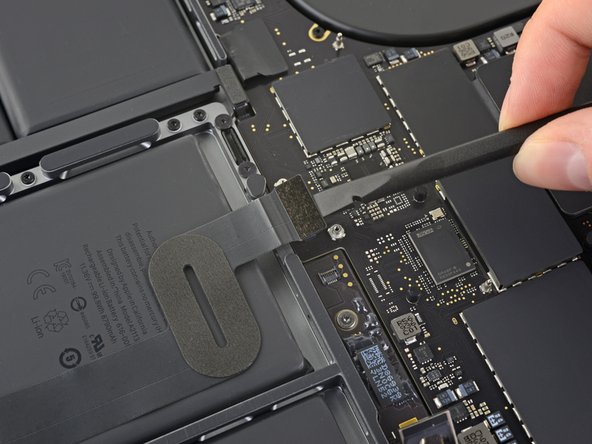

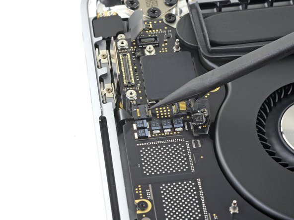

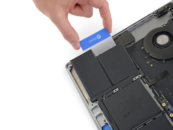

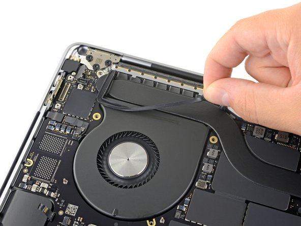

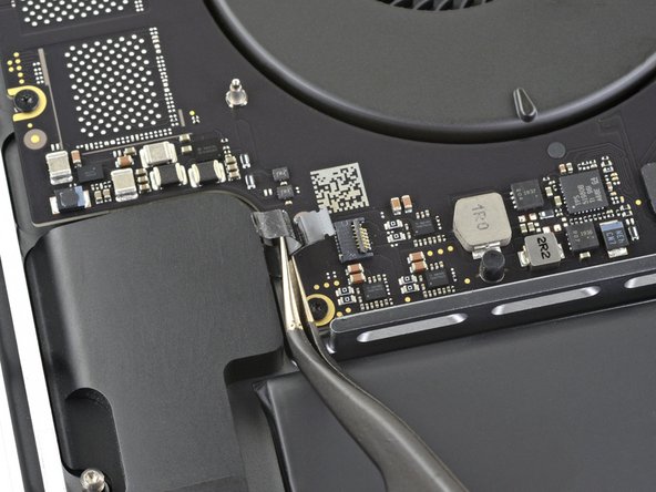

    1. MacBook Pro 16" 2019 Battery Replacement, Remove battery board sticker: crwdns2935265:09crwdnd2935265:01crwdnd2935265:01crwdne2935265:0
      • Peel up and remove the insulating sticker covering the battery board, on the edge of the logic board nearest the battery.
      • If the cover doesn't peel up easily, apply mild heat with an iOpener, hair dryer, or heat gun to soften the adhesive underneath, and try again.

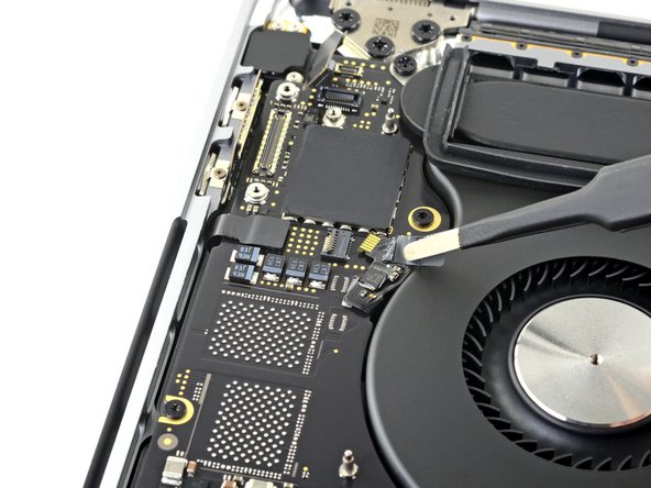

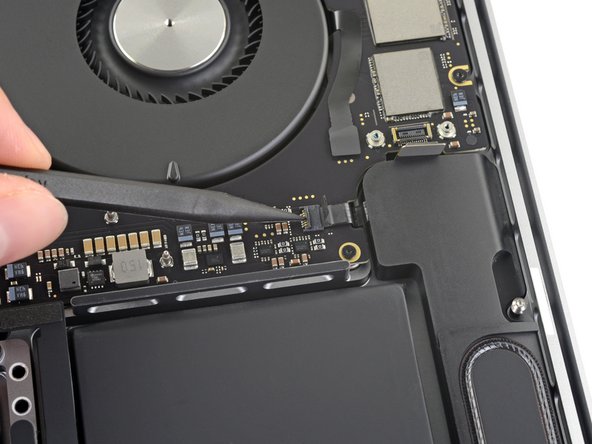

    2. MacBook Pro 16" 2019 Battery Replacement: crwdns2935265:010crwdnd2935265:01crwdnd2935265:02crwdne2935265:0 MacBook Pro 16" 2019 Battery Replacement: crwdns2935265:010crwdnd2935265:02crwdnd2935265:02crwdne2935265:0
      • Peel back any tape covering the battery board data cable connector.

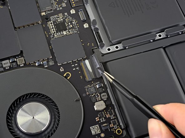

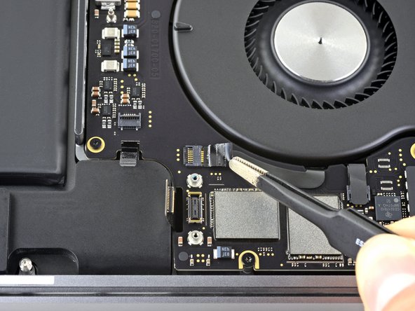

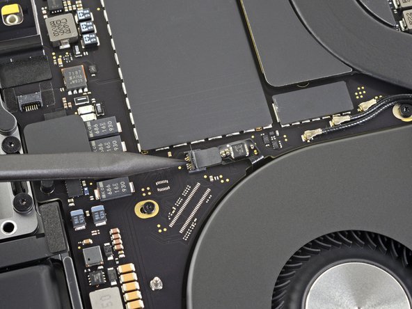

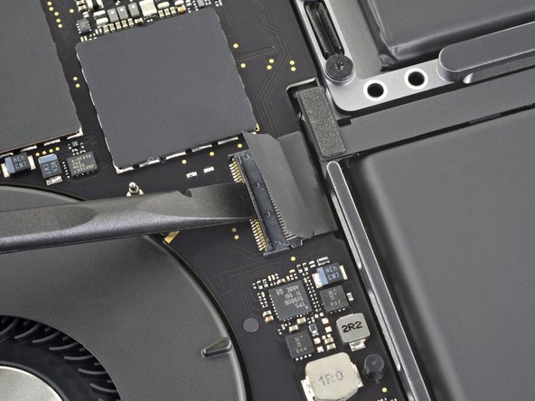

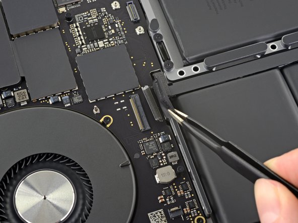

    3. MacBook Pro 16" 2019 Battery Replacement, Disconnect battery board data cable: crwdns2935265:011crwdnd2935265:01crwdnd2935265:02crwdne2935265:0 MacBook Pro 16" 2019 Battery Replacement, Disconnect battery board data cable: crwdns2935265:011crwdnd2935265:02crwdnd2935265:02crwdne2935265:0
      • Use a spudger to gently pry up the locking flap on the ZIF connector for the battery board data cable.

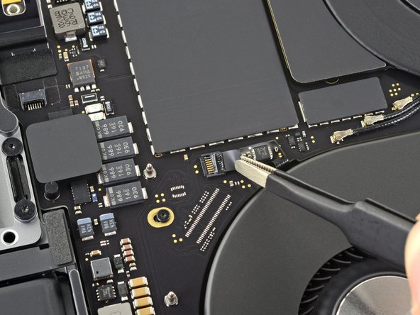

    4. MacBook Pro 16" 2019 Battery Replacement: crwdns2935265:012crwdnd2935265:01crwdnd2935265:02crwdne2935265:0 MacBook Pro 16" 2019 Battery Replacement: crwdns2935265:012crwdnd2935265:02crwdnd2935265:02crwdne2935265:0
      • Disconnect the battery board data cable by sliding it out from its socket on the logic board.
      • Slide parallel to the logic board. Don't pull up.

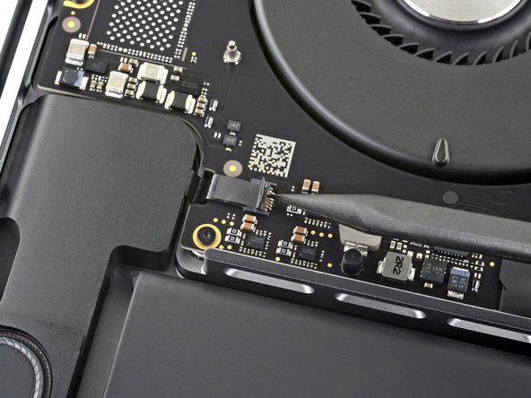

    5. MacBook Pro 16" 2019 Battery Replacement: crwdns2935265:013crwdnd2935265:01crwdnd2935265:02crwdne2935265:0 MacBook Pro 16" 2019 Battery Replacement: crwdns2935265:013crwdnd2935265:02crwdnd2935265:02crwdne2935265:0

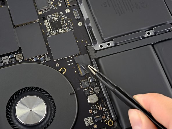

      • Pry up and disconnect the locking flap on the connector at the opposite end of the battery board data cable.

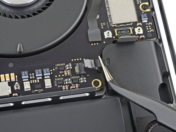

    6. MacBook Pro 16" 2019 Battery Replacement, Remove battery board data cable: crwdns2935265:014crwdnd2935265:01crwdnd2935265:02crwdne2935265:0 MacBook Pro 16" 2019 Battery Replacement, Remove battery board data cable: crwdns2935265:014crwdnd2935265:02crwdnd2935265:02crwdne2935265:0
      • Slide the battery board data cable out of its socket on the battery board, and remove it completely.
      • Take care not to reinstall this cable backwards or upside-down.

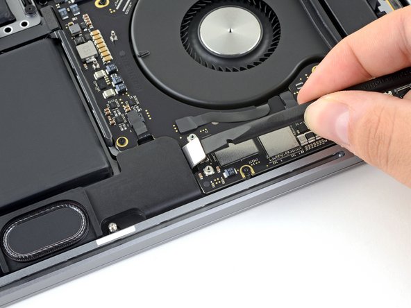

    7. MacBook Pro 16" 2019 Battery Replacement, Disconnect the battery: crwdns2935265:015crwdnd2935265:01crwdnd2935265:02crwdne2935265:0 MacBook Pro 16" 2019 Battery Replacement, Disconnect the battery: crwdns2935265:015crwdnd2935265:02crwdnd2935265:02crwdne2935265:0
      • Use a T5 Torx driver to remove the 6.7 mm pancake screw securing the battery power connector.
    8. MacBook Pro 16" 2019 Battery Replacement: crwdns2935265:016crwdnd2935265:01crwdnd2935265:02crwdne2935265:0 MacBook Pro 16" 2019 Battery Replacement: crwdns2935265:016crwdnd2935265:02crwdnd2935265:02crwdne2935265:0
      • Use a spudger to lift the battery power connector, disconnecting the battery.
      • Lift the connector high enough to keep it separated from its socket while you work. If it accidentally makes contact, it could damage your MacBook Pro.

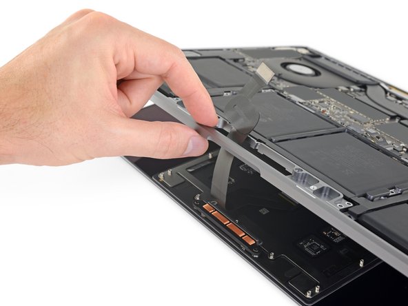

    2. MacBook Pro 16" 2019 Battery Replacement, Disconnect trackpad cable: crwdns2935265:018crwdnd2935265:01crwdnd2935265:02crwdne2935265:0 MacBook Pro 16" 2019 Battery Replacement, Disconnect trackpad cable: crwdns2935265:018crwdnd2935265:02crwdnd2935265:02crwdne2935265:0
      • Use a spudger to disconnect the trackpad cable by prying its connector straight up from the logic board.
    3. MacBook Pro 16" 2019 Battery Replacement: crwdns2935265:019crwdnd2935265:01crwdnd2935265:01crwdne2935265:0

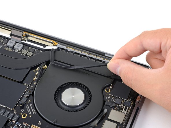

      • Apply mild heat to the trackpad ribbon cable to soften the adhesive securing it to the battery.
      • You can use an iOpener, hair dryer, or heat gun, but be careful not to overheat the battery. The cable should be warm, but not too hot to touch.
    4. MacBook Pro 16" 2019 Battery Replacement: crwdns2935265:020crwdnd2935265:01crwdnd2935265:03crwdne2935265:0 MacBook Pro 16" 2019 Battery Replacement: crwdns2935265:020crwdnd2935265:02crwdnd2935265:03crwdne2935265:0 MacBook Pro 16" 2019 Battery Replacement: crwdns2935265:020crwdnd2935265:03crwdnd2935265:03crwdne2935265:0
      • Carefully peel the trackpad cable up off the battery, and push it out of the way.
      • Don't crease or tear the cable. If you have trouble, don't force it—apply more heat and try again.

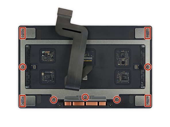

    5. MacBook Pro 16" 2019 Battery Replacement, Remove the trackpad assembly screws: crwdns2935265:021crwdnd2935265:01crwdnd2935265:02crwdne2935265:0 MacBook Pro 16" 2019 Battery Replacement, Remove the trackpad assembly screws: crwdns2935265:021crwdnd2935265:02crwdnd2935265:02crwdne2935265:0
      • Use a T5 Torx driver to remove the 13 screws securing the trackpad assembly:
      • Nine 5.8 mm screws
      • Four 4.9 mm screws
      • These screws all look similar—be careful not to mix them up.
      • Adding a little blue threadlocker to the screw threads during reassembly can help prevent the screws from working themselves loose over time.
      • Install the screws loosely at first, and then check the trackpad alignment before tightening them down.

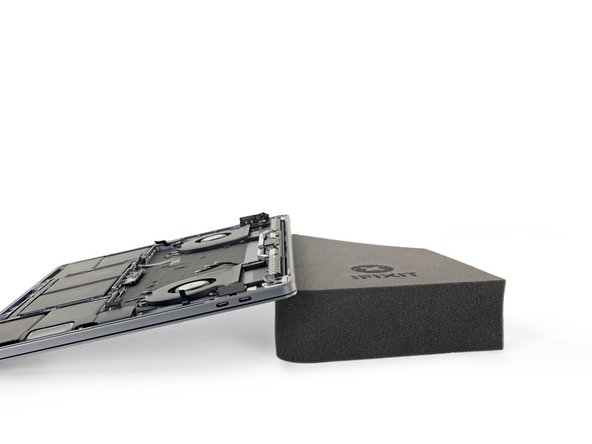

    6. MacBook Pro 16" 2019 Battery Replacement, Remove the trackpad: crwdns2935265:022crwdnd2935265:01crwdnd2935265:03crwdne2935265:0 MacBook Pro 16" 2019 Battery Replacement, Remove the trackpad: crwdns2935265:022crwdnd2935265:02crwdnd2935265:03crwdne2935265:0 MacBook Pro 16" 2019 Battery Replacement, Remove the trackpad: crwdns2935265:022crwdnd2935265:03crwdnd2935265:03crwdne2935265:0
      • Swing the display open slightly, but keep the MacBook upside-down. The trackpad assembly should separate and lay flat on the display.
      • Carefully feed the trackpad's ribbon cable through its slot in the chassis.
    7. MacBook Pro 16" 2019 Battery Replacement: crwdns2935265:023crwdnd2935265:01crwdnd2935265:03crwdne2935265:0 MacBook Pro 16" 2019 Battery Replacement: crwdns2935265:023crwdnd2935265:02crwdnd2935265:03crwdne2935265:0 MacBook Pro 16" 2019 Battery Replacement: crwdns2935265:023crwdnd2935265:03crwdnd2935265:03crwdne2935265:0
      • As you remove the trackpad assembly, be very careful not to lose the nine small metal washers resting on the screw posts. (They will fly off and get lost with very little provocation.)
      • Remove the trackpad assembly.

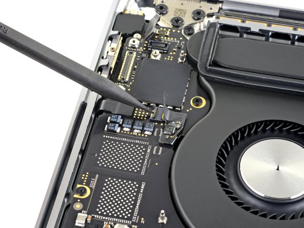

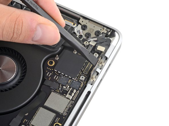

    1. MacBook Pro 16" 2019 Battery Replacement, Disconnect the display board: crwdns2935265:024crwdnd2935265:01crwdnd2935265:02crwdne2935265:0 MacBook Pro 16" 2019 Battery Replacement, Disconnect the display board: crwdns2935265:024crwdnd2935265:02crwdnd2935265:02crwdne2935265:0
      • Use a T3 Torx driver to remove the two 3.5 mm screws securing the cover on the display board flex cable.
      • Remove the display board flex cover.
    2. MacBook Pro 16" 2019 Battery Replacement: crwdns2935265:025crwdnd2935265:01crwdnd2935265:02crwdne2935265:0 MacBook Pro 16" 2019 Battery Replacement: crwdns2935265:025crwdnd2935265:02crwdnd2935265:02crwdne2935265:0
      • Using a T3 Torx driver, remove the two 1.6 mm screws securing the bracket for the display board cable connector.
      • Remove the display board cable connector bracket.
    3. MacBook Pro 16" 2019 Battery Replacement: crwdns2935265:026crwdnd2935265:01crwdnd2935265:02crwdne2935265:0 MacBook Pro 16" 2019 Battery Replacement: crwdns2935265:026crwdnd2935265:02crwdnd2935265:02crwdne2935265:0
      • Pry the display board flex cable straight up from its socket to disconnect it from the display board.

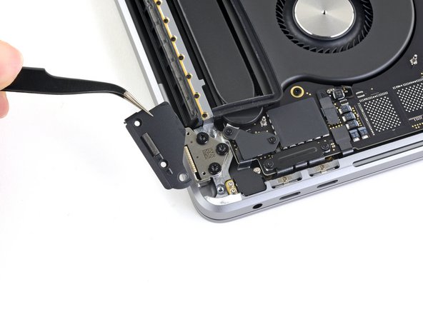

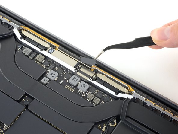

    4. MacBook Pro 16" 2019 Battery Replacement, Remove the hinge covers: crwdns2935265:027crwdnd2935265:01crwdnd2935265:02crwdne2935265:0 MacBook Pro 16" 2019 Battery Replacement, Remove the hinge covers: crwdns2935265:027crwdnd2935265:02crwdnd2935265:02crwdne2935265:0
      • Use a T3 Torx driver to remove the four 2.0 mm screws from the hinge covers (two screws on each side).
    5. MacBook Pro 16" 2019 Battery Replacement: crwdns2935265:028crwdnd2935265:01crwdnd2935265:03crwdne2935265:0 MacBook Pro 16" 2019 Battery Replacement: crwdns2935265:028crwdnd2935265:02crwdnd2935265:03crwdne2935265:0 MacBook Pro 16" 2019 Battery Replacement: crwdns2935265:028crwdnd2935265:03crwdnd2935265:03crwdne2935265:0
      • Remove the two hinge covers.

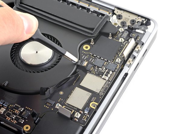

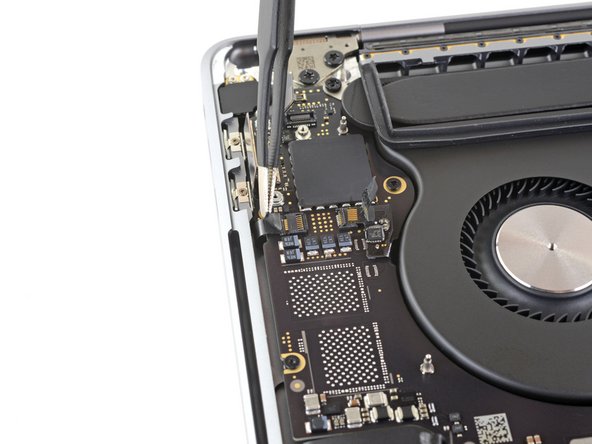

    6. MacBook Pro 16" 2019 Battery Replacement, Disconnect Touch ID and headphone jack cable connectors: crwdns2935265:029crwdnd2935265:01crwdnd2935265:02crwdne2935265:0 MacBook Pro 16" 2019 Battery Replacement, Disconnect Touch ID and headphone jack cable connectors: crwdns2935265:029crwdnd2935265:02crwdnd2935265:02crwdne2935265:0
      • Use a T3 Torx driver to remove the two 2.4 mm screws securing the cover bracket for the Touch ID and headphone jack cable connectors.
      • Remove the bracket.

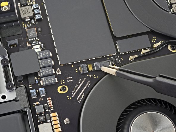

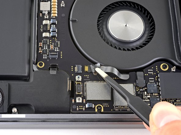

    7. MacBook Pro 16" 2019 Battery Replacement: crwdns2935265:030crwdnd2935265:01crwdnd2935265:02crwdne2935265:0 MacBook Pro 16" 2019 Battery Replacement: crwdns2935265:030crwdnd2935265:02crwdnd2935265:02crwdne2935265:0
      • Disconnect the headphone jack flex connector by prying it straight up from the logic board.
    8. MacBook Pro 16" 2019 Battery Replacement: crwdns2935265:031crwdnd2935265:01crwdnd2935265:02crwdne2935265:0 MacBook Pro 16" 2019 Battery Replacement: crwdns2935265:031crwdnd2935265:02crwdnd2935265:02crwdne2935265:0
      • Disconnect the power button and Touch ID sensor by prying its connector straight up from the logic board.
      • These two small connectors have a tendency to get caught underneath the logic board during reinstallation, so double check they're correctly positioned before screwing down the logic board.

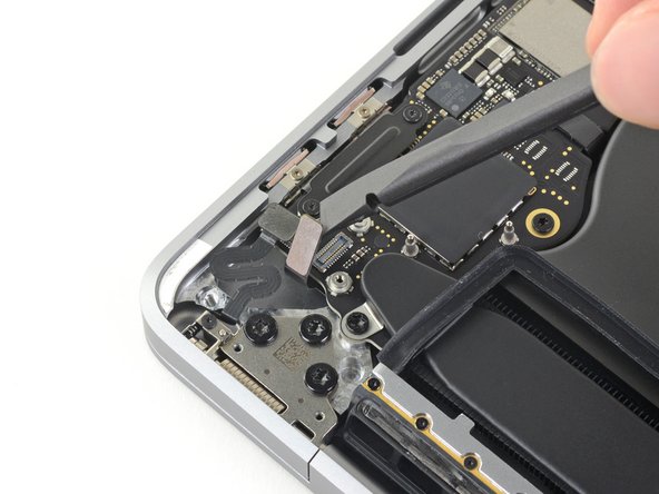

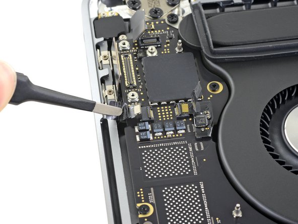

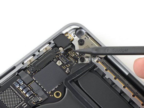

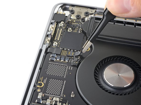

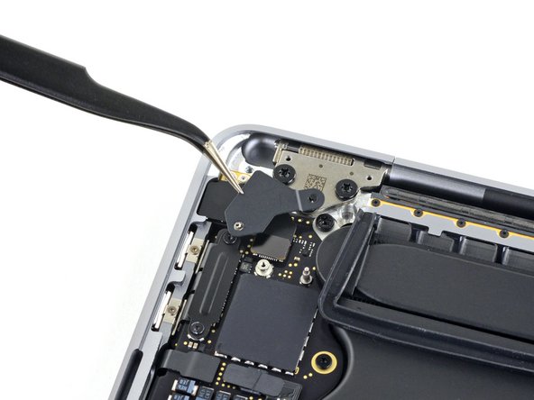

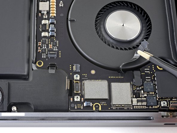

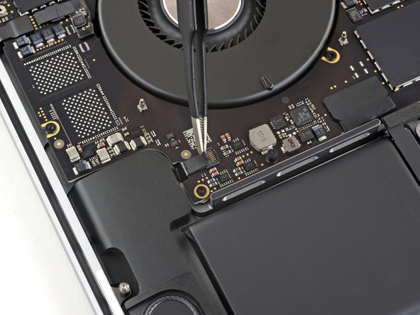

    9. MacBook Pro 16" 2019 Battery Replacement, Disconnect Touch Bar and lid angle sensor connectors: crwdns2935265:032crwdnd2935265:01crwdnd2935265:01crwdne2935265:0
      • Rotate your laptop so the lid angle sensor tear the top right corner is facing you.
      • Using a T3 Torx driver, remove the two 1.5 mm screws securing the cover bracket for the Touch Bar digitizer and lid angle sensor connectors.
    10. MacBook Pro 16" 2019 Battery Replacement: crwdns2935265:033crwdnd2935265:01crwdnd2935265:03crwdne2935265:0 MacBook Pro 16" 2019 Battery Replacement: crwdns2935265:033crwdnd2935265:02crwdnd2935265:03crwdne2935265:0 MacBook Pro 16" 2019 Battery Replacement: crwdns2935265:033crwdnd2935265:03crwdnd2935265:03crwdne2935265:0
      • Using your tweezers, slide the bracket toward the side edge of the MacBook Pro until it clears the slotted retaining tab on the logic board.

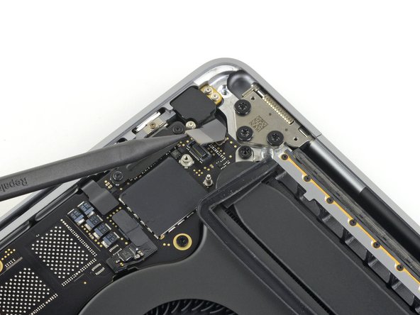

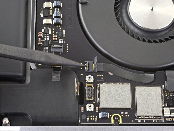

    11. MacBook Pro 16" 2019 Battery Replacement: crwdns2935265:034crwdnd2935265:01crwdnd2935265:03crwdne2935265:0 MacBook Pro 16" 2019 Battery Replacement: crwdns2935265:034crwdnd2935265:02crwdnd2935265:03crwdne2935265:0 MacBook Pro 16" 2019 Battery Replacement: crwdns2935265:034crwdnd2935265:03crwdnd2935265:03crwdne2935265:0
      • Disconnect the lid angle sensor cable by prying it straight up from the logic board.
      • Disconnect the Touch Bar digitizer cable by prying it straight up from the logic board.

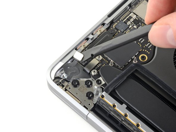

    12. MacBook Pro 16" 2019 Battery Replacement, Disconnect the Touch Bar display connector: crwdns2935265:035crwdnd2935265:01crwdnd2935265:02crwdne2935265:0 MacBook Pro 16" 2019 Battery Replacement, Disconnect the Touch Bar display connector: crwdns2935265:035crwdnd2935265:02crwdnd2935265:02crwdne2935265:0
      • Use a T3 Torx driver to remove the two 1.9 mm screws securing the bracket for the Touch Bar display cable connector.
    13. MacBook Pro 16" 2019 Battery Replacement: crwdns2935265:036crwdnd2935265:01crwdnd2935265:02crwdne2935265:0 MacBook Pro 16" 2019 Battery Replacement: crwdns2935265:036crwdnd2935265:02crwdnd2935265:02crwdne2935265:0
      • Disconnect the Touch Bar display cable by prying its connector straight up from the logic board.

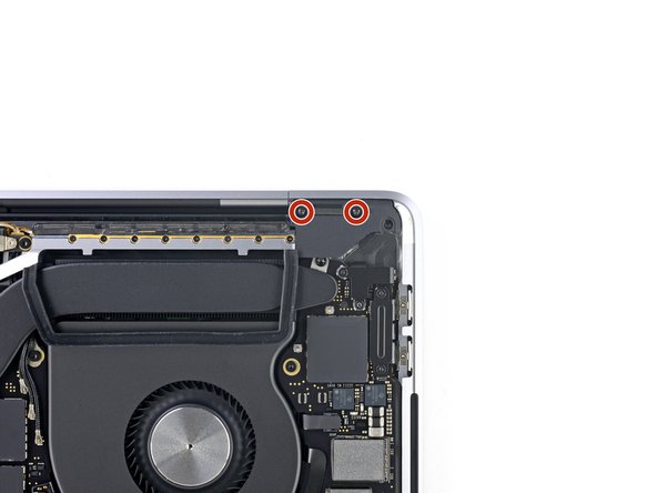

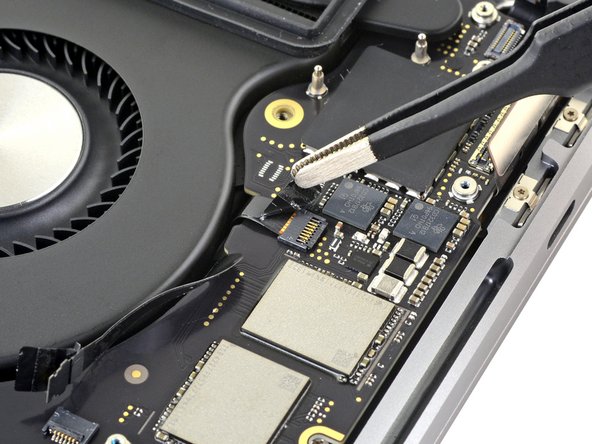

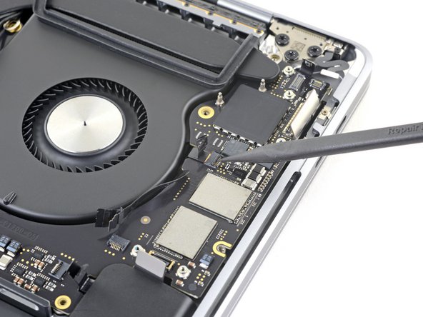

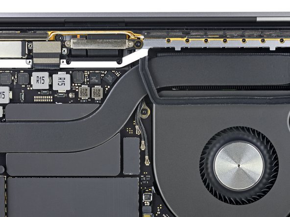

    14. MacBook Pro 16" 2019 Battery Replacement, Disconnect the Thunderbolt cables: crwdns2935265:037crwdnd2935265:01crwdnd2935265:02crwdne2935265:0 MacBook Pro 16" 2019 Battery Replacement, Disconnect the Thunderbolt cables: crwdns2935265:037crwdnd2935265:02crwdnd2935265:02crwdne2935265:0
      • Using a T3 Torx Driver:
      • Remove the two 1.3 mm screws securing the Thunderbolt flex cable cover on the left.
      • Remove two more 1.3 mm screws from the Thunderbolt cable cover on the right.
    15. MacBook Pro 16" 2019 Battery Replacement: crwdns2935265:038crwdnd2935265:01crwdnd2935265:02crwdne2935265:0 MacBook Pro 16" 2019 Battery Replacement: crwdns2935265:038crwdnd2935265:02crwdnd2935265:02crwdne2935265:0
      • Remove the cover brackets from both Thunderbolt cable sockets.
    16. MacBook Pro 16" 2019 Battery Replacement: crwdns2935265:039crwdnd2935265:01crwdnd2935265:03crwdne2935265:0 MacBook Pro 16" 2019 Battery Replacement: crwdns2935265:039crwdnd2935265:02crwdnd2935265:03crwdne2935265:0 MacBook Pro 16" 2019 Battery Replacement: crwdns2935265:039crwdnd2935265:03crwdnd2935265:03crwdne2935265:0
      • Use a spudger to disconnect the left-side Thunderbolt flex cable by prying it straight up from the logic board.
      • Pry from the inside edge, nearest the fan.
      • Gently push the flex cable connector off to the side so it doesn't interfere with logic board removal.
    17. MacBook Pro 16" 2019 Battery Replacement: crwdns2935265:040crwdnd2935265:01crwdnd2935265:02crwdne2935265:0 MacBook Pro 16" 2019 Battery Replacement: crwdns2935265:040crwdnd2935265:02crwdnd2935265:02crwdne2935265:0
      • Repeat to disconnect the Thunderbolt flex cable connector on the opposite side.
      • Carefully push the flex cable connector aside so there's clearance for the logic board to come out without snagging.
    18. MacBook Pro 16" 2019 Battery Replacement, Disconnect the keyboard cable: crwdns2935265:041crwdnd2935265:01crwdnd2935265:03crwdne2935265:0 MacBook Pro 16" 2019 Battery Replacement, Disconnect the keyboard cable: crwdns2935265:041crwdnd2935265:02crwdnd2935265:03crwdne2935265:0 MacBook Pro 16" 2019 Battery Replacement, Disconnect the keyboard cable: crwdns2935265:041crwdnd2935265:03crwdnd2935265:03crwdne2935265:0
      • Peel back the tape covering the keyboard cable connector.
    19. MacBook Pro 16" 2019 Battery Replacement: crwdns2935265:042crwdnd2935265:01crwdnd2935265:02crwdne2935265:0 MacBook Pro 16" 2019 Battery Replacement: crwdns2935265:042crwdnd2935265:02crwdnd2935265:02crwdne2935265:0
      • Use a spudger to gently pry straight up on the long locking flap on the ZIF connector for the keyboard cable.
      • Because this ZIF connector is so long, the locking flap is fragile. Be careful and pry up slowly and in the middle so it doesn't snap.
    20. MacBook Pro 16" 2019 Battery Replacement: crwdns2935265:043crwdnd2935265:01crwdnd2935265:02crwdne2935265:0 MacBook Pro 16" 2019 Battery Replacement: crwdns2935265:043crwdnd2935265:02crwdnd2935265:02crwdne2935265:0
      • Disconnect the keyboard cable by sliding it out from its socket on the logic board.
      • Pull in the direction of the cable.
      • If possible, pull on the tape attached to the cable, rather than the cable itself, to reduce the risk of damage.

      • Peel back any tape covering the left speaker cable connector.
    22. MacBook Pro 16" 2019 Battery Replacement: crwdns2935265:045crwdnd2935265:01crwdnd2935265:02crwdne2935265:0 MacBook Pro 16" 2019 Battery Replacement: crwdns2935265:045crwdnd2935265:02crwdnd2935265:02crwdne2935265:0
      • Open the locking flap on the left speaker cable's ZIF connector by prying it straight up from the logic board.
    23. MacBook Pro 16" 2019 Battery Replacement: crwdns2935265:046crwdnd2935265:01crwdnd2935265:02crwdne2935265:0 MacBook Pro 16" 2019 Battery Replacement: crwdns2935265:046crwdnd2935265:02crwdnd2935265:02crwdne2935265:0
      • Disconnect the left speaker by pulling its cable away from the logic board until it releases from its socket.

      • Move the cable away from its connector so it can more easily clear the logic board during removal.
    30. MacBook Pro 16" 2019 Battery Replacement, Disconnect the right fan: crwdns2935265:053crwdnd2935265:01crwdnd2935265:02crwdne2935265:0 MacBook Pro 16" 2019 Battery Replacement, Disconnect the right fan: crwdns2935265:053crwdnd2935265:02crwdnd2935265:02crwdne2935265:0
      • Peel back any tape covering the right fan connector.
    31. MacBook Pro 16" 2019 Battery Replacement: crwdns2935265:054crwdnd2935265:01crwdnd2935265:03crwdne2935265:0 MacBook Pro 16" 2019 Battery Replacement: crwdns2935265:054crwdnd2935265:02crwdnd2935265:03crwdne2935265:0 MacBook Pro 16" 2019 Battery Replacement: crwdns2935265:054crwdnd2935265:03crwdnd2935265:03crwdne2935265:0
      • Open the locking flap on the right fan's ZIF connector by prying it straight up from the logic board.
      • Disconnect the right fan by pulling its cable away from the logic board until it releases from its socket.
    32. MacBook Pro 16" 2019 Battery Replacement, Disconnect the left fan: crwdns2935265:055crwdnd2935265:01crwdnd2935265:02crwdne2935265:0 MacBook Pro 16" 2019 Battery Replacement, Disconnect the left fan: crwdns2935265:055crwdnd2935265:02crwdnd2935265:02crwdne2935265:0
      • Peel back any tape covering the left fan connector.
    33. MacBook Pro 16" 2019 Battery Replacement: crwdns2935265:056crwdnd2935265:01crwdnd2935265:03crwdne2935265:0 MacBook Pro 16" 2019 Battery Replacement: crwdns2935265:056crwdnd2935265:02crwdnd2935265:03crwdne2935265:0 MacBook Pro 16" 2019 Battery Replacement: crwdns2935265:056crwdnd2935265:03crwdnd2935265:03crwdne2935265:0
      • Open the locking flap on the left fan's ZIF connector by prying it straight up from the logic board.
      • Disconnect the left fan by pulling its cable away from the logic board until it releases from its socket.

    36. MacBook Pro 16" 2019 Battery Replacement, Disconnect the microphone array: crwdns2935265:059crwdnd2935265:01crwdnd2935265:02crwdne2935265:0 MacBook Pro 16" 2019 Battery Replacement, Disconnect the microphone array: crwdns2935265:059crwdnd2935265:02crwdnd2935265:02crwdne2935265:0
      • Peel back any tape covering the microphone array connector.
    37. MacBook Pro 16" 2019 Battery Replacement: crwdns2935265:060crwdnd2935265:01crwdnd2935265:03crwdne2935265:0 MacBook Pro 16" 2019 Battery Replacement: crwdns2935265:060crwdnd2935265:02crwdnd2935265:03crwdne2935265:0 MacBook Pro 16" 2019 Battery Replacement: crwdns2935265:060crwdnd2935265:03crwdnd2935265:03crwdne2935265:0
      • Open the locking flap on the microphone array's ZIF connector by prying it straight up from the logic board.
      • Disconnect the microphone array by pulling its cable away from the logic board until it releases from its socket.
    38. MacBook Pro 16" 2019 Battery Replacement, Disconnect the antenna bundle: crwdns2935265:061crwdnd2935265:01crwdnd2935265:02crwdne2935265:0 MacBook Pro 16" 2019 Battery Replacement, Disconnect the antenna bundle: crwdns2935265:061crwdnd2935265:02crwdnd2935265:02crwdne2935265:0
      • Use a T5 Torx driver to remove the single 2.9 mm screw securing the antenna cable bundle.
    39. MacBook Pro 16" 2019 Battery Replacement: crwdns2935265:062crwdnd2935265:01crwdnd2935265:02crwdne2935265:0 MacBook Pro 16" 2019 Battery Replacement: crwdns2935265:062crwdnd2935265:02crwdnd2935265:02crwdne2935265:0

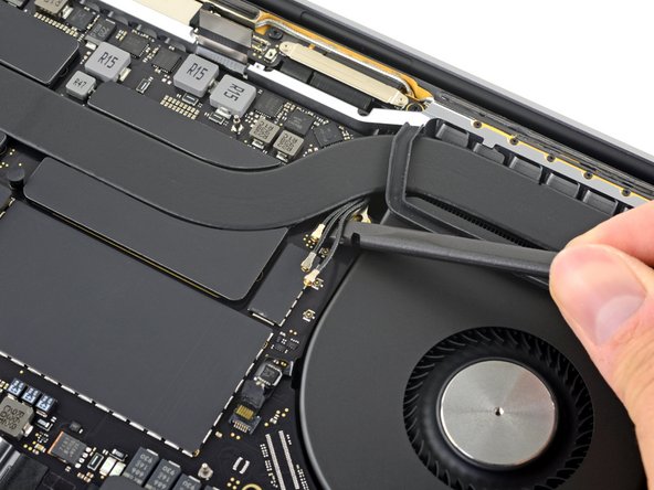

      • Disconnect all three antenna cables by prying each one straight up from its socket.
      • Slide your tweezers or the flat end of your spudger underneath each cable until it's near the socket, and then gently twist or pry up to disconnect it.
      • To reconnect each cable, align the connector directly over its socket, and then press down so it snaps into place.

    41. MacBook Pro 16" 2019 Battery Replacement, Remove the logic board: crwdns2935265:064crwdnd2935265:01crwdnd2935265:03crwdne2935265:0 MacBook Pro 16" 2019 Battery Replacement, Remove the logic board: crwdns2935265:064crwdnd2935265:02crwdnd2935265:03crwdne2935265:0 MacBook Pro 16" 2019 Battery Replacement, Remove the logic board: crwdns2935265:064crwdnd2935265:03crwdnd2935265:03crwdne2935265:0
      • Peel up (but don't remove) the rubber vibration damping strip from the adhesive holding it to the fan.
      • If needed, apply mild heat with an iOpener, hair dryer, or heat gun to soften the adhesive and make the dampers easier to separate.
      • Repeat for the other adhesive strip on the opposite fan.

    1. MacBook Pro 16" 2019 Battery Replacement, Battery: crwdns2935265:068crwdnd2935265:01crwdnd2935265:01crwdne2935265:0
      • Use a T5 Torx driver to remove the 5.1 mm screw securing the battery board.

    3. MacBook Pro 16" 2019 Battery Replacement: crwdns2935265:070crwdnd2935265:01crwdnd2935265:02crwdne2935265:0 MacBook Pro 16" 2019 Battery Replacement: crwdns2935265:070crwdnd2935265:02crwdnd2935265:02crwdne2935265:0
      • To control the flow of adhesive remover, raise the back edge (hinge side) of your MacBook Pro a few inches using a book or foam block.

    5. MacBook Pro 16" 2019 Battery Replacement: crwdns2935265:072crwdnd2935265:01crwdnd2935265:03crwdne2935265:0 MacBook Pro 16" 2019 Battery Replacement: crwdns2935265:072crwdnd2935265:02crwdnd2935265:03crwdne2935265:0 MacBook Pro 16" 2019 Battery Replacement: crwdns2935265:072crwdnd2935265:03crwdnd2935265:03crwdne2935265:0
      • Pull off the black rubber stopper from your bottle of adhesive remover.
      • Twist to loosen or remove the bottle cap before you cut the applicator tip.
      • This unseals the bottle and allows the pressure to equalize before you cut the applicator tip. If you skip this step, the adhesive remover may spray out unexpectedly when the tip is cut.
      • Use scissors to cut off the sealed tip of the applicator.
      • Cutting close to the narrow tip will give you better control so you can apply the adhesive remover in small amounts.
      • Twist and close the bottle cap securely before you proceed further.
    6. MacBook Pro 16" 2019 Battery Replacement: crwdns2935265:073crwdnd2935265:01crwdnd2935265:02crwdne2935265:0 MacBook Pro 16" 2019 Battery Replacement: crwdns2935265:073crwdnd2935265:02crwdnd2935265:02crwdne2935265:0

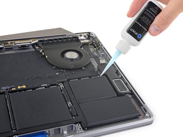

      • Apply a few drops of adhesive remover underneath the two battery cells on the right, starting along the edge nearest the fan.
      • You don't need to use very much. The small bottle contains more than twice the amount of solvent needed to remove all the battery cells.
    7. MacBook Pro 16" 2019 Battery Replacement: crwdns2935265:074crwdnd2935265:01crwdnd2935265:02crwdne2935265:0 MacBook Pro 16" 2019 Battery Replacement: crwdns2935265:074crwdnd2935265:02crwdnd2935265:02crwdne2935265:0
      • Add a few more drops of adhesive remover in between the two battery cells on the right, so that it flows down underneath the lower battery cell.
      • Wait about two minutes for the liquid adhesive remover to penetrate and weaken the battery adhesive before you proceed to the next step.

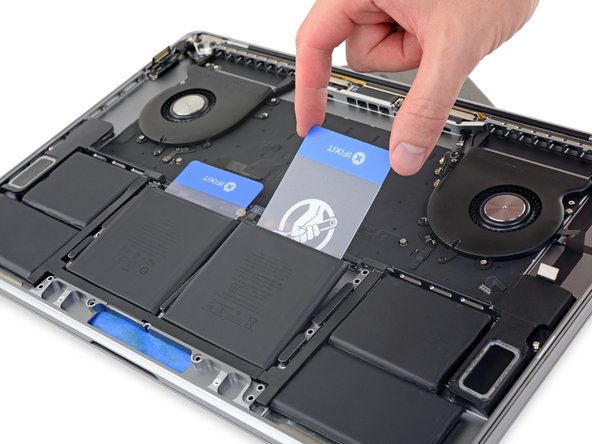

    8. MacBook Pro 16" 2019 Battery Replacement: crwdns2935265:075crwdnd2935265:01crwdnd2935265:03crwdne2935265:0 MacBook Pro 16" 2019 Battery Replacement: crwdns2935265:075crwdnd2935265:02crwdnd2935265:03crwdne2935265:0 MacBook Pro 16" 2019 Battery Replacement: crwdns2935265:075crwdnd2935265:03crwdnd2935265:03crwdne2935265:0
      Plastic Cards
      $2.99
      • After a couple minutes, insert one corner of a plastic card underneath the battery, starting from the lower edge of the bottom, right-most cell.
      • This shouldn't require much force. If you have trouble, apply more adhesive remover and give it 2-3 additional minutes to penetrate.
      • Try not to deform the battery. A damaged or punctured battery can leak dangerous chemicals and/or catch fire.
      • Wiggle the card from side to side and slide it all the way underneath both battery cells.
      • Lift the cells to fully separate the adhesive, but don't try to remove them from your MacBook yet.
      • Leave the plastic card temporarily underneath the cells to prevent the adhesive from re-bonding as you proceed to the next step.

    14. MacBook Pro 16" 2019 Battery Replacement: crwdns2935265:081crwdnd2935265:01crwdnd2935265:02crwdne2935265:0 MacBook Pro 16" 2019 Battery Replacement: crwdns2935265:081crwdnd2935265:02crwdnd2935265:02crwdne2935265:0
      • Lift and remove the battery.
