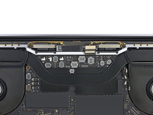

  16. MacBook Pro 15" Touch Bar 2019 Screen Replacement, Screen: crwdns2935265:016crwdnd2935265:01crwdnd2935265:02crwdne2935265:0 MacBook Pro 15" Touch Bar 2019 Screen Replacement, Screen: crwdns2935265:016crwdnd2935265:02crwdnd2935265:02crwdne2935265:0
    • Use a T3 Torx driver to remove the two 3.5 mm screws securing the cover on the display board flex cable.
    • Remove the display board flex cover.
  17. MacBook Pro 15" Touch Bar 2019 Screen Replacement: crwdns2935265:017crwdnd2935265:01crwdnd2935265:02crwdne2935265:0 MacBook Pro 15" Touch Bar 2019 Screen Replacement: crwdns2935265:017crwdnd2935265:02crwdnd2935265:02crwdne2935265:0
    • Use a T3 Torx driver to remove the two 1.7 mm screws securing the bracket for the display board cable connector.
    • Remove the display board cable connector bracket.

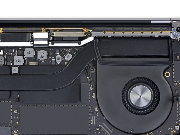

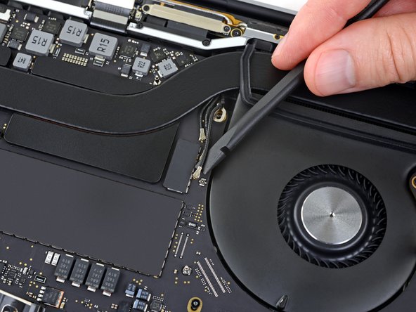

  22. MacBook Pro 15" Touch Bar 2019 Screen Replacement: crwdns2935265:022crwdnd2935265:01crwdnd2935265:03crwdne2935265:0 MacBook Pro 15" Touch Bar 2019 Screen Replacement: crwdns2935265:022crwdnd2935265:02crwdnd2935265:03crwdne2935265:0 MacBook Pro 15" Touch Bar 2019 Screen Replacement: crwdns2935265:022crwdnd2935265:03crwdnd2935265:03crwdne2935265:0
    • Disconnect all three antenna cables by prying each one straight up from its socket.
    • Slide your tweezers or the flat end of your spudger underneath each cable until it's near the socket, and then gently twist or pry up to disconnect it.
    • To reconnect each cable, align the connector directly over its socket, and then press down so it snaps into place.

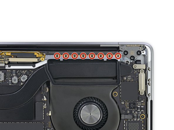

    • Use a P2 Pentalobe driver to remove the sixteen 1.5 mm screws securing the antenna assembly.
  25. MacBook Pro 15" Touch Bar 2019 Screen Replacement: crwdns2935265:025crwdnd2935265:01crwdnd2935265:03crwdne2935265:0 MacBook Pro 15" Touch Bar 2019 Screen Replacement: crwdns2935265:025crwdnd2935265:02crwdnd2935265:03crwdne2935265:0 MacBook Pro 15" Touch Bar 2019 Screen Replacement: crwdns2935265:025crwdnd2935265:03crwdnd2935265:03crwdne2935265:0

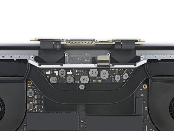

    • Use a T3 Torx driver to remove the four 3.9 mm screws securing the display cable cover springs.
  28. MacBook Pro 15" Touch Bar 2019 Screen Replacement: crwdns2935265:028crwdnd2935265:01crwdnd2935265:02crwdne2935265:0 MacBook Pro 15" Touch Bar 2019 Screen Replacement: crwdns2935265:028crwdnd2935265:02crwdnd2935265:02crwdne2935265:0

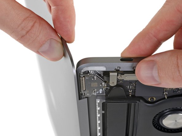

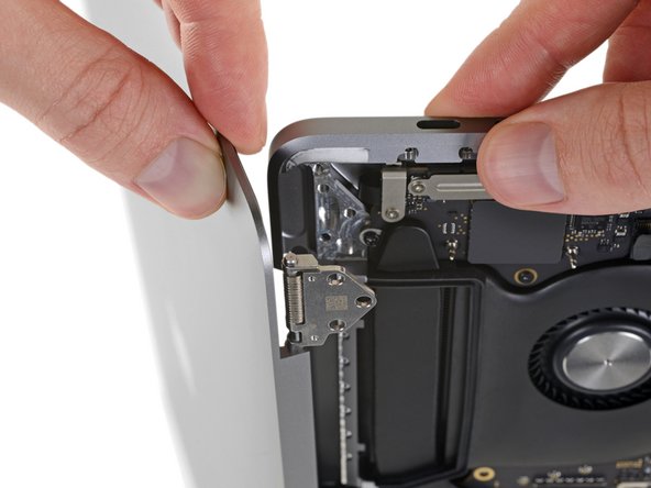

  31. MacBook Pro 15" Touch Bar 2019 Screen Replacement: crwdns2935265:031crwdnd2935265:01crwdnd2935265:03crwdne2935265:0 MacBook Pro 15" Touch Bar 2019 Screen Replacement: crwdns2935265:031crwdnd2935265:02crwdnd2935265:03crwdne2935265:0 MacBook Pro 15" Touch Bar 2019 Screen Replacement: crwdns2935265:031crwdnd2935265:03crwdnd2935265:03crwdne2935265:0
    • Use a T8 Torx driver to remove the two remaining 4.9 mm hinge screws (one from each hinge).
    • Remove the topmost screw last, using one hand to steady both halves of the MacBook Pro to make sure they don't separate and fall over unexpectedly.
  32. MacBook Pro 15" Touch Bar 2019 Screen Replacement: crwdns2935265:032crwdnd2935265:01crwdnd2935265:03crwdne2935265:0 MacBook Pro 15" Touch Bar 2019 Screen Replacement: crwdns2935265:032crwdnd2935265:02crwdnd2935265:03crwdne2935265:0 MacBook Pro 15" Touch Bar 2019 Screen Replacement: crwdns2935265:032crwdnd2935265:03crwdnd2935265:03crwdne2935265:0
    • Keep a firm grip on both the screen and main body of the MacBook Pro. Either half can fall unexpectedly during this step.
    • Push both halves of the MacBook Pro together so that the hinges can be lifted clear of their recesses in the chassis.
    • Push the main body of the MacBook Pro away from you while pulling the screen toward you to separate it.
  33. MacBook Pro 15" Touch Bar 2019 Screen Replacement: crwdns2935265:033crwdnd2935265:01crwdnd2935265:01crwdne2935265:0
    • Remove the screen.
