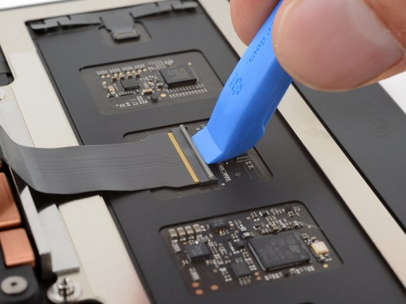

  25. MacBook Pro 14" Late 2023 (M3) Trackpad Replacement, Unlatch the trackpad cable ZIF connector: crwdns2935265:025crwdnd2935265:01crwdnd2935265:02crwdne2935265:0 MacBook Pro 14" Late 2023 (M3) Trackpad Replacement, Unlatch the trackpad cable ZIF connector: crwdns2935265:025crwdnd2935265:02crwdnd2935265:02crwdne2935265:0
    • The remaining steps show how to remove the trackpad cable to transfer it to your new trackpad.
    • Many small components surround the trackpad connector. Be very careful not to pry against them as you work.
    • Use an opening tool or a clean fingernail to flip up the locking flap on the trackpad ZIF connector.

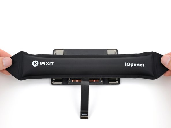

  26. MacBook Pro 14" Late 2023 (M3) Trackpad Replacement, Soften the trackpad cable adhesive: crwdns2935265:026crwdnd2935265:01crwdnd2935265:02crwdne2935265:0 MacBook Pro 14" Late 2023 (M3) Trackpad Replacement, Soften the trackpad cable adhesive: crwdns2935265:026crwdnd2935265:02crwdnd2935265:02crwdne2935265:0
    • Moderately strong adhesive secures the neck of the cable to the trackpad.
    • Heat an iOpener and apply it to the trackpad cable for 30 seconds to soften its adhesive.
    • You can also use a hair dryer or heat gun, but be careful not to melt any of the plastic components on the trackpad.

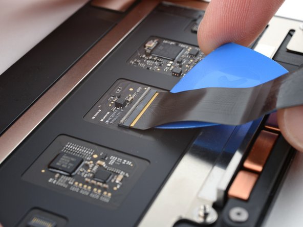

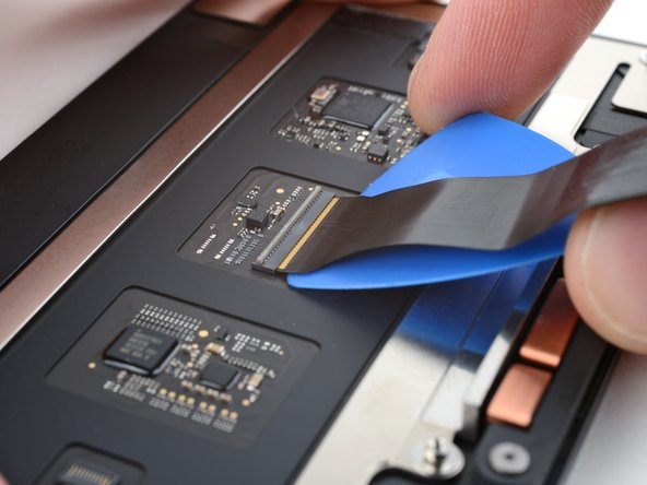

  27. MacBook Pro 14" Late 2023 (M3) Trackpad Replacement, Separate the trackpad cable adhesive: crwdns2935265:027crwdnd2935265:01crwdnd2935265:03crwdne2935265:0 MacBook Pro 14" Late 2023 (M3) Trackpad Replacement, Separate the trackpad cable adhesive: crwdns2935265:027crwdnd2935265:02crwdnd2935265:03crwdne2935265:0 MacBook Pro 14" Late 2023 (M3) Trackpad Replacement, Separate the trackpad cable adhesive: crwdns2935265:027crwdnd2935265:03crwdnd2935265:03crwdne2935265:0
    • Slide the tip of an opening pick under the neck of the trackpad cable and slice its adhesive.
    • Be careful not to crimp the cable or stress the socket as you slice.

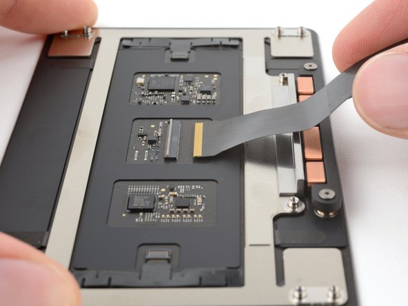

  28. MacBook Pro 14" Late 2023 (M3) Trackpad Replacement, Remove the trackpad cable: crwdns2935265:028crwdnd2935265:01crwdnd2935265:02crwdne2935265:0 MacBook Pro 14" Late 2023 (M3) Trackpad Replacement, Remove the trackpad cable: crwdns2935265:028crwdnd2935265:02crwdnd2935265:02crwdne2935265:0
    • Slide the trackpad cable straight out of its socket to disconnect it.
    • Remove the cable.
