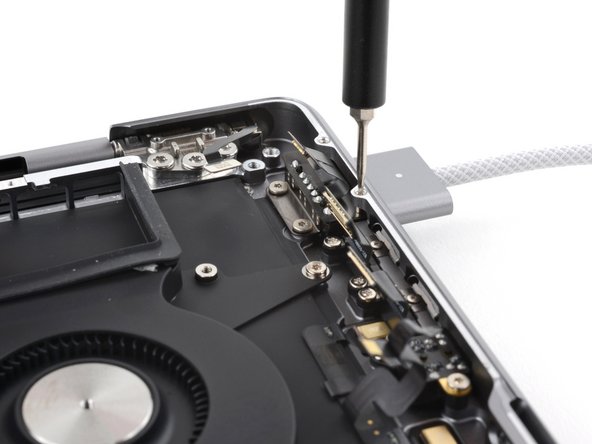

  29. MacBook Pro 14" Late 2023 (M3) MagSafe Port Replacement, Disconnect the MagSafe port: crwdns2935265:029crwdnd2935265:01crwdnd2935265:02crwdne2935265:0 MacBook Pro 14" Late 2023 (M3) MagSafe Port Replacement, Disconnect the MagSafe port: crwdns2935265:029crwdnd2935265:02crwdnd2935265:02crwdne2935265:0
    • Use the flat end of your spudger to pry up and disconnect the MagSafe port press connector.

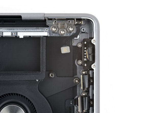

  53. MacBook Pro 14" Late 2023 (M3) MagSafe Port Replacement, Unfasten the MagSafe port: crwdns2935265:053crwdnd2935265:01crwdnd2935265:03crwdne2935265:0 MacBook Pro 14" Late 2023 (M3) MagSafe Port Replacement, Unfasten the MagSafe port: crwdns2935265:053crwdnd2935265:02crwdnd2935265:03crwdne2935265:0 MacBook Pro 14" Late 2023 (M3) MagSafe Port Replacement, Unfasten the MagSafe port: crwdns2935265:053crwdnd2935265:03crwdnd2935265:03crwdne2935265:0
    • Use a 2IP Torx Plus driver to loosen the two set screws in the frame that align the MagSafe port.
    • Don't remove these screws. Just loosen them a few turns above the frame.
    • Depending on the condition of your driver, a T3 Torx bit might fit best.
    • Use your 5IP Torx Plus driver to remove the two 2.7 mm-long screws securing the MagSafe port.
    • These screws are non-magnetic—be careful not to lose them.

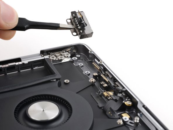

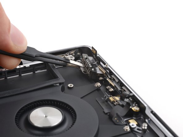

  54. MacBook Pro 14" Late 2023 (M3) MagSafe Port Replacement, Remove the MagSafe port: crwdns2935265:054crwdnd2935265:01crwdnd2935265:03crwdne2935265:0 MacBook Pro 14" Late 2023 (M3) MagSafe Port Replacement, Remove the MagSafe port: crwdns2935265:054crwdnd2935265:02crwdnd2935265:03crwdne2935265:0 MacBook Pro 14" Late 2023 (M3) MagSafe Port Replacement, Remove the MagSafe port: crwdns2935265:054crwdnd2935265:03crwdnd2935265:03crwdne2935265:0
    • Use tweezers or your fingers to pull the MagSafe port out of its recess and remove it.

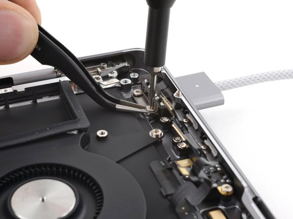

  55. MacBook Pro 14" Late 2023 (M3) MagSafe Port Replacement, Reassembly information: crwdns2935265:055crwdnd2935265:01crwdnd2935265:03crwdne2935265:0 MacBook Pro 14" Late 2023 (M3) MagSafe Port Replacement, Reassembly information: crwdns2935265:055crwdnd2935265:02crwdnd2935265:03crwdne2935265:0 MacBook Pro 14" Late 2023 (M3) MagSafe Port Replacement, Reassembly information: crwdns2935265:055crwdnd2935265:03crwdnd2935265:03crwdne2935265:0
    • Follow this step to align and install your MagSafe port.
    • Hold the MagSafe port in its recess and connect your charger to hold it in place while you work.
    • Use your T5 Torx driver to loosely thread in the two 2.7 mm-long screws. Don't fully tighten them yet.
    • Use your T2 Torx driver to fully tighten the set screws to align the MagSafe port.
    • Fully tighten the two Torx Plus 5IP screws.
