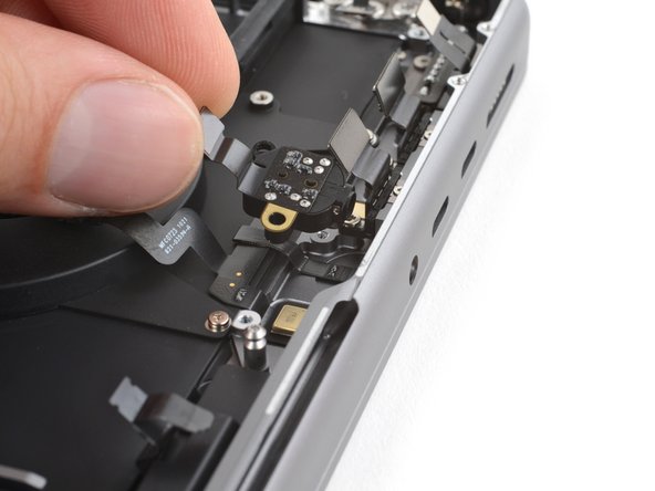

  31. MacBook Pro 14" Late 2023 (M3) Headphone Jack Replacement, Disconnect the headphone jack: crwdns2935265:031crwdnd2935265:01crwdnd2935265:01crwdne2935265:0
    • Use the point of your spudger to pry up and disconnect the headphone jack press connector.

  53. MacBook Pro 14" Late 2023 (M3) Headphone Jack Replacement, Unfasten the headphone jack: crwdns2935265:053crwdnd2935265:01crwdnd2935265:01crwdne2935265:0
    • Use your 5IP Torx Plus driver to remove the two screws securing the headphone jack:
    • One 5.7 mm-long screw
    • One 3.5 mm-long screw
  54. MacBook Pro 14" Late 2023 (M3) Headphone Jack Replacement, Remove the headphone jack: crwdns2935265:054crwdnd2935265:01crwdnd2935265:02crwdne2935265:0 MacBook Pro 14" Late 2023 (M3) Headphone Jack Replacement, Remove the headphone jack: crwdns2935265:054crwdnd2935265:02crwdnd2935265:02crwdne2935265:0
    • Remove the headphone jack.
