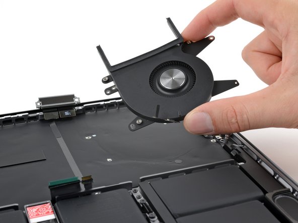

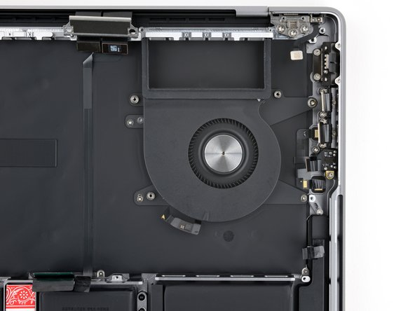

  37. MacBook Pro 14" Late 2023 (M3) Fan Replacement, Unlatch the fan connector: crwdns2935265:037crwdnd2935265:01crwdnd2935265:02crwdne2935265:0 MacBook Pro 14" Late 2023 (M3) Fan Replacement, Unlatch the fan connector: crwdns2935265:037crwdnd2935265:02crwdnd2935265:02crwdne2935265:0
    • The fan cable is adhered to the logic board. To avoid damaging the socket or cable, you'll unlatch the ZIF connector before separating the adhesive.
    • Peel back the tape covering the fan ZIF connector.
    • Flip up the small locking flap on the head of the connector.
  38. MacBook Pro 14" Late 2023 (M3) Fan Replacement, Separate the fan cable adhesive: crwdns2935265:038crwdnd2935265:01crwdnd2935265:02crwdne2935265:0 MacBook Pro 14" Late 2023 (M3) Fan Replacement, Separate the fan cable adhesive: crwdns2935265:038crwdnd2935265:02crwdnd2935265:02crwdne2935265:0
    • Slide the tip of an opening pick under the fan cable to separate the adhesive securing it to the logic board.
  39. MacBook Pro 14" Late 2023 (M3) Fan Replacement, Disconnect the fan: crwdns2935265:039crwdnd2935265:01crwdnd2935265:02crwdne2935265:0 MacBook Pro 14" Late 2023 (M3) Fan Replacement, Disconnect the fan: crwdns2935265:039crwdnd2935265:02crwdnd2935265:02crwdne2935265:0
    • Slide the fan connector straight out of its socket to disconnect it.

  53. MacBook Pro 14" Late 2023 (M3) Fan Replacement, Unfasten the fan: crwdns2935265:053crwdnd2935265:01crwdnd2935265:02crwdne2935265:0 MacBook Pro 14" Late 2023 (M3) Fan Replacement, Unfasten the fan: crwdns2935265:053crwdnd2935265:02crwdnd2935265:02crwdne2935265:0
    • Use your 3IP Torx Plus driver to remove the three 3.4 mm-long screws securing the fan.
    • Use your 5IP Torx Plus driver to remove the 3 mm-long screw securing the top right of the fan.
  54. MacBook Pro 14" Late 2023 (M3) Fan Replacement, Remove the fan: crwdns2935265:054crwdnd2935265:01crwdnd2935265:02crwdne2935265:0 MacBook Pro 14" Late 2023 (M3) Fan Replacement, Remove the fan: crwdns2935265:054crwdnd2935265:02crwdnd2935265:02crwdne2935265:0
    • Remove the fan.
