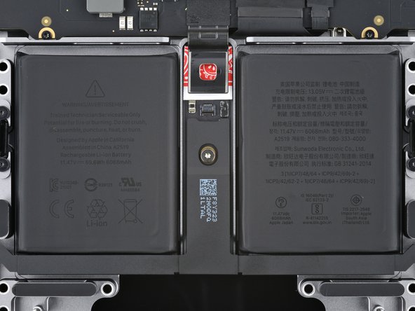

  20. MacBook Pro 14" Late 2023 (M3) Battery Replacement, Unfasten the battery connector: crwdns2935265:020crwdnd2935265:01crwdnd2935265:01crwdne2935265:0
    • Use a 5IP Torx Plus driver to remove the 3.9 mm-long wide-head screw securing the main battery connector.
  21. MacBook Pro 14" Late 2023 (M3) Battery Replacement, Disconnect the main power connector: crwdns2935265:021crwdnd2935265:01crwdnd2935265:03crwdne2935265:0 MacBook Pro 14" Late 2023 (M3) Battery Replacement, Disconnect the main power connector: crwdns2935265:021crwdnd2935265:02crwdnd2935265:03crwdne2935265:0 MacBook Pro 14" Late 2023 (M3) Battery Replacement, Disconnect the main power connector: crwdns2935265:021crwdnd2935265:03crwdnd2935265:03crwdne2935265:0
    • Use the flat end of your spudger to lift the main battery connector away from the battery board, disconnecting the battery.
    • Lift the connector high enough that it doesn't accidentally make contact during the repair, but no more than 45 degrees to prevent breaking it.
    • For added safety, place a non-conductive barrier, such as a piece of a playing card, between the connector and board.

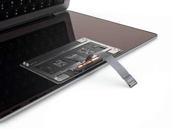

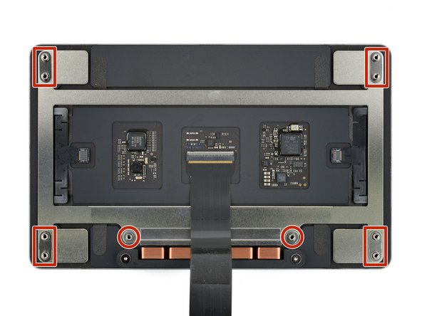

  22. MacBook Pro 14" Late 2023 (M3) Battery Replacement, Unfasten the trackpad: crwdns2935265:022crwdnd2935265:01crwdnd2935265:02crwdne2935265:0 MacBook Pro 14" Late 2023 (M3) Battery Replacement, Unfasten the trackpad: crwdns2935265:022crwdnd2935265:02crwdnd2935265:02crwdne2935265:0
    • Use your 5IP Torx Plus driver to remove the ten 5.8 mm-long screws securing the trackpad.
    • During reassembly, you may need to open your MacBook to check for alignment as you tighten the screws. Adjust the trackpad so that the edges don't rub against the frame.

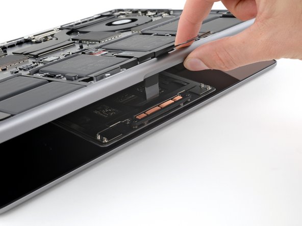

  23. MacBook Pro 14" Late 2023 (M3) Battery Replacement, Lift the body of the MacBook: crwdns2935265:023crwdnd2935265:01crwdnd2935265:03crwdne2935265:0 MacBook Pro 14" Late 2023 (M3) Battery Replacement, Lift the body of the MacBook: crwdns2935265:023crwdnd2935265:02crwdnd2935265:03crwdne2935265:0 MacBook Pro 14" Late 2023 (M3) Battery Replacement, Lift the body of the MacBook: crwdns2935265:023crwdnd2935265:03crwdnd2935265:03crwdne2935265:0
    • Slowly lift the body of your MacBook away from the screen and guide the trackpad cable through its cutout.
    • The trackpad will remain on the screen.
    • During reassembly, make sure all the screw holes align with their holes in the frame as you lower it onto the trackpad.

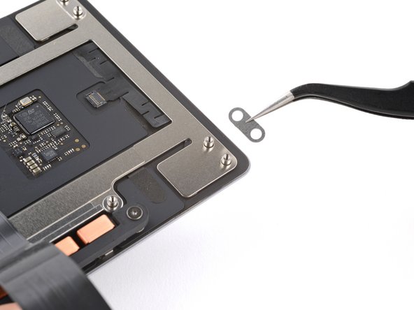

  24. MacBook Pro 14" Late 2023 (M3) Battery Replacement, Remove the trackpad: crwdns2935265:024crwdnd2935265:01crwdnd2935265:03crwdne2935265:0 MacBook Pro 14" Late 2023 (M3) Battery Replacement, Remove the trackpad: crwdns2935265:024crwdnd2935265:02crwdnd2935265:03crwdne2935265:0 MacBook Pro 14" Late 2023 (M3) Battery Replacement, Remove the trackpad: crwdns2935265:024crwdnd2935265:03crwdnd2935265:03crwdne2935265:0
    • Remove the trackpad.
    • Make sure not to lose the six small metal washers from their screw posts on the trackpad. Without them, your trackpad won't sit flush in the frame.

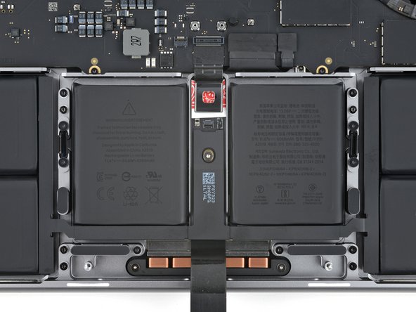

  25. MacBook Pro 14" Late 2023 (M3) Battery Replacement, Unfasten the battery board: crwdns2935265:025crwdnd2935265:01crwdnd2935265:02crwdne2935265:0 MacBook Pro 14" Late 2023 (M3) Battery Replacement, Unfasten the battery board: crwdns2935265:025crwdnd2935265:02crwdnd2935265:02crwdne2935265:0
    • Lower the body of your MacBook flat to the screen.
    • Use your 5IP Torx Plus driver to remove the 4.1 mm-long screw securing the battery board.
  26. MacBook Pro 14" Late 2023 (M3) Battery Replacement, Flip over your MacBook: crwdns2935265:026crwdnd2935265:01crwdnd2935265:01crwdne2935265:0
    • Check that your battery connector isn't sticking out beyond the frame, as it could break when you flip your MacBook over and lay it down.
    • Place a soft cloth on your work surface.
    • Flip your MacBook over and lay it on the cloth.
    • Open the screen enough to access the trackpad recess.

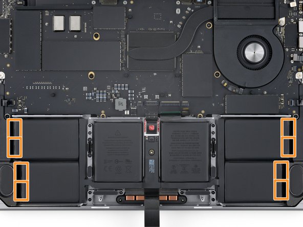

  27. MacBook Pro 14" Late 2023 (M3) Battery Replacement, Adhesive information: crwdns2935265:027crwdnd2935265:01crwdnd2935265:02crwdne2935265:0 MacBook Pro 14" Late 2023 (M3) Battery Replacement, Adhesive information: crwdns2935265:027crwdnd2935265:02crwdnd2935265:02crwdne2935265:0
    • Your MacBook's battery is secured with 14 stretch release adhesive strips. The next five steps show how to remove them and free your battery.
    • Six strips are accessible from the trackpad recess.
    • The remaining eight strips are on the edges of the outer battery cells.

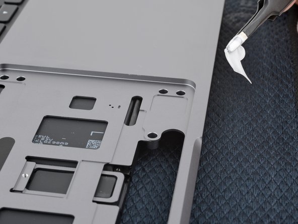

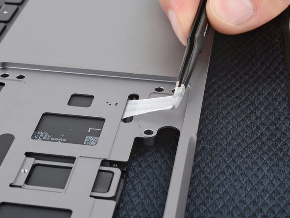

  28. MacBook Pro 14" Late 2023 (M3) Battery Replacement, Remove the stretch release adhesive: crwdns2935265:028crwdnd2935265:01crwdnd2935265:03crwdne2935265:0 MacBook Pro 14" Late 2023 (M3) Battery Replacement, Remove the stretch release adhesive: crwdns2935265:028crwdnd2935265:02crwdnd2935265:03crwdne2935265:0 MacBook Pro 14" Late 2023 (M3) Battery Replacement, Remove the stretch release adhesive: crwdns2935265:028crwdnd2935265:03crwdnd2935265:03crwdne2935265:0
    • Use blunt nose tweezers to grip the black pull tab on one of the adhesive strips through its cutout in the frame.
    • Grip the entire length of the strip's pull tab and pull it slowly, evenly, and at a low angle out from underneath the battery cell. Twist your tool to wrap the strip around itself as you pull.
    • Give the strip plenty of time to stretch. Avoid dragging it over the frame as you pull.
    • If you're using your fingers to remove the strip, re-grip it often to avoid it stretching unevenly and tearing.
    • Repeat for the other five strips accessible from the trackpad recess.
    • If a strip breaks off, try to retrieve it from under the battery. If you can't retrieve it, don't worry! Move on to the next step to remove the other strips, then keep reading for an alternate method to remove the stuck battery cells.
  29. MacBook Pro 14" Late 2023 (M3) Battery Replacement, Flip over your MacBook: crwdns2935265:029crwdnd2935265:01crwdnd2935265:02crwdne2935265:0 MacBook Pro 14" Late 2023 (M3) Battery Replacement, Flip over your MacBook: crwdns2935265:029crwdnd2935265:02crwdnd2935265:02crwdne2935265:0
    • Be careful as you move your MacBook—the middle battery cells might be loose. They won't fall out, but don't let them strain any cables or components.
    • Close the screen and flip over your MacBook, so the battery faces up.
    • There are two pull tabs on the outer edge of each of the four outer battery cells.

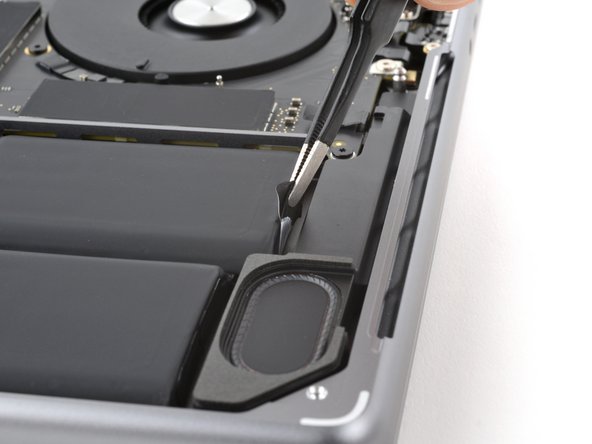

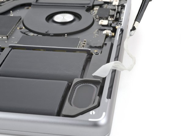

  30. MacBook Pro 14" Late 2023 (M3) Battery Replacement, Peel the pull tabs: crwdns2935265:030crwdnd2935265:01crwdnd2935265:03crwdne2935265:0 MacBook Pro 14" Late 2023 (M3) Battery Replacement, Peel the pull tabs: crwdns2935265:030crwdnd2935265:02crwdnd2935265:03crwdne2935265:0 MacBook Pro 14" Late 2023 (M3) Battery Replacement, Peel the pull tabs: crwdns2935265:030crwdnd2935265:03crwdnd2935265:03crwdne2935265:0
    • Don't use metal or sharp tools near the battery, and be careful not to dent or puncture it.
    • Use the tip of an opening pick to peel up an edge of one of the adhesive strip pull tabs.
    • Use blunt nose tweezers to grip the pull tab and separate it from the edge of the battery cell.

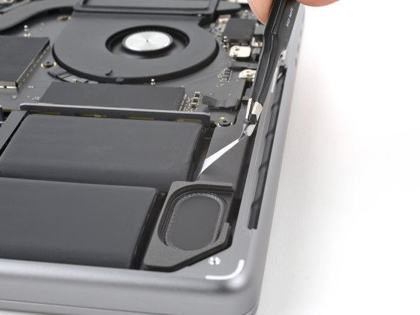

  31. MacBook Pro 14" Late 2023 (M3) Battery Replacement, Remove the stretch release adhesive: crwdns2935265:031crwdnd2935265:01crwdnd2935265:03crwdne2935265:0 MacBook Pro 14" Late 2023 (M3) Battery Replacement, Remove the stretch release adhesive: crwdns2935265:031crwdnd2935265:02crwdnd2935265:03crwdne2935265:0 MacBook Pro 14" Late 2023 (M3) Battery Replacement, Remove the stretch release adhesive: crwdns2935265:031crwdnd2935265:03crwdnd2935265:03crwdne2935265:0
    • Give the strip plenty of time to stretch. Avoid dragging it over the speakers as you pull.
    • Repeat the last two steps for the other seven strips.
    • If a strip breaks off, try to retrieve it from under the battery. If you can't retrieve it, read on to the next step for an alternate method to remove the battery.

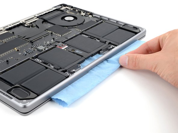

  32. MacBook Pro 14" Late 2023 (M3) Battery Replacement, Alternate method to remove the battery: crwdns2935265:032crwdnd2935265:01crwdnd2935265:02crwdne2935265:0 MacBook Pro 14" Late 2023 (M3) Battery Replacement, Alternate method to remove the battery: crwdns2935265:032crwdnd2935265:02crwdnd2935265:02crwdne2935265:0
    • If you removed all 14 stretch release adhesive strips, you can now remove the battery. If not, follow the next three steps to separate the remaining adhesive with isopropyl alcohol and an opening pick.
    • Open your screen and place a paper towel or absorbent cloth between it and the trackpad recess to protect the screen from any residual isopropyl alcohol.

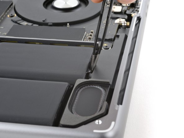

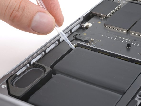

  33. MacBook Pro 14" Late 2023 (M3) Battery Replacement, Apply isopropyl alcohol: crwdns2935265:033crwdnd2935265:01crwdnd2935265:02crwdne2935265:0 MacBook Pro 14" Late 2023 (M3) Battery Replacement, Apply isopropyl alcohol: crwdns2935265:033crwdnd2935265:02crwdnd2935265:02crwdne2935265:0
    • Prop up the edge of your MacBook where the stuck adhesive strips are.
    • Use a pipette or syringe to apply a few drops of highly-concentrated isopropyl alcohol (over 90%) to the outside edges of the stuck battery cells.
    • Wait one minute for the isopropyl alcohol to flow underneath the stuck battery cells and soften the adhesive.

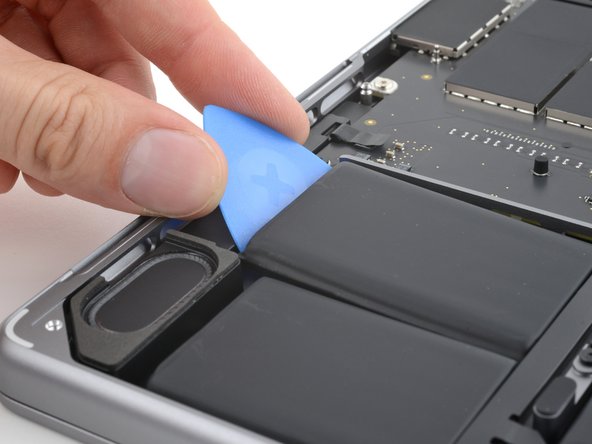

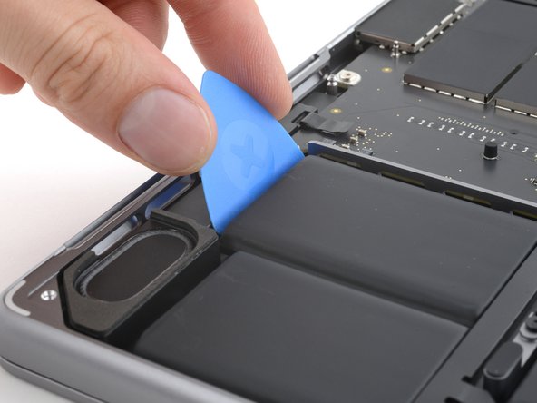

  34. MacBook Pro 14" Late 2023 (M3) Battery Replacement, Pry up the stuck cells: crwdns2935265:034crwdnd2935265:01crwdnd2935265:03crwdne2935265:0 MacBook Pro 14" Late 2023 (M3) Battery Replacement, Pry up the stuck cells: crwdns2935265:034crwdnd2935265:02crwdnd2935265:03crwdne2935265:0 MacBook Pro 14" Late 2023 (M3) Battery Replacement, Pry up the stuck cells: crwdns2935265:034crwdnd2935265:03crwdnd2935265:03crwdne2935265:0
    • Don't bend or crease your battery cells. If they feel stubborn, apply a few more drops of isopropyl alcohol and try again.
    • Insert the flat end of an opening pick between the stuck battery cell and the speaker.
    • Slowly and steadily pry up the battery cell.
    • Depending on how strong your adhesive is, this may take some time. Allow up to a minute of constant pressure for the adhesive to loosen.
    • Repeat this process for any additional stuck cells.

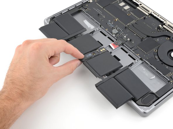

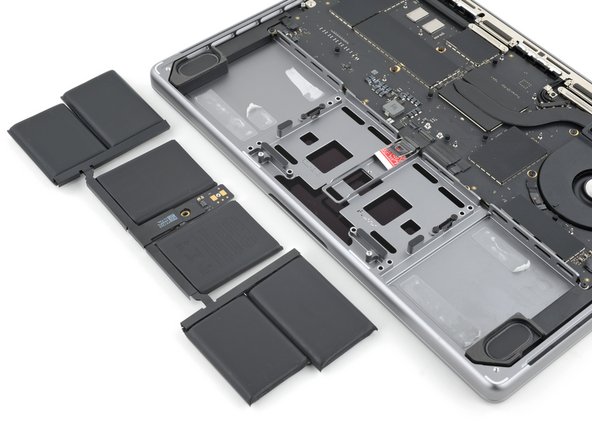

  35. MacBook Pro 14" Late 2023 (M3) Battery Replacement, Remove the battery: crwdns2935265:035crwdnd2935265:01crwdnd2935265:03crwdne2935265:0 MacBook Pro 14" Late 2023 (M3) Battery Replacement, Remove the battery: crwdns2935265:035crwdnd2935265:02crwdnd2935265:03crwdne2935265:0 MacBook Pro 14" Late 2023 (M3) Battery Replacement, Remove the battery: crwdns2935265:035crwdnd2935265:03crwdnd2935265:03crwdne2935265:0
    Tesa 61395 Tape
    $6.99
    • Remove the battery.
    • To install a new battery:
    • Peel any residual adhesive strips from the frame.
    • Clean the frame with isopropyl alcohol and a lint-free or microfiber cloth.
    • If your battery comes with adhesive pre-installed, remove the liners and firmly press each cell into place.
    • If your battery doesn't come with adhesive pre-installed, apply a couple strips of thin, double-sided tape to each cell and firmly press it into place.
For optimal performance, calibrate your newly installed battery after completing this guide.
