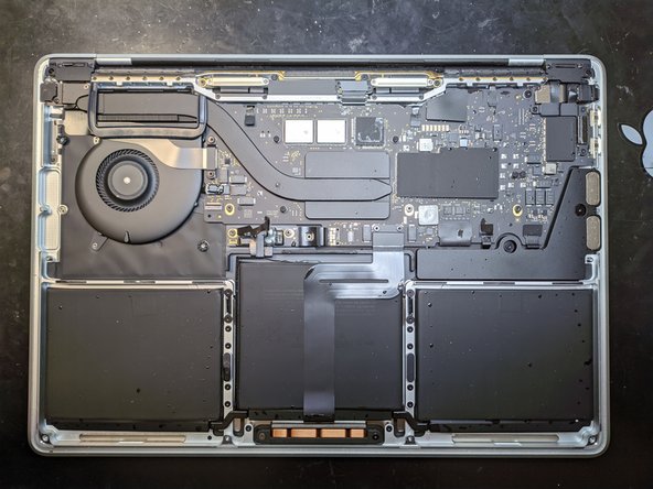

    • Carefully peel up the large piece of tape covering the battery connector, on the edge of the logic board nearest the battery.
    • Remove the tape.
  9. MacBook Pro 13" Late 2020 Right Speaker Replacement: crwdns2935265:09crwdnd2935265:01crwdnd2935265:02crwdne2935265:0 MacBook Pro 13" Late 2020 Right Speaker Replacement: crwdns2935265:09crwdnd2935265:02crwdnd2935265:02crwdne2935265:0

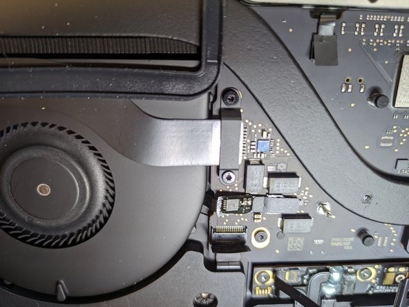

    • Gently peel back the small piece of tape covering the battery board data cable connector.
    • The tape is integrated into the ribbon cable and will not detach completely. Simply peel it back enough to access the connector.
  10. MacBook Pro 13" Late 2020 Right Speaker Replacement: crwdns2935265:010crwdnd2935265:01crwdnd2935265:02crwdne2935265:0 MacBook Pro 13" Late 2020 Right Speaker Replacement: crwdns2935265:010crwdnd2935265:02crwdnd2935265:02crwdne2935265:0
    • Use the tip of a spudger to flip up the small black locking tab securing the cable in its connector.
    • Locking tabs on ZIF connectors are fragile, so be gentle when using the tip of the spudger.

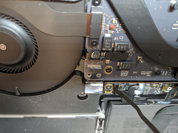

  11. MacBook Pro 13" Late 2020 Right Speaker Replacement: crwdns2935265:011crwdnd2935265:01crwdnd2935265:02crwdne2935265:0 MacBook Pro 13" Late 2020 Right Speaker Replacement: crwdns2935265:011crwdnd2935265:02crwdnd2935265:02crwdne2935265:0
    • Disconnect the battery board data cable by sliding it out from its socket.
    • Slide parallel to the logic board, in the direction of the cable.

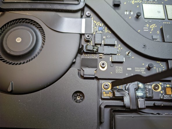

    • Use a T5 Torx driver to remove the 3.7 mm pancake screw securing the battery power connector.
  14. MacBook Pro 13" Late 2020 Right Speaker Replacement: crwdns2935265:014crwdnd2935265:01crwdnd2935265:02crwdne2935265:0 MacBook Pro 13" Late 2020 Right Speaker Replacement: crwdns2935265:014crwdnd2935265:02crwdnd2935265:02crwdne2935265:0
    • Use a spudger to gently lift the battery power connector, disconnecting the battery.
    • Lift the connector high enough so that it stays separated from its socket.
    • If it accidentally makes contact during the course of your repair, it could damage your MacBook Pro.

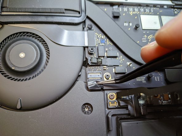

    • Lift the adhesive covering the right speaker connector using a pair of tweezers to pull it towards you.
  16. MacBook Pro 13" Late 2020 Right Speaker Replacement: crwdns2935265:016crwdnd2935265:01crwdnd2935265:02crwdne2935265:0 MacBook Pro 13" Late 2020 Right Speaker Replacement: crwdns2935265:016crwdnd2935265:02crwdnd2935265:02crwdne2935265:0
    • Use the flat side of a spudger to rotate the locking tab of the ZIF connector upwards.
  17. MacBook Pro 13" Late 2020 Right Speaker Replacement: crwdns2935265:017crwdnd2935265:01crwdnd2935265:02crwdne2935265:0 MacBook Pro 13" Late 2020 Right Speaker Replacement: crwdns2935265:017crwdnd2935265:02crwdnd2935265:02crwdne2935265:0
    • Pull the ribbon cable out of its socket using a pair of tweezers.

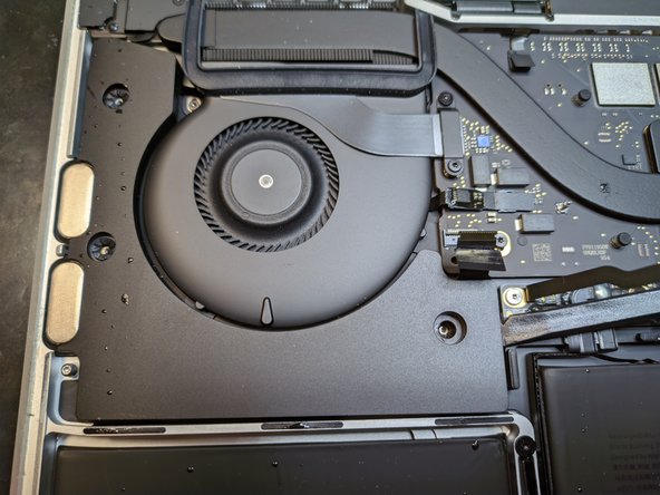

    • Remove the three 2.85mm T5 Torx screws holding the right speaker in place.
  19. MacBook Pro 13" Late 2020 Right Speaker Replacement, Remove the right speaker: crwdns2935265:019crwdnd2935265:01crwdnd2935265:03crwdne2935265:0 MacBook Pro 13" Late 2020 Right Speaker Replacement, Remove the right speaker: crwdns2935265:019crwdnd2935265:02crwdnd2935265:03crwdne2935265:0 MacBook Pro 13" Late 2020 Right Speaker Replacement, Remove the right speaker: crwdns2935265:019crwdnd2935265:03crwdnd2935265:03crwdne2935265:0
    • Slide the flat side of the spudger under the right speaker, next to the battery board.
    • Push the spudger down to lift the right speaker out of its socket.
    • Remove the right speaker from its housing.
    • Be careful not to slip the anti-vibration gasket in the screw holes. Otherwise it will be very difficult to rethread during reassembly.
