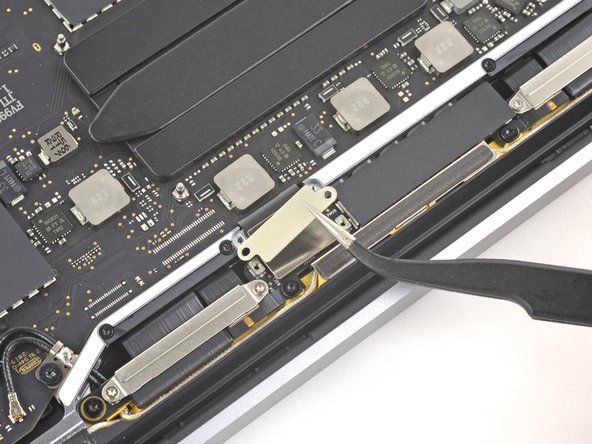

    1. MacBook Pro 13" 2022 (M2) Display Assembly Replacement, Remove the display cable bracket: crwdns2935265:015crwdnd2935265:01crwdnd2935265:02crwdne2935265:0 MacBook Pro 13" 2022 (M2) Display Assembly Replacement, Remove the display cable bracket: crwdns2935265:015crwdnd2935265:02crwdnd2935265:02crwdne2935265:0
      • Use a T3 Torx driver to remove the two 3.1 mm screws securing the display cable retaining bracket.
      • Remove the bracket.

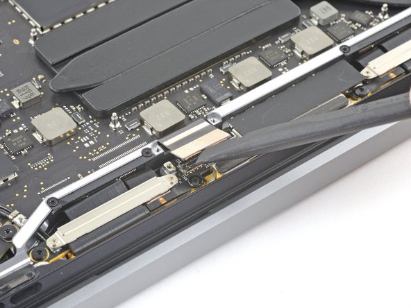

    3. MacBook Pro 13" 2022 (M2) Display Assembly Replacement, Disconnect the display: crwdns2935265:017crwdnd2935265:01crwdnd2935265:02crwdne2935265:0 MacBook Pro 13" 2022 (M2) Display Assembly Replacement, Disconnect the display: crwdns2935265:017crwdnd2935265:02crwdnd2935265:02crwdne2935265:0
      • Use the flat end of your spudger to pry up and disconnect the display cable from the display board.

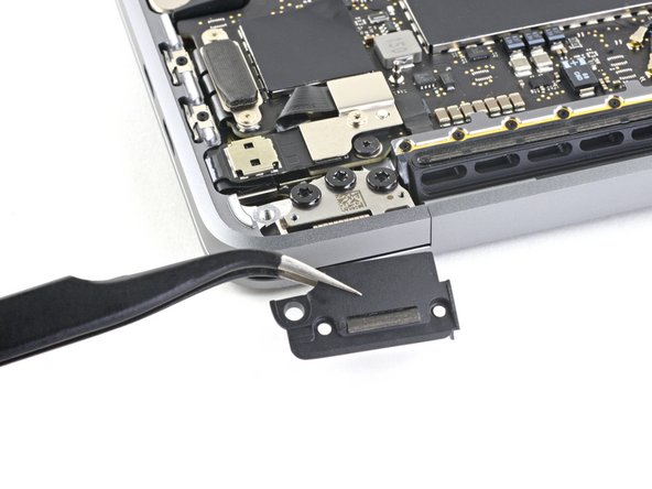

    2. MacBook Pro 13" 2022 (M2) Display Assembly Replacement, Remove the plastic covers: crwdns2935265:019crwdnd2935265:01crwdnd2935265:03crwdne2935265:0 MacBook Pro 13" 2022 (M2) Display Assembly Replacement, Remove the plastic covers: crwdns2935265:019crwdnd2935265:02crwdnd2935265:03crwdne2935265:0 MacBook Pro 13" 2022 (M2) Display Assembly Replacement, Remove the plastic covers: crwdns2935265:019crwdnd2935265:03crwdnd2935265:03crwdne2935265:0
      • Remove the plastic covers from the screen hinges.

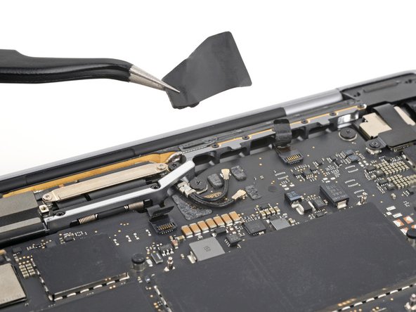

    3. MacBook Pro 13" 2022 (M2) Display Assembly Replacement, Remove the antenna cable cover: crwdns2935265:020crwdnd2935265:01crwdnd2935265:02crwdne2935265:0 MacBook Pro 13" 2022 (M2) Display Assembly Replacement, Remove the antenna cable cover: crwdns2935265:020crwdnd2935265:02crwdnd2935265:02crwdne2935265:0
      • Peel and remove the plastic cover from the antenna cables.
      • During reassembly, don't worry if your foam strips are torn. Re-adhere the plastic cover as well as you can. Use small pieces of tape to secure the cover, if necessary.

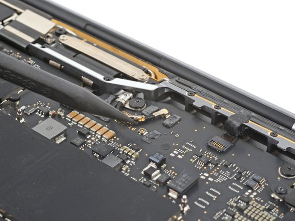

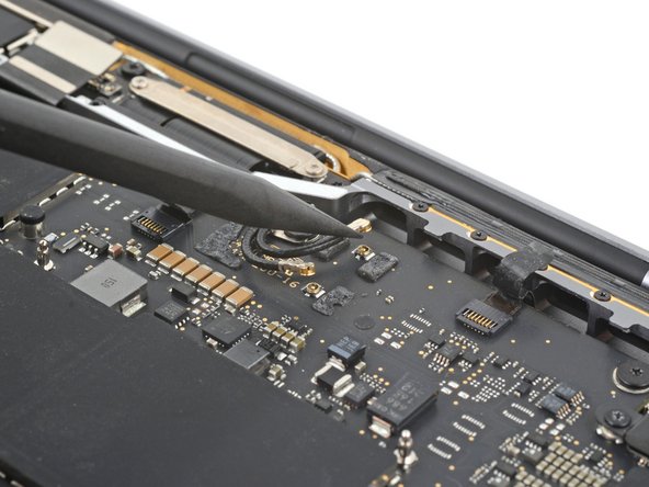

    4. MacBook Pro 13" 2022 (M2) Display Assembly Replacement, Disconnect the antenna bar: crwdns2935265:021crwdnd2935265:01crwdnd2935265:03crwdne2935265:0 MacBook Pro 13" 2022 (M2) Display Assembly Replacement, Disconnect the antenna bar: crwdns2935265:021crwdnd2935265:02crwdnd2935265:03crwdne2935265:0 MacBook Pro 13" 2022 (M2) Display Assembly Replacement, Disconnect the antenna bar: crwdns2935265:021crwdnd2935265:03crwdnd2935265:03crwdne2935265:0
      • Use the point of your spudger to pry up and disconnect the antenna cables from the logic board.
      • Pry straight up on the metal head of the connector. Avoid lifting the cable itself as much as possible.
      • To reconnect the cables, align the connectors directly over their sockets and press down with the flat end of a spudger until they snap into place.

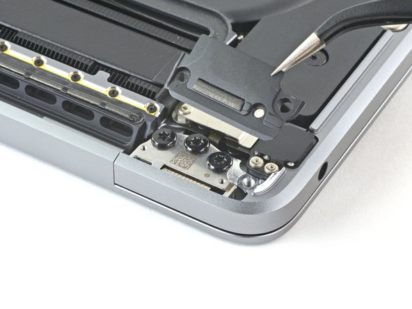

    5. MacBook Pro 13" 2022 (M2) Display Assembly Replacement, Remove the display board cable covers: crwdns2935265:022crwdnd2935265:01crwdnd2935265:03crwdne2935265:0 MacBook Pro 13" 2022 (M2) Display Assembly Replacement, Remove the display board cable covers: crwdns2935265:022crwdnd2935265:02crwdnd2935265:03crwdne2935265:0 MacBook Pro 13" 2022 (M2) Display Assembly Replacement, Remove the display board cable covers: crwdns2935265:022crwdnd2935265:03crwdnd2935265:03crwdne2935265:0
      • Use your T3 Torx driver to remove the four 1.5 mm screws securing the two display board cable covers.
      • Remove the covers.

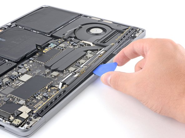

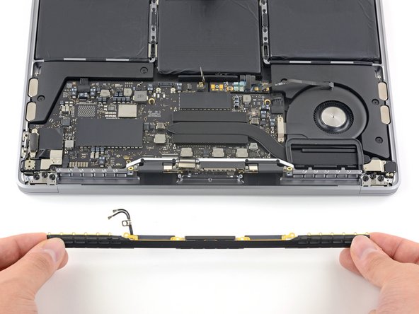

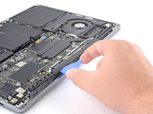

    8. MacBook Pro 13" 2022 (M2) Display Assembly Replacement, Pry up the antenna bar: crwdns2935265:025crwdnd2935265:01crwdnd2935265:03crwdne2935265:0 MacBook Pro 13" 2022 (M2) Display Assembly Replacement, Pry up the antenna bar: crwdns2935265:025crwdnd2935265:02crwdnd2935265:03crwdne2935265:0 MacBook Pro 13" 2022 (M2) Display Assembly Replacement, Pry up the antenna bar: crwdns2935265:025crwdnd2935265:03crwdnd2935265:03crwdne2935265:0
      • Insert your opening pick between the antenna bar and the frame.
      • Pry at different spots along the length of the antenna bar to free it from its recess in the frame.
      • Don't slide your pick, as it may damage display cables underneath the antenna bar.

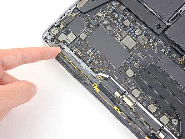

    9. MacBook Pro 13" 2022 (M2) Display Assembly Replacement, Remove the antenna bar: crwdns2935265:026crwdnd2935265:01crwdnd2935265:03crwdne2935265:0 MacBook Pro 13" 2022 (M2) Display Assembly Replacement, Remove the antenna bar: crwdns2935265:026crwdnd2935265:02crwdnd2935265:03crwdne2935265:0 MacBook Pro 13" 2022 (M2) Display Assembly Replacement, Remove the antenna bar: crwdns2935265:026crwdnd2935265:03crwdnd2935265:03crwdne2935265:0
      • Pull the left edge of the antenna bar away from the frame and feed its two antenna cables out from underneath the cutouts in the frame.
      • Remove the antenna bar.

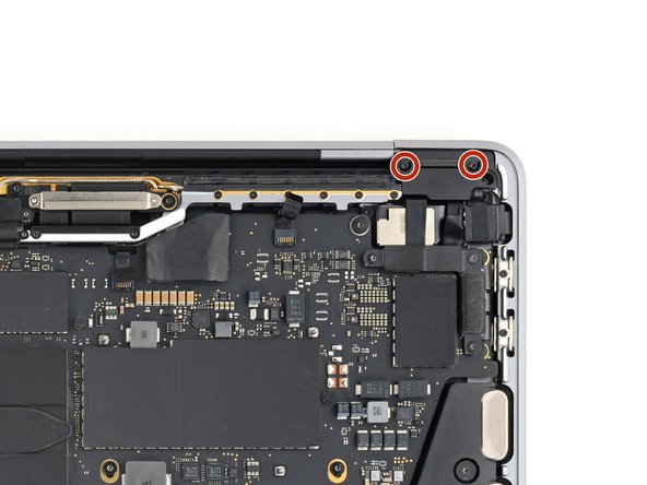

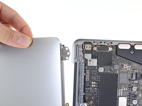

    3. MacBook Pro 13" 2022 (M2) Display Assembly Replacement, Unfasten the display assembly: crwdns2935265:029crwdnd2935265:01crwdnd2935265:02crwdne2935265:0 MacBook Pro 13" 2022 (M2) Display Assembly Replacement, Unfasten the display assembly: crwdns2935265:029crwdnd2935265:02crwdnd2935265:02crwdne2935265:0
      • Open the screen of your MacBook and prop it on its side with its screen facing away from you.
      • Hold your MacBook steady during this step, as either the frame or the display assembly could fall unexpectedly at any point.
      • Use your T8 Torx driver to remove the three 4.4 mm screws securing the bottom hinge.
      • Remove the three 4.4 mm screws securing the top hinge.

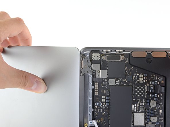

    4. MacBook Pro 13" 2022 (M2) Display Assembly Replacement, Remove the display assembly: crwdns2935265:030crwdnd2935265:01crwdnd2935265:03crwdne2935265:0 MacBook Pro 13" 2022 (M2) Display Assembly Replacement, Remove the display assembly: crwdns2935265:030crwdnd2935265:02crwdnd2935265:03crwdne2935265:0 MacBook Pro 13" 2022 (M2) Display Assembly Replacement, Remove the display assembly: crwdns2935265:030crwdnd2935265:03crwdnd2935265:03crwdne2935265:0
      • Keep a firm grip on both the display and main body of the MacBook. Either half can fall unexpectedly during this step.
      • Push both halves of the MacBook together so that the hinge brackets can be lifted clear of their recesses in the chassis.
      • Push the main body of the MacBook away from you while pulling the display toward you to separate it.
      • Remove the display assembly, being careful not to snag it on any cables.
      • During reassembly:
      • Install the hinge screws loosely and adjust the display until each hinge is centered. Finally, tighten down the screws.
      • If your display clicks or snaps when opening or closing, loosen the hinge screws and adjust the alignment. Make sure the display assembly doesn't sit too far forward, or it can catch on the chassis edge when opening and closing.
