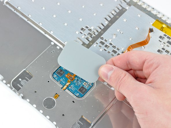

      • If you have a brown upper case cable, follow this and the following steps to replace your upper case cable.
      • Carefully peel the upper case cable off the adhesive securing it to the upper case.
    2. MacBook Core 2 Duo Upper Case Cable Replacement: crwdns2935265:014crwdnd2935265:01crwdnd2935265:02crwdne2935265:0 MacBook Core 2 Duo Upper Case Cable Replacement: crwdns2935265:014crwdnd2935265:02crwdnd2935265:02crwdne2935265:0
      • Use the flat end of a spudger to carefully peel up the adhesive around the perimeter of the plastic panel stuck to the underside of the trackpad.
      • Remove the panel from the upper case.
    3. MacBook Core 2 Duo Upper Case Cable Replacement: crwdns2935265:015crwdnd2935265:01crwdnd2935265:02crwdne2935265:0 MacBook Core 2 Duo Upper Case Cable Replacement: crwdns2935265:015crwdnd2935265:02crwdnd2935265:02crwdne2935265:0
      • Use the tip of a spudger or your fingernail to flip up the retaining flap on the upper case cable ZIF socket near the keyboard cable.
      • Be sure you are prying up on the retaining flap, not the socket itself.

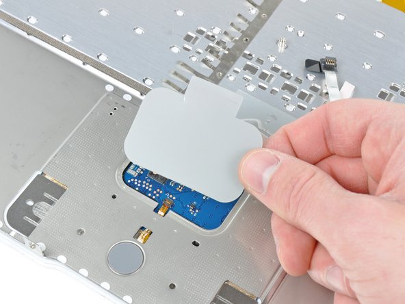

    10. MacBook Core 2 Duo Upper Case Cable Replacement: crwdns2935265:022crwdnd2935265:01crwdnd2935265:02crwdne2935265:0 MacBook Core 2 Duo Upper Case Cable Replacement: crwdns2935265:022crwdnd2935265:02crwdnd2935265:02crwdne2935265:0
