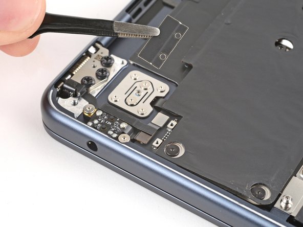

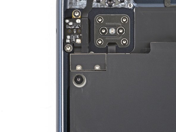

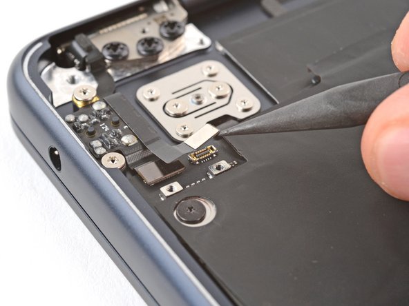

    13. MacBook Air 2022 (M2) Screen Replacement, Disconnect the lid-angle sensor: crwdns2935265:024crwdnd2935265:01crwdnd2935265:02crwdne2935265:0 MacBook Air 2022 (M2) Screen Replacement, Disconnect the lid-angle sensor: crwdns2935265:024crwdnd2935265:02crwdnd2935265:02crwdne2935265:0
      • Use a T3 Torx screwdriver to remove the two 1.5 mm screws securing the lid-angle sensor connector cover.
    14. MacBook Air 2022 (M2) Screen Replacement: crwdns2935265:025crwdnd2935265:01crwdnd2935265:02crwdne2935265:0 MacBook Air 2022 (M2) Screen Replacement: crwdns2935265:025crwdnd2935265:02crwdnd2935265:02crwdne2935265:0
      • Remove the lid-angle sensor connector cover.
    15. MacBook Air 2022 (M2) Screen Replacement: crwdns2935265:026crwdnd2935265:01crwdnd2935265:02crwdne2935265:0 MacBook Air 2022 (M2) Screen Replacement: crwdns2935265:026crwdnd2935265:02crwdnd2935265:02crwdne2935265:0
      • Use the pointed end of a spudger to pry up and disconnect lid angle sensor press connector.
    16. MacBook Air 2022 (M2) Screen Replacement: crwdns2935265:027crwdnd2935265:01crwdnd2935265:02crwdne2935265:0 MacBook Air 2022 (M2) Screen Replacement: crwdns2935265:027crwdnd2935265:02crwdnd2935265:02crwdne2935265:0
      • Gently peel the lid angle sensor cable from the top of the headphone jack and move it out of the way.
    17. MacBook Air 2022 (M2) Screen Replacement, Check for a lid‑angle sensor: crwdns2935265:028crwdnd2935265:01crwdnd2935265:03crwdne2935265:0 MacBook Air 2022 (M2) Screen Replacement, Check for a lid‑angle sensor: crwdns2935265:028crwdnd2935265:02crwdnd2935265:03crwdne2935265:0 MacBook Air 2022 (M2) Screen Replacement, Check for a lid‑angle sensor: crwdns2935265:028crwdnd2935265:03crwdnd2935265:03crwdne2935265:0
      • Check if your replacement screen has a lid‑angle sensor installed on the hinge. If it does, skip this step. Otherwise, follow this step to remove the sensor—you'll need to transfer it to your replacement screen.
      • Use the point of a spudger to lift the flap covering the lid‑angle sensor screw, located on the left hinge.
      • Use a 1IP Torx Plus driver to remove the screw securing the lid‑angle sensor.
      • Remove the lid‑angle sensor and set it aside for reassembly.

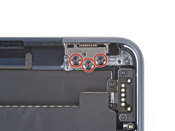

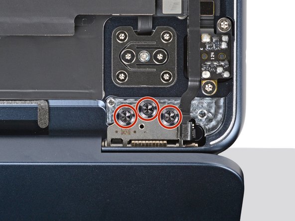

    18. MacBook Air 2022 (M2) Screen Replacement, Loosen the hinge screws: crwdns2935265:029crwdnd2935265:01crwdnd2935265:02crwdne2935265:0 MacBook Air 2022 (M2) Screen Replacement, Loosen the hinge screws: crwdns2935265:029crwdnd2935265:02crwdnd2935265:02crwdne2935265:0
      • Use an 8IP Torx Plus driver to loosen (not remove) the six hinge screws.

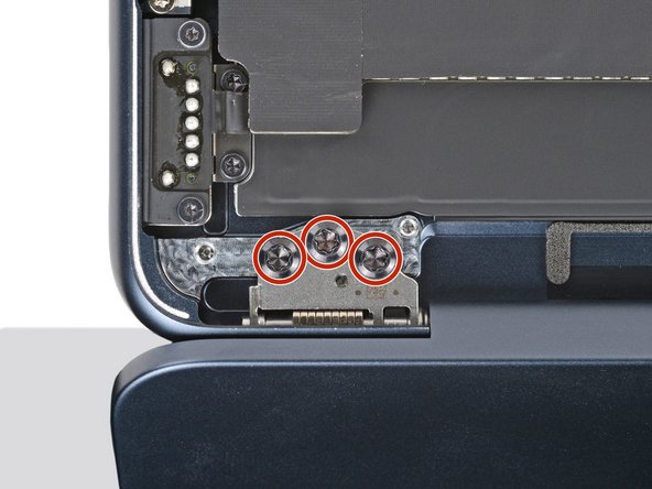

    20. MacBook Air 2022 (M2) Screen Replacement, Remove the hinge screws: crwdns2935265:031crwdnd2935265:01crwdnd2935265:03crwdne2935265:0 MacBook Air 2022 (M2) Screen Replacement, Remove the hinge screws: crwdns2935265:031crwdnd2935265:02crwdnd2935265:03crwdne2935265:0 MacBook Air 2022 (M2) Screen Replacement, Remove the hinge screws: crwdns2935265:031crwdnd2935265:03crwdnd2935265:03crwdne2935265:0
      • Support the screen with one hand and use your free hand to remove the six 4.3 mm 8IP Torx Plus screws securing the hinges.
      • Keep a firm grip on your laptop, as it can easily fall off the table.

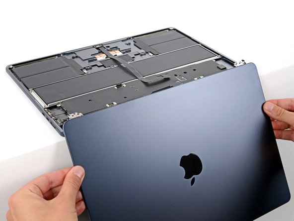

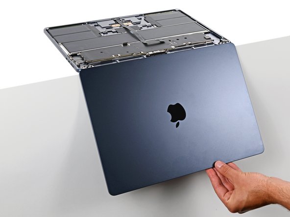

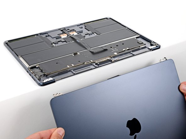

    21. MacBook Air 2022 (M2) Screen Replacement, Remove the screen: crwdns2935265:032crwdnd2935265:01crwdnd2935265:03crwdne2935265:0 MacBook Air 2022 (M2) Screen Replacement, Remove the screen: crwdns2935265:032crwdnd2935265:02crwdnd2935265:03crwdne2935265:0 MacBook Air 2022 (M2) Screen Replacement, Remove the screen: crwdns2935265:032crwdnd2935265:03crwdnd2935265:03crwdne2935265:0
      • Hold the screen with both hands and lift the hinges out of their recesses to remove the screen.
      • During reassembly:
      • Make sure the screen hinges are fully open and guide them into their recesses in the frame.
      • Install and partially tighten the six hinge screws.
      • Close your laptop and make sure the screen is properly aligned. If it clicks or snaps, readjust the alignment.
      • Fully tighten the hinge screws.
