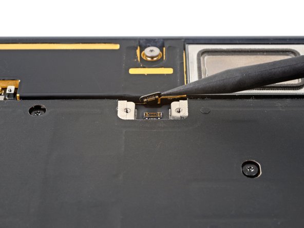

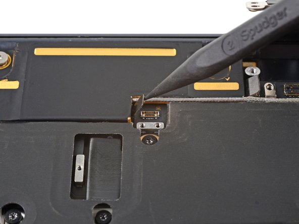

  10. MacBook Air 2022 (M2) Battery Replacement, Disconnect the battery: crwdns2935265:010crwdnd2935265:01crwdnd2935265:02crwdne2935265:0 MacBook Air 2022 (M2) Battery Replacement, Disconnect the battery: crwdns2935265:010crwdnd2935265:02crwdnd2935265:02crwdne2935265:0
    • Use an opening pick to pry up and disconnect the battery press connector.
    • To reconnect a press connector, align it over the socket and gently press down on one side until it clicks into place, then press down on the other side. It might take a few tries to align the connector.

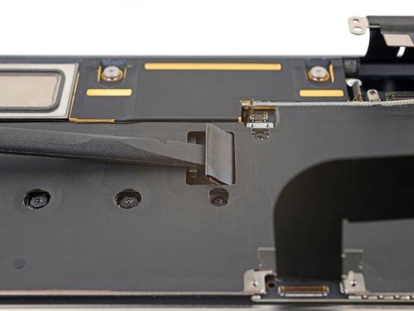

  11. MacBook Air 2022 (M2) Battery Replacement, Unfasten the trackpad cable cover: crwdns2935265:011crwdnd2935265:01crwdnd2935265:01crwdne2935265:0
    • Use a T3 Torx driver to remove the two 1.5 mm screws securing the trackpad cable cover.
  12. MacBook Air 2022 (M2) Battery Replacement, Access the trackpad press connector: crwdns2935265:012crwdnd2935265:01crwdnd2935265:02crwdne2935265:0 MacBook Air 2022 (M2) Battery Replacement, Access the trackpad press connector: crwdns2935265:012crwdnd2935265:02crwdnd2935265:02crwdne2935265:0
    • Use a spudger or your fingers to move the trackpad cable cover out of the way so you can access the press connector underneath.
  13. MacBook Air 2022 (M2) Battery Replacement, Disconnect the trackpad cable: crwdns2935265:013crwdnd2935265:01crwdnd2935265:02crwdne2935265:0 MacBook Air 2022 (M2) Battery Replacement, Disconnect the trackpad cable: crwdns2935265:013crwdnd2935265:02crwdnd2935265:02crwdne2935265:0
    • Use the pointed end of a spudger to pry up and disconnect the trackpad cable press connector.
    • To re-attach press connectors like this one, carefully align and press down on one side until it clicks into place, then repeat on the other side. Do not press down in the middle. If the connector is misaligned, the pins can bend and cause permanent damage.

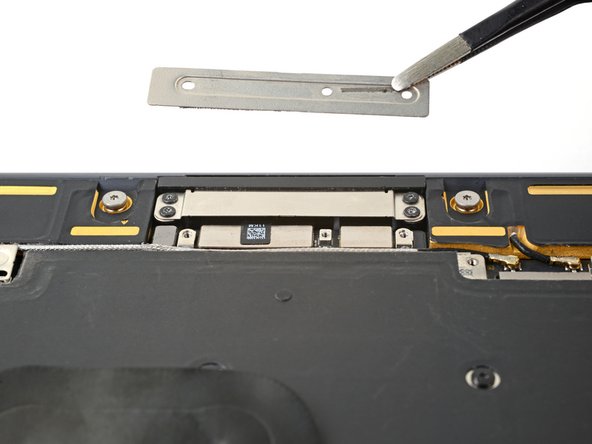

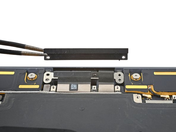

  15. MacBook Air 2022 (M2) Battery Replacement, Remove the cable covers: crwdns2935265:015crwdnd2935265:01crwdnd2935265:02crwdne2935265:0 MacBook Air 2022 (M2) Battery Replacement, Remove the cable covers: crwdns2935265:015crwdnd2935265:02crwdnd2935265:02crwdne2935265:0
    • Use a T3 Torx driver to remove the fourteen 1.5 mm screws securing the various cable covers.
  16. MacBook Air 2022 (M2) Battery Replacement: crwdns2935265:016crwdnd2935265:01crwdnd2935265:03crwdne2935265:0 MacBook Air 2022 (M2) Battery Replacement: crwdns2935265:016crwdnd2935265:02crwdnd2935265:03crwdne2935265:0 MacBook Air 2022 (M2) Battery Replacement: crwdns2935265:016crwdnd2935265:03crwdnd2935265:03crwdne2935265:0
    • Use tweezers or your fingers to remove the six cable covers.
  17. MacBook Air 2022 (M2) Battery Replacement: crwdns2935265:017crwdnd2935265:01crwdnd2935265:02crwdne2935265:0 MacBook Air 2022 (M2) Battery Replacement: crwdns2935265:017crwdnd2935265:02crwdnd2935265:02crwdne2935265:0

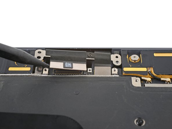

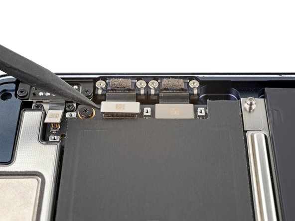

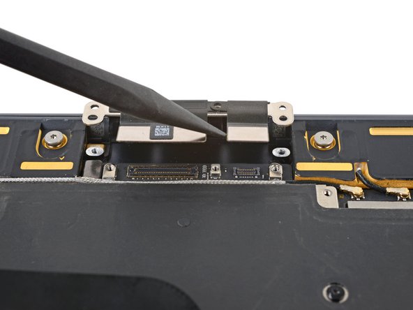

  19. MacBook Air 2022 (M2) Battery Replacement, Disconnect the logic board connectors: crwdns2935265:019crwdnd2935265:01crwdnd2935265:03crwdne2935265:0 MacBook Air 2022 (M2) Battery Replacement, Disconnect the logic board connectors: crwdns2935265:019crwdnd2935265:02crwdnd2935265:03crwdne2935265:0 MacBook Air 2022 (M2) Battery Replacement, Disconnect the logic board connectors: crwdns2935265:019crwdnd2935265:03crwdnd2935265:03crwdne2935265:0
    • Use the pointed end of a spudger to pry up and disconnect both display cable press connectors.

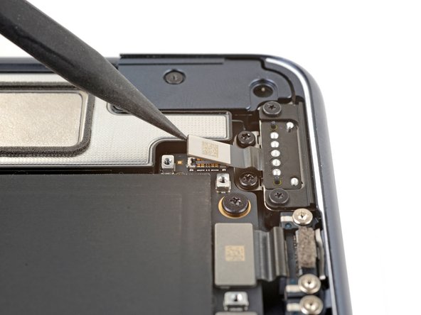

    • Disconnect the MagSafe port press connector.

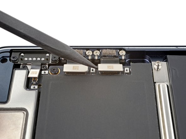

    • Disconnect both Thunderbolt port press connectors.

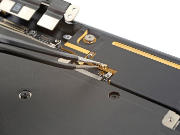

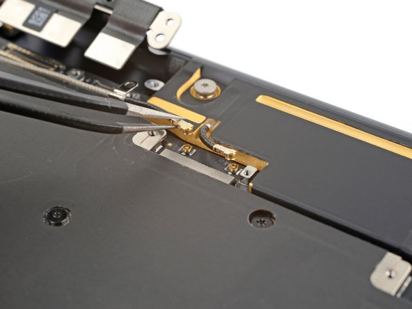

  25. MacBook Air 2022 (M2) Battery Replacement: crwdns2935265:025crwdnd2935265:01crwdnd2935265:03crwdne2935265:0 MacBook Air 2022 (M2) Battery Replacement: crwdns2935265:025crwdnd2935265:02crwdnd2935265:03crwdne2935265:0 MacBook Air 2022 (M2) Battery Replacement: crwdns2935265:025crwdnd2935265:03crwdnd2935265:03crwdne2935265:0
    • Use a pair of tweezers to grip the first antenna connector, as close to its base as possible.
    • Lift straight up to disconnect the cable.
    • The antenna connectors on the logic board are very fragile. When disconnecting the cables, pull straight up—don’t bend them to the side.
    • Repeat for the second antenna cable.
    • To reattach antenna connectors like these, align the connector over its socket and press down with the flat end of a spudger. The connector should snap into place. This can be tricky and may take a few tries.

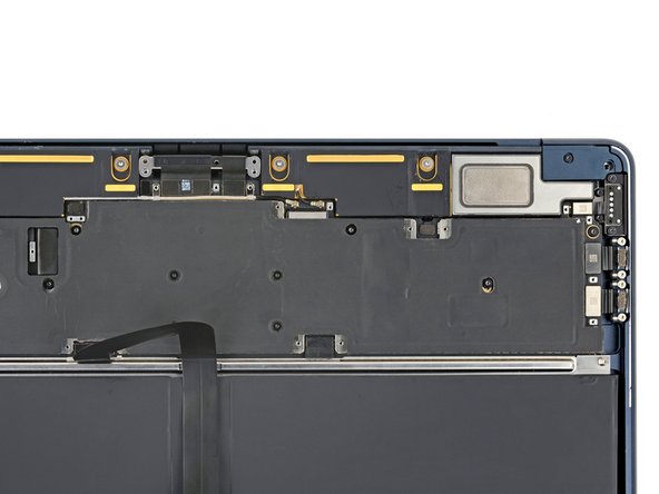

  26. MacBook Air 2022 (M2) Battery Replacement, Unfasten the logic board: crwdns2935265:026crwdnd2935265:01crwdnd2935265:02crwdne2935265:0 MacBook Air 2022 (M2) Battery Replacement, Unfasten the logic board: crwdns2935265:026crwdnd2935265:02crwdnd2935265:02crwdne2935265:0
    • Remove the nine screws securing the logic board:
    • Three 3.8 mm T5 Torx screws
    • One 3.6 mm T5 Torx screw
    • Two 3.4 mm T5 Torx screws
    • One 3.1 mm T5 Torx screw
    • Two 2.7 mm 3IP Torx Plus screws

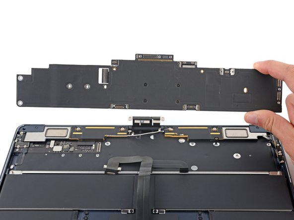

  27. MacBook Air 2022 (M2) Battery Replacement, Remove the logic board: crwdns2935265:027crwdnd2935265:01crwdnd2935265:03crwdne2935265:0 MacBook Air 2022 (M2) Battery Replacement, Remove the logic board: crwdns2935265:027crwdnd2935265:02crwdnd2935265:03crwdne2935265:0 MacBook Air 2022 (M2) Battery Replacement, Remove the logic board: crwdns2935265:027crwdnd2935265:03crwdnd2935265:03crwdne2935265:0
    • The logic board and its cover are connected and remove as one assembly.
    • The cover extends out from the logic board's left edge and bends easily. Don't pull the board up from this side.
    • Grip the right side of the logic board and slide it towards the trackpad until it clears the overhangs near the speakers.
    • Remove the logic board.

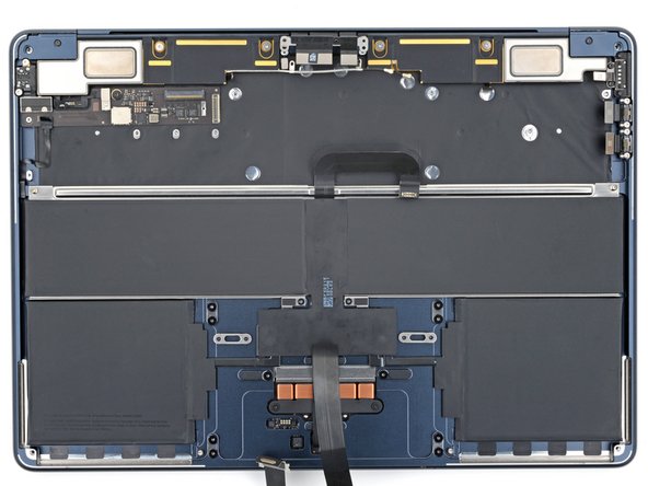

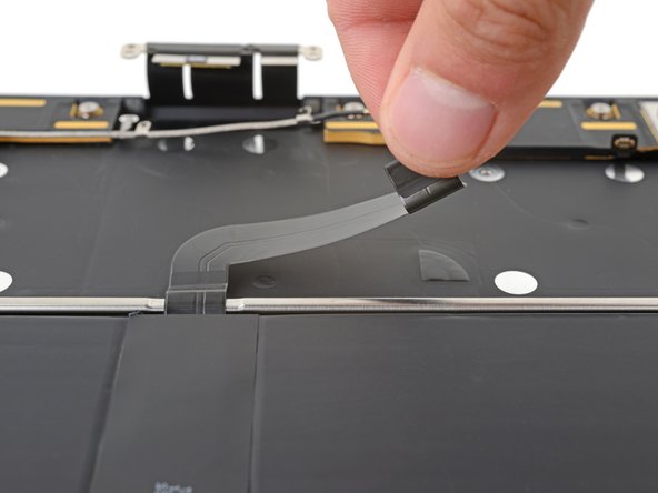

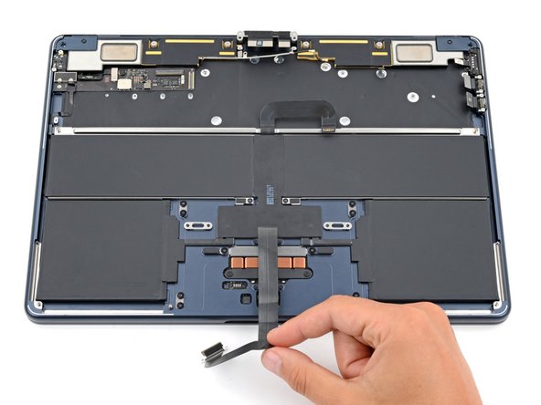

  29. MacBook Air 2022 (M2) Battery Replacement, Reposition the trackpad cable: crwdns2935265:029crwdnd2935265:01crwdnd2935265:02crwdne2935265:0 MacBook Air 2022 (M2) Battery Replacement, Reposition the trackpad cable: crwdns2935265:029crwdnd2935265:02crwdnd2935265:02crwdne2935265:0
    • Reposition the trackpad cable over the bottom edge of the MacBook so it's out of the way of the battery.

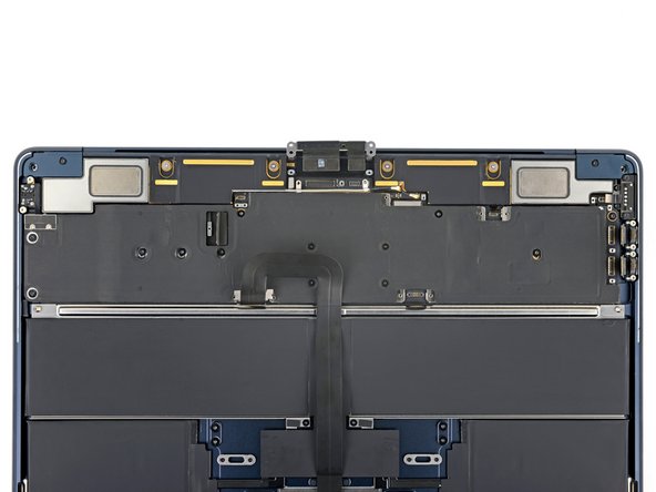

  30. MacBook Air 2022 (M2) Battery Replacement, Detach the battery cable: crwdns2935265:030crwdnd2935265:01crwdnd2935265:02crwdne2935265:0 MacBook Air 2022 (M2) Battery Replacement, Detach the battery cable: crwdns2935265:030crwdnd2935265:02crwdnd2935265:02crwdne2935265:0
    • A small amount of adhesive secures the right side of the battery cable to the frame.
    • Lift and detach the battery cable from the frame.

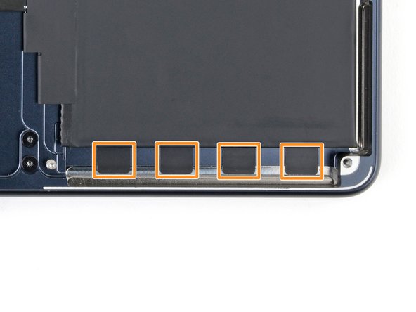

  32. MacBook Air 2022 (M2) Battery Replacement, Adhesive strip information: crwdns2935265:032crwdnd2935265:01crwdnd2935265:02crwdne2935265:0 MacBook Air 2022 (M2) Battery Replacement, Adhesive strip information: crwdns2935265:032crwdnd2935265:02crwdnd2935265:02crwdne2935265:0
    • The MacBook's battery cells are attached to a metal tray as a complete assembly. This tray is secured to the frame by eight stretch-release adhesive strips:
    • Four on the bottom left corner
    • Four on the bottom right corner

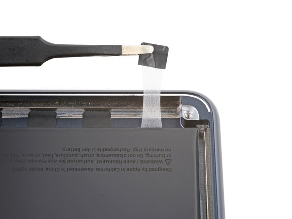

  33. MacBook Air 2022 (M2) Battery Replacement, Remove the stretch release adhesive: crwdns2935265:033crwdnd2935265:01crwdnd2935265:02crwdne2935265:0 MacBook Air 2022 (M2) Battery Replacement, Remove the stretch release adhesive: crwdns2935265:033crwdnd2935265:02crwdnd2935265:02crwdne2935265:0
    • Use a pair of tweezers to peel up the black pull tab on one of the stretch-release adhesive strips until you can grip it with your fingers.
    • Pull the strip out from under the battery at a shallow angle. Go very slow and use steady force, giving the strip plenty of time to stretch and unstick itself from under the battery tray.
    • You may have to re-grip the adhesive closer to the laptop and continue pulling multiple times—the adhesive will stretch a lot.
    • Pull the adhesive strip until it’s completely freed from underneath the battery tray.
    • Repeat for the seven remaining adhesive strips.

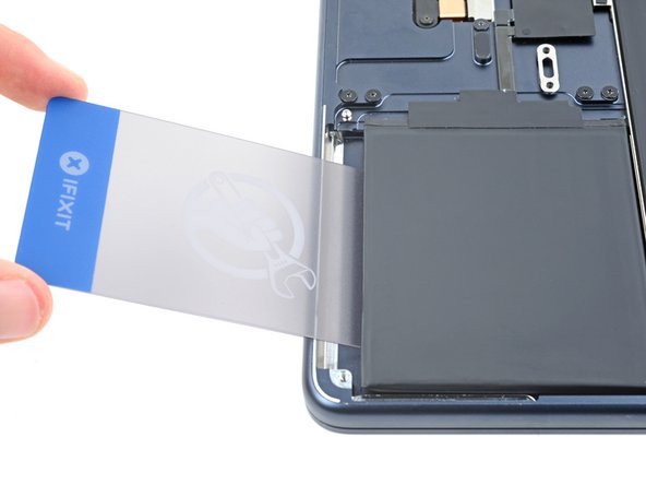

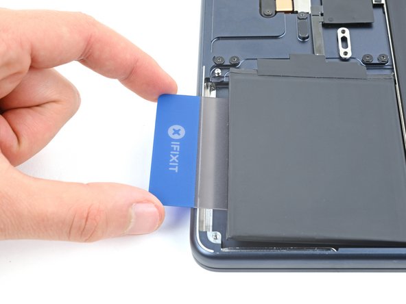

  34. MacBook Air 2022 (M2) Battery Replacement, Apply isopropyl alcohol: crwdns2935265:034crwdnd2935265:01crwdnd2935265:01crwdne2935265:0
    • If you removed all the stretch-release adhesive, congratulations! You can skip the next two steps. If any strips broke and the battery is still stuck in place, follow the next two steps to remove the remaining adhesive.
    • Apply a few drops of high concentration (greater than 90%) isopropyl alcohol between the edge of the frame and the battery where any adhesive strips remain.
    • Wait one minute for the isopropyl alcohol to soften the adhesive.
  35. MacBook Air 2022 (M2) Battery Replacement: crwdns2935265:035crwdnd2935265:01crwdnd2935265:03crwdne2935265:0 MacBook Air 2022 (M2) Battery Replacement: crwdns2935265:035crwdnd2935265:02crwdnd2935265:03crwdne2935265:0 MacBook Air 2022 (M2) Battery Replacement: crwdns2935265:035crwdnd2935265:03crwdnd2935265:03crwdne2935265:0
    Plastic Cards
    $2.99
    • Make sure your plastic card is underneath the battery tray, and not between the battery and the tray. Don’t attempt to remove the battery cells from the metal tray.
    • Insert a plastic card underneath the battery's metal tray.
    • Push the plastic card underneath the metal tray and slide it back and forth to slice the remaining adhesive. You may need to lift the battery cell to reach the adhesive.
    • If you're struggling to remove the remaining adhesive, apply more isopropyl alcohol and try again.

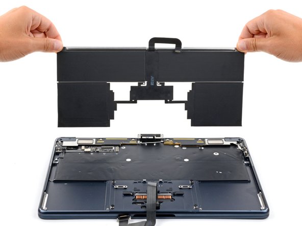

  36. MacBook Air 2022 (M2) Battery Replacement, Remove the battery: crwdns2935265:036crwdnd2935265:01crwdnd2935265:02crwdne2935265:0 MacBook Air 2022 (M2) Battery Replacement, Remove the battery: crwdns2935265:036crwdnd2935265:02crwdnd2935265:02crwdne2935265:0
    Stretch Release Battery Adhesive
    $3.99
    • Remove the battery assembly.
    • During reassembly:
    • Remove any remaining adhesive strips with tweezers or your fingers.
    • Clean up the adhesive residue with a few drops of isopropyl alcohol and a lint-free or microfiber cloth.
    • Before removing any adhesive liners, place the battery in its recess and make sure it fits.
    • If your replacement battery comes with adhesive, remove the plastic liners and firmly press each cell into place.
    • If your replacement battery doesn't come with adhesive, secure it with stretch-release adhesive.
    • Alternatively, you may use strong double-sided tape such as Tesa Tape to secure the battery.

Is is really necessary to remove the motherboard?
Looking at all the photos, it seems to me like the battery should be clear for removal after disconnecting it and the trackpad cable, leaving the motherboard (and all of its other connectors) in-place. So what am I missing here?
shamino - crwdns2934203:0crwdne2934203:0
Hi! The logic board is removed first because the battery cable runs underneath it and is adhered to the frame.
Spencer Day -
It is not necessary to remove the motherboard. The battery cable runs underneath the logicboard, but is not adhere to it. You can slide it out once the battery is loose.
just1ed -
I just replaced my own 2022 M2 Macbook Air's battery and can confirm that I was able to do this without removing the logic board.
