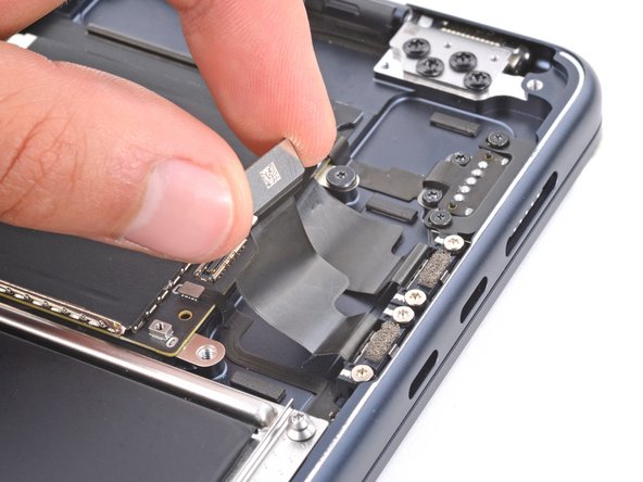

    • Use a 3IP Torx Plus screwdriver to remove the three 1.5 mm‑long screws securing the port connectors cover.
    • Remove the cover.

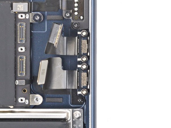

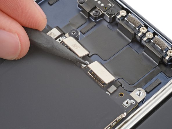

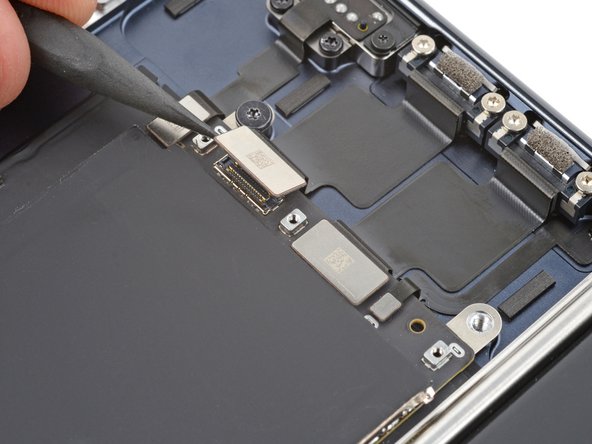

  19. MacBook Air 15" 2024 Thunderbolt Ports Replacement, Disconnect the Thunderbolt ports: crwdns2935265:019crwdnd2935265:01crwdnd2935265:03crwdne2935265:0 MacBook Air 15" 2024 Thunderbolt Ports Replacement, Disconnect the Thunderbolt ports: crwdns2935265:019crwdnd2935265:02crwdnd2935265:03crwdne2935265:0 MacBook Air 15" 2024 Thunderbolt Ports Replacement, Disconnect the Thunderbolt ports: crwdns2935265:019crwdnd2935265:03crwdnd2935265:03crwdne2935265:0
    • This guide shows how to replace both Thunderbolt ports. If you're replacing a single port, only perform each action on that port.
    • Use a spudger to pry up and disconnect the Thunderbolt port press connectors from the right edge of the logic board.

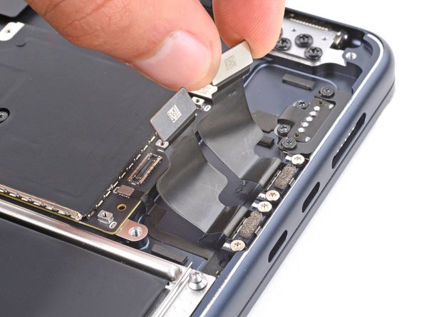

  20. MacBook Air 15" 2024 Thunderbolt Ports Replacement, Heat the Thunderbolt port cables: crwdns2935265:020crwdnd2935265:01crwdnd2935265:01crwdne2935265:0
    • The Thunderbolt port cables are strongly adhered to the frame.
    • Use a hair dryer to heat the cables and soften the adhesive securing them.

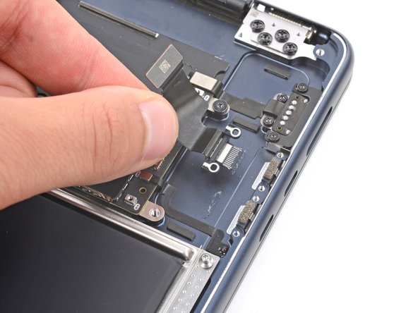

  21. MacBook Air 15" 2024 Thunderbolt Ports Replacement, Separate the cables adhesive: crwdns2935265:021crwdnd2935265:01crwdnd2935265:03crwdne2935265:0 MacBook Air 15" 2024 Thunderbolt Ports Replacement, Separate the cables adhesive: crwdns2935265:021crwdnd2935265:02crwdnd2935265:03crwdne2935265:0 MacBook Air 15" 2024 Thunderbolt Ports Replacement, Separate the cables adhesive: crwdns2935265:021crwdnd2935265:03crwdnd2935265:03crwdne2935265:0
    Tesa 61395 Tape
    $2.99
    • Slowly peel the Thunderbolt port cables from the frame to separate the adhesive securing them.
    • During reassembly:
    • If your new Thunderbolt ports come with adhesive on the cables, remove the plastic liners and press the cables into place on the frame.
    • If the cables don't have adhesive, use strips of double-sided tape to secure them to the frame.

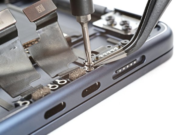

  22. MacBook Air 15" 2024 Thunderbolt Ports Replacement, Unfasten the Thunderbolt ports: crwdns2935265:022crwdnd2935265:01crwdnd2935265:03crwdne2935265:0 MacBook Air 15" 2024 Thunderbolt Ports Replacement, Unfasten the Thunderbolt ports: crwdns2935265:022crwdnd2935265:02crwdnd2935265:03crwdne2935265:0 MacBook Air 15" 2024 Thunderbolt Ports Replacement, Unfasten the Thunderbolt ports: crwdns2935265:022crwdnd2935265:03crwdnd2935265:03crwdne2935265:0
    $3.99
    • Use a 5IP Torx Plus screwdriver to remove the four 3.7 mm‑long screws securing the Thunderbolt ports.
    • During reassembly, the screws will be drawn toward the magnet in the MagSafe port. Use angled tweezers to hold the screws in place while tightening them.
  23. MacBook Air 15" 2024 Thunderbolt Ports Replacement, Remove the Thunderbolt ports: crwdns2935265:023crwdnd2935265:01crwdnd2935265:03crwdne2935265:0 MacBook Air 15" 2024 Thunderbolt Ports Replacement, Remove the Thunderbolt ports: crwdns2935265:023crwdnd2935265:02crwdnd2935265:03crwdne2935265:0 MacBook Air 15" 2024 Thunderbolt Ports Replacement, Remove the Thunderbolt ports: crwdns2935265:023crwdnd2935265:03crwdnd2935265:03crwdne2935265:0
    • Remove the Thunderbolt ports.
