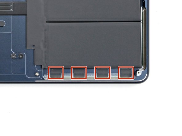

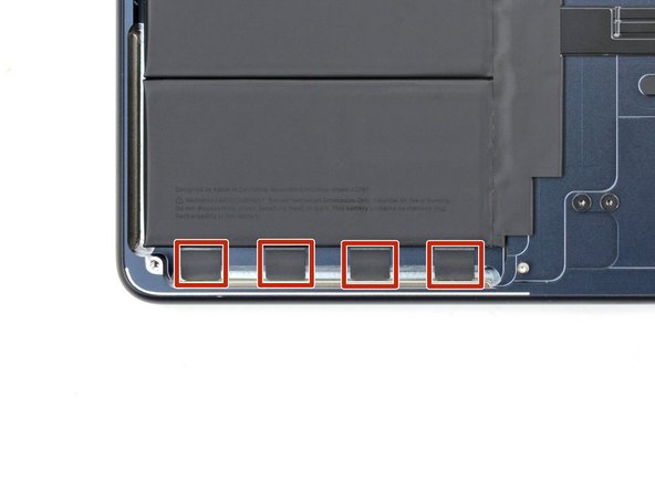

  18. MacBook Air 15" 2024 Battery Replacement, Battery adhesive information: crwdns2935265:018crwdnd2935265:01crwdnd2935265:03crwdne2935265:0 MacBook Air 15" 2024 Battery Replacement, Battery adhesive information: crwdns2935265:018crwdnd2935265:02crwdnd2935265:03crwdne2935265:0 MacBook Air 15" 2024 Battery Replacement, Battery adhesive information: crwdns2935265:018crwdnd2935265:03crwdnd2935265:03crwdne2935265:0
    • The MacBook's battery cells are adhered to a metal tray as a complete assembly.
    • The metal battery tray—not the actual cells—is secured to the frame by eight stretch-release adhesive strips on the bottom left and right edges of the MacBook.

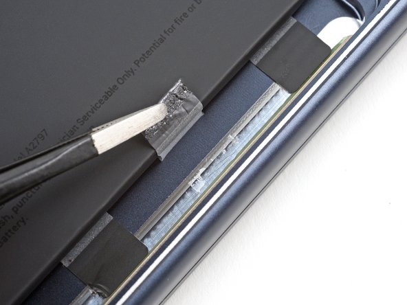

  19. MacBook Air 15" 2024 Battery Replacement, Peel up the stretch-release pull tabs: crwdns2935265:019crwdnd2935265:01crwdnd2935265:03crwdne2935265:0 MacBook Air 15" 2024 Battery Replacement, Peel up the stretch-release pull tabs: crwdns2935265:019crwdnd2935265:02crwdnd2935265:03crwdne2935265:0 MacBook Air 15" 2024 Battery Replacement, Peel up the stretch-release pull tabs: crwdns2935265:019crwdnd2935265:03crwdnd2935265:03crwdne2935265:0
    • Use the point of a spudger and tweezers to separate and peel up the eight pull tabs.
    • Don't pull on the tabs yet.

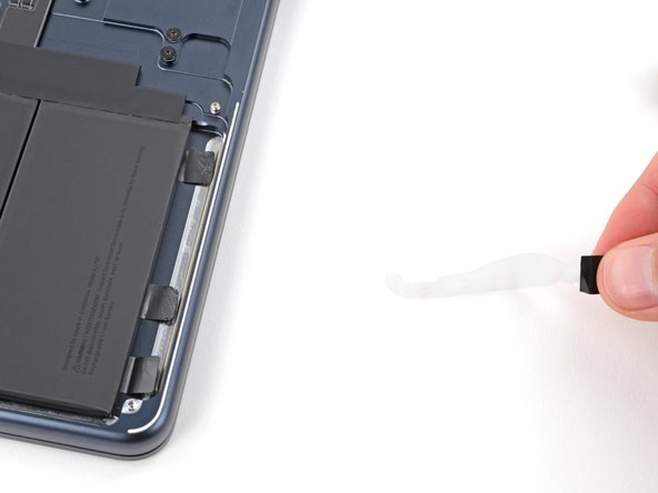

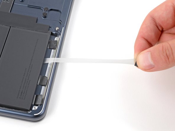

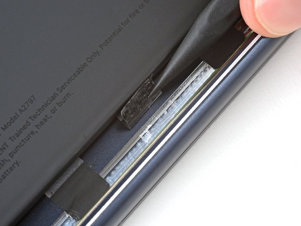

  20. MacBook Air 15" 2024 Battery Replacement, Remove the stretch-release adhesive: crwdns2935265:020crwdnd2935265:01crwdnd2935265:03crwdne2935265:0 MacBook Air 15" 2024 Battery Replacement, Remove the stretch-release adhesive: crwdns2935265:020crwdnd2935265:02crwdnd2935265:03crwdne2935265:0 MacBook Air 15" 2024 Battery Replacement, Remove the stretch-release adhesive: crwdns2935265:020crwdnd2935265:03crwdnd2935265:03crwdne2935265:0
    • It takes time and constant tension to release the adhesive strips. Be patient and don't yank on them.
    • Don't let the strips touch the bottom edge of the frame—it's sharp and can easily cut them.
    • Use your fingers to slowly pull each strip out at a low angle, giving the adhesive plenty of time to stretch and detach.
    • Re-grip the strip closer to the battery as necessary and continue pulling—the adhesive will stretch a lot.
    • If a strip or its pull tab breaks off, use blunt nose tweezers to try to retrieve it from under the tray. If you can't reach it, move onto the next tab.

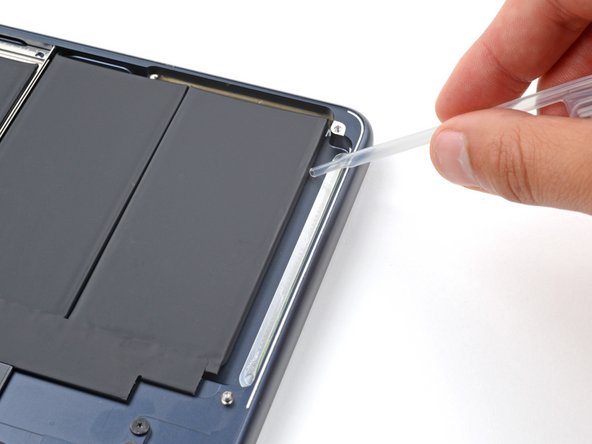

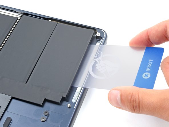

  21. MacBook Air 15" 2024 Battery Replacement, Separate any remaining adhesive: crwdns2935265:021crwdnd2935265:01crwdnd2935265:02crwdne2935265:0 MacBook Air 15" 2024 Battery Replacement, Separate any remaining adhesive: crwdns2935265:021crwdnd2935265:02crwdnd2935265:02crwdne2935265:0
    • If you successfully removed all eight strips of adhesive, congratulations! Skip down two steps. If any of the strips broke and you weren't able to retrieve them, follow the next two steps to separate the remaining adhesive.
    • Apply a few drops of highly-concentrated isopropyl alcohol (over 90%) under the battery tray near the broken adhesive strips.
    • Wait one minute for the alcohol to soften the adhesive.
  22. MacBook Air 15" 2024 Battery Replacement: crwdns2935265:022crwdnd2935265:01crwdnd2935265:03crwdne2935265:0 MacBook Air 15" 2024 Battery Replacement: crwdns2935265:022crwdnd2935265:02crwdnd2935265:03crwdne2935265:0 MacBook Air 15" 2024 Battery Replacement: crwdns2935265:022crwdnd2935265:03crwdnd2935265:03crwdne2935265:0
    Plastic Cards
    $2.99

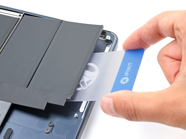

    • Make sure your plastic card is underneath the battery tray itself, and not between a battery cell and the tray. Don’t attempt to remove any battery cells from the metal tray.
    • Insert a plastic card underneath the battery's metal tray where the adhesive strip broke off.
    • Slide the plastic card completely under the battery tray and lift to separate any remaining adhesive.

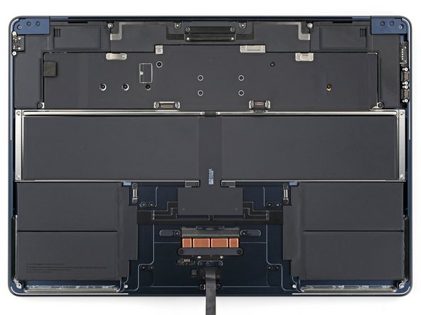

  23. MacBook Air 15" 2024 Battery Replacement, Remove the battery: crwdns2935265:023crwdnd2935265:01crwdnd2935265:03crwdne2935265:0 MacBook Air 15" 2024 Battery Replacement, Remove the battery: crwdns2935265:023crwdnd2935265:02crwdnd2935265:03crwdne2935265:0 MacBook Air 15" 2024 Battery Replacement, Remove the battery: crwdns2935265:023crwdnd2935265:03crwdnd2935265:03crwdne2935265:0
    Stretch Release Battery Adhesive
    $3.99
    • Lift the battery and pull it towards the bottom of your laptop so the battery cable slides out from under the logic board.
    • Remove the battery.
    • During reassembly:
    • Remove any remaining adhesive from the frame and clean up the residue with a few drops of isopropyl alcohol and a microfiber cloth.
    • Before removing any adhesive liners, place the battery in its recess and make sure it fits.
    • When installing a new battery, make sure you slide its cable under the logic board before securing the battery.
    • If your replacement battery comes with adhesive, remove the plastic liners and firmly press each cell into place.
    • If your replacement battery doesn't come with adhesive, secure it with stretch-release adhesive or double-sided tape.
