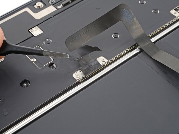

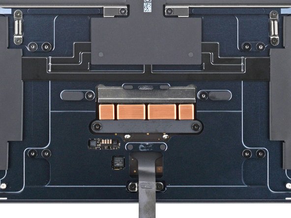

  11. MacBook Air 15" 2023 Trackpad Replacement, Remove the trackpad cable tape: crwdns2935265:011crwdnd2935265:01crwdnd2935265:02crwdne2935265:0 MacBook Air 15" 2023 Trackpad Replacement, Remove the trackpad cable tape: crwdns2935265:011crwdnd2935265:02crwdnd2935265:02crwdne2935265:0
    • A small piece of black tape hides two trackpad cable cover screws.
    • Use tweezers or your fingers to remove the tape from the trackpad cable.
    • During reassembly, use the leftover adhesive to secure the tape to the cover.

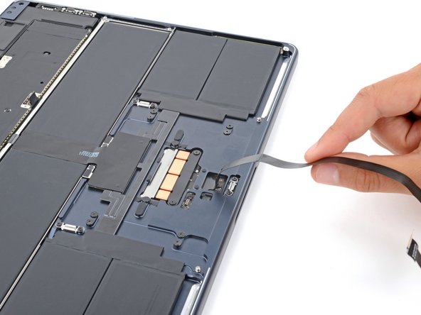

  12. MacBook Air 15" 2023 Trackpad Replacement, Separate the trackpad cable adhesive: crwdns2935265:012crwdnd2935265:01crwdnd2935265:02crwdne2935265:0 MacBook Air 15" 2023 Trackpad Replacement, Separate the trackpad cable adhesive: crwdns2935265:012crwdnd2935265:02crwdnd2935265:02crwdne2935265:0
    Tesa 61395 Tape
    $2.99
    • Light adhesive secures the trackpad cable to its metal cover.
    • Pull the trackpad cable away from its cover to separate the adhesive securing it.

  13. MacBook Air 15" 2023 Trackpad Replacement, Remove the trackpad cable cover: crwdns2935265:013crwdnd2935265:01crwdnd2935265:02crwdne2935265:0 MacBook Air 15" 2023 Trackpad Replacement, Remove the trackpad cable cover: crwdns2935265:013crwdnd2935265:02crwdnd2935265:02crwdne2935265:0
    • Use a 3IP Torx screwdriver to remove the two 1.5 mm‑long screws securing the trackpad cable cover.
    • Remove the cover.

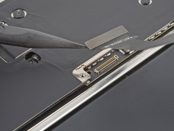

  14. MacBook Air 15" 2023 Trackpad Replacement, Disconnect the trackpad cable: crwdns2935265:014crwdnd2935265:01crwdnd2935265:02crwdne2935265:0 MacBook Air 15" 2023 Trackpad Replacement, Disconnect the trackpad cable: crwdns2935265:014crwdnd2935265:02crwdnd2935265:02crwdne2935265:0
    • Use the point of a spudger to pry up and disconnect the trackpad cable press connector from the logic board.

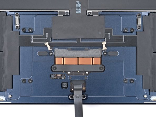

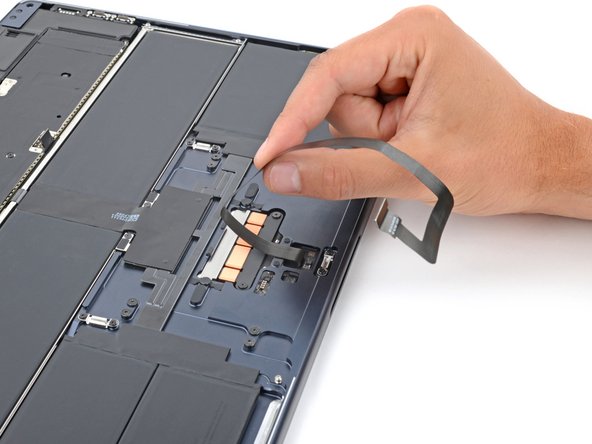

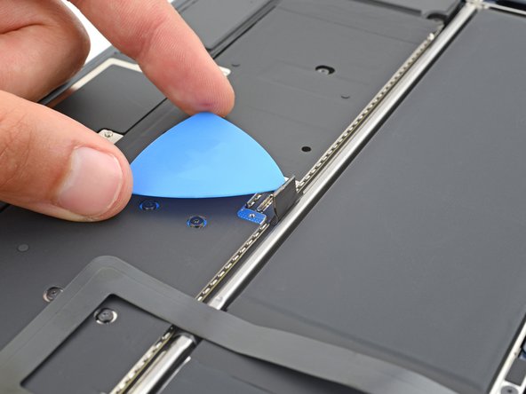

  15. MacBook Air 15" 2023 Trackpad Replacement, Heat the trackpad cable: crwdns2935265:015crwdnd2935265:01crwdnd2935265:02crwdne2935265:0 MacBook Air 15" 2023 Trackpad Replacement, Heat the trackpad cable: crwdns2935265:015crwdnd2935265:02crwdnd2935265:02crwdne2935265:0
    • Two small strips of adhesive secure the trackpad cable to the frame.
    • Heat an iOpener and apply it to the trackpad cable for two minutes to soften the adhesive securing it to the frame.
    • You can also use a hair dryer—but extreme heat can damage the battery, so proceed with care.

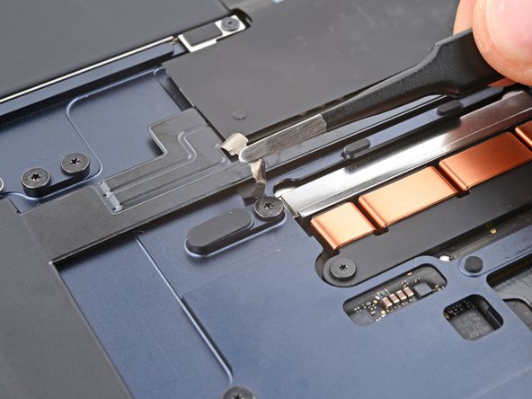

  16. MacBook Air 15" 2023 Trackpad Replacement, Separate the trackpad cable adhesive: crwdns2935265:016crwdnd2935265:01crwdnd2935265:03crwdne2935265:0 MacBook Air 15" 2023 Trackpad Replacement, Separate the trackpad cable adhesive: crwdns2935265:016crwdnd2935265:02crwdnd2935265:03crwdne2935265:0 MacBook Air 15" 2023 Trackpad Replacement, Separate the trackpad cable adhesive: crwdns2935265:016crwdnd2935265:03crwdnd2935265:03crwdne2935265:0
    Tesa 61395 Tape
    $2.99
    • Pull the trackpad cable toward the bottom of the MacBook to separate it from the frame.

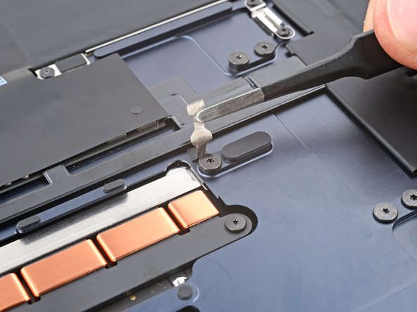

  17. MacBook Air 15" 2023 Trackpad Replacement, Expose the trackpad screws: crwdns2935265:017crwdnd2935265:01crwdnd2935265:03crwdne2935265:0 MacBook Air 15" 2023 Trackpad Replacement, Expose the trackpad screws: crwdns2935265:017crwdnd2935265:02crwdnd2935265:03crwdne2935265:0 MacBook Air 15" 2023 Trackpad Replacement, Expose the trackpad screws: crwdns2935265:017crwdnd2935265:03crwdnd2935265:03crwdne2935265:0
    • Small pieces of tape cover two trackpad screws.
    • Use blunt nose tweezers to gently peel the tape from the screws.

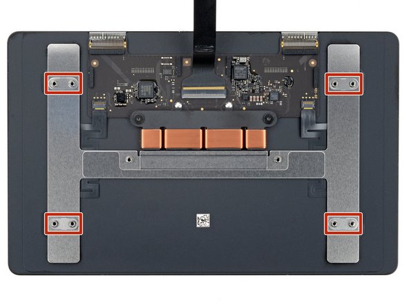

  18. MacBook Air 15" 2023 Trackpad Replacement, Unfasten the trackpad: crwdns2935265:018crwdnd2935265:01crwdnd2935265:02crwdne2935265:0 MacBook Air 15" 2023 Trackpad Replacement, Unfasten the trackpad: crwdns2935265:018crwdnd2935265:02crwdnd2935265:02crwdne2935265:0
    • Use a 5IP Torx Plus screwdriver to remove the ten 4 mm‑long screws securing the trackpad.

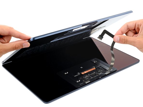

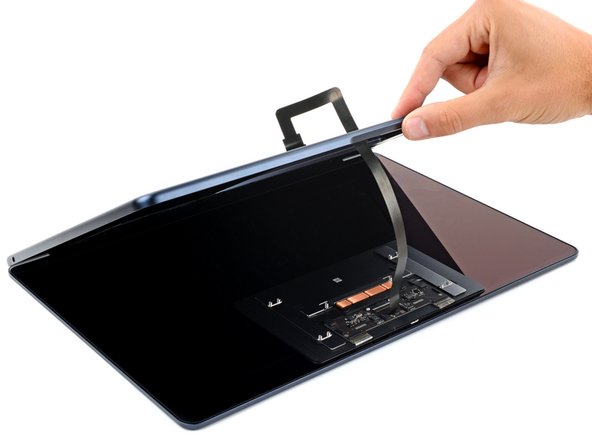

  19. MacBook Air 15" 2023 Trackpad Replacement, Remove the trackpad: crwdns2935265:019crwdnd2935265:01crwdnd2935265:03crwdne2935265:0 MacBook Air 15" 2023 Trackpad Replacement, Remove the trackpad: crwdns2935265:019crwdnd2935265:02crwdnd2935265:03crwdne2935265:0 MacBook Air 15" 2023 Trackpad Replacement, Remove the trackpad: crwdns2935265:019crwdnd2935265:03crwdnd2935265:03crwdne2935265:0
    • Be careful not to lose the four washers resting on the trackpad's screw posts. Without them, your trackpad won't fit properly.
    • Slowly open your MacBook—the trackpad will stay on the display.
    • Guide the trackpad cable through its slot in the frame.

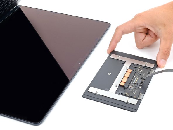

  20. MacBook Air 15" 2023 Trackpad Replacement: crwdns2935265:020crwdnd2935265:01crwdnd2935265:03crwdne2935265:0 MacBook Air 15" 2023 Trackpad Replacement: crwdns2935265:020crwdnd2935265:02crwdnd2935265:03crwdne2935265:0 MacBook Air 15" 2023 Trackpad Replacement: crwdns2935265:020crwdnd2935265:03crwdnd2935265:03crwdne2935265:0
    • Remove the trackpad from the display.
    • Reassembly note:
    • Before installing your new trackpad, make sure all four washers are in place.

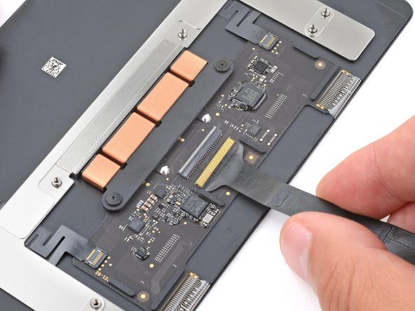

  21. MacBook Air 15" 2023 Trackpad Replacement, Transfer the trackpad cable: crwdns2935265:021crwdnd2935265:01crwdnd2935265:02crwdne2935265:0 MacBook Air 15" 2023 Trackpad Replacement, Transfer the trackpad cable: crwdns2935265:021crwdnd2935265:02crwdnd2935265:02crwdne2935265:0
    Tesa 61395 Tape
    $2.99

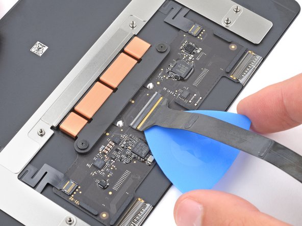

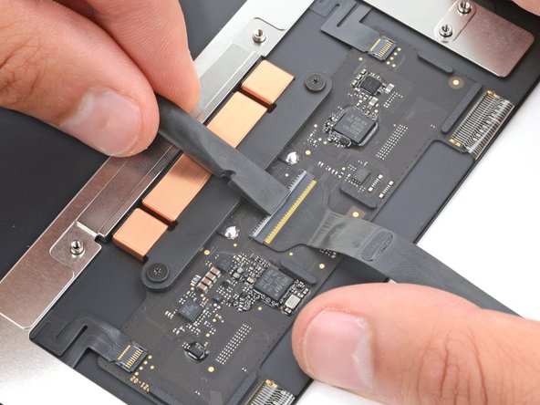

    • Before installing your trackpad, make sure it has a cable installed. If your new trackpad doesn't come with a cable, follow the next three steps to remove and transfer the old cable.
    • Use the tip of a spudger or a clean fingernail to flip up the hinged locking flap on the trackpad cable ZIF connector.
    • During reassembly:
    • Secure the cable by flipping the locking flap down.
    • If your trackpad cable comes with adhesive, remove the plastic liner and press the cable into place on the trackpad.
    • If the cable doesn't have adhesive, use a strip of double-sided tape to secure it to the trackpad.
  22. MacBook Air 15" 2023 Trackpad Replacement: crwdns2935265:022crwdnd2935265:01crwdnd2935265:01crwdne2935265:0
    • Strong adhesive secures the trackpad cable to the trackpad, just below the cable's connector.
    • Heat an iOpener and apply it to the bottom edge of the trackpad for two minutes to soften the adhesive.
    • Alternatively, you can use a hair dryer to heat the cable.
  23. MacBook Air 15" 2023 Trackpad Replacement: crwdns2935265:023crwdnd2935265:01crwdnd2935265:03crwdne2935265:0 MacBook Air 15" 2023 Trackpad Replacement: crwdns2935265:023crwdnd2935265:02crwdnd2935265:03crwdne2935265:0 MacBook Air 15" 2023 Trackpad Replacement: crwdns2935265:023crwdnd2935265:03crwdnd2935265:03crwdne2935265:0
    • Slide an opening pick back and forth under the trackpad cable to separate it from the trackpad.
    • Pull the trackpad cable out of its socket and remove it.
    • During reassembly, make sure the locking flap is flipped up before inserting the trackpad cable into its socket.
