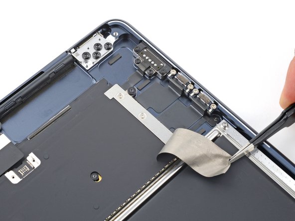

  17. MacBook Air 15" 2023 MagSafe Port Replacement, Remove the right ports cover: crwdns2935265:017crwdnd2935265:01crwdnd2935265:02crwdne2935265:0 MacBook Air 15" 2023 MagSafe Port Replacement, Remove the right ports cover: crwdns2935265:017crwdnd2935265:02crwdnd2935265:02crwdne2935265:0
    • A piece of tape on the right edge of the logic board hides the MagSafe and Thunderbolt port connectors cover.
    • Use blunt nose tweezers or your fingers to peel up and remove the tape.
    • During reassembly, use the leftover adhesive to secure the tape to the cover.

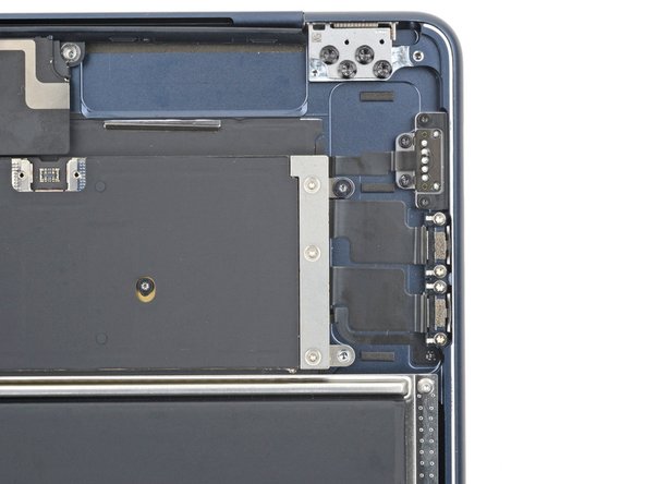

  18. MacBook Air 15" 2023 MagSafe Port Replacement: crwdns2935265:018crwdnd2935265:01crwdnd2935265:03crwdne2935265:0 MacBook Air 15" 2023 MagSafe Port Replacement: crwdns2935265:018crwdnd2935265:02crwdnd2935265:03crwdne2935265:0 MacBook Air 15" 2023 MagSafe Port Replacement: crwdns2935265:018crwdnd2935265:03crwdnd2935265:03crwdne2935265:0
    • Use a 3IP Torx Plus screwdriver to remove the three 1.5 mm‑long screws securing the port connectors cover.
    • Remove the cover.

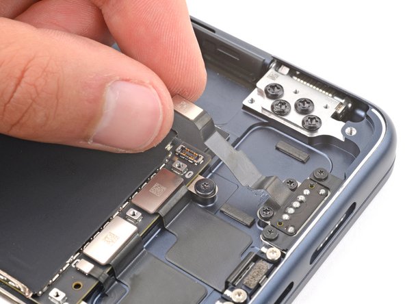

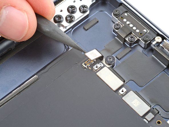

  19. MacBook Air 15" 2023 MagSafe Port Replacement, Disconnect the MagSafe port: crwdns2935265:019crwdnd2935265:01crwdnd2935265:02crwdne2935265:0 MacBook Air 15" 2023 MagSafe Port Replacement, Disconnect the MagSafe port: crwdns2935265:019crwdnd2935265:02crwdnd2935265:02crwdne2935265:0
    • Use a spudger to pry up and disconnect the MagSafe port press connector.

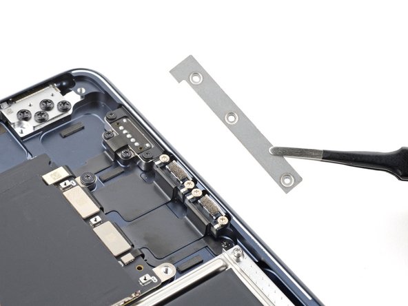

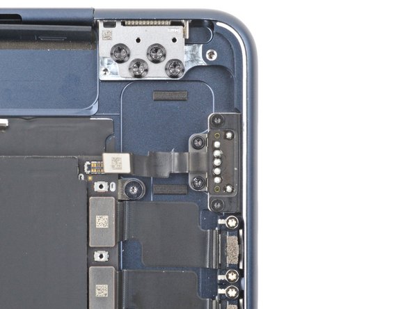

  21. MacBook Air 15" 2023 MagSafe Port Replacement, Unfasten the MagSafe port: crwdns2935265:021crwdnd2935265:01crwdnd2935265:02crwdne2935265:0 MacBook Air 15" 2023 MagSafe Port Replacement, Unfasten the MagSafe port: crwdns2935265:021crwdnd2935265:02crwdnd2935265:02crwdne2935265:0
    • Use a 3IP Torx Plus screwdriver to remove the two 3.3 mm‑long screws securing the metal wedge to the MagSafe port.
    • This wedge keeps the port secure in its recess.
    • Use a 5IP Torx Plus screwdriver to remove the two 2.7 mm‑long screws securing the MagSafe port to the frame.
  22. MacBook Air 15" 2023 MagSafe Port Replacement, Remove the wedge: crwdns2935265:022crwdnd2935265:01crwdnd2935265:01crwdne2935265:0
    • Remove the wedge from the top of the MagSafe port.

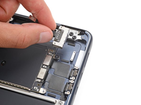

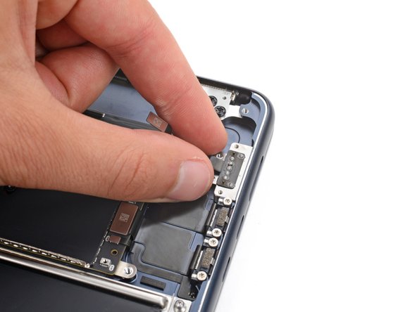

  23. MacBook Air 15" 2023 MagSafe Port Replacement, Remove the MagSafe port: crwdns2935265:023crwdnd2935265:01crwdnd2935265:02crwdne2935265:0 MacBook Air 15" 2023 MagSafe Port Replacement, Remove the MagSafe port: crwdns2935265:023crwdnd2935265:02crwdnd2935265:02crwdne2935265:0
    • Remove the MagSafe port.
  24. MacBook Air 15" 2023 MagSafe Port Replacement, Install your MagSafe port: crwdns2935265:024crwdnd2935265:01crwdnd2935265:02crwdne2935265:0 MacBook Air 15" 2023 MagSafe Port Replacement, Install your MagSafe port: crwdns2935265:024crwdnd2935265:02crwdnd2935265:02crwdne2935265:0
    $3.99
    • Follow this step to install your MagSafe port.
    • The screws will be drawn toward the magnet in the port. You may need to use angled tweezers to hold the screws in place while tightening them.
    • Insert the port and use a 3IP Torx plus screwdriver to partially tighten the two 2.7 mm‑long screws that secure the port's left edge.
    • Properly align the port and fully tighten its screws.
    • You can plug your charger in and use it to align the port, but make sure it's not plugged into power.
    • Put the wedge into place on top of the MagSafe port and use a 5IP Torx Plus screwdriver to partially tighten the two 3.3 mm‑long screws.
    • Push the wedge under the lip of the frame and fully tighten its screws.
