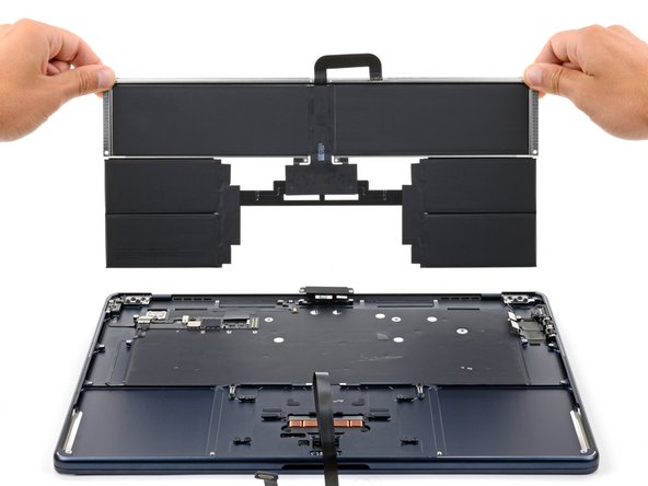

MacBook Air 15" 2023 Battery Replacement

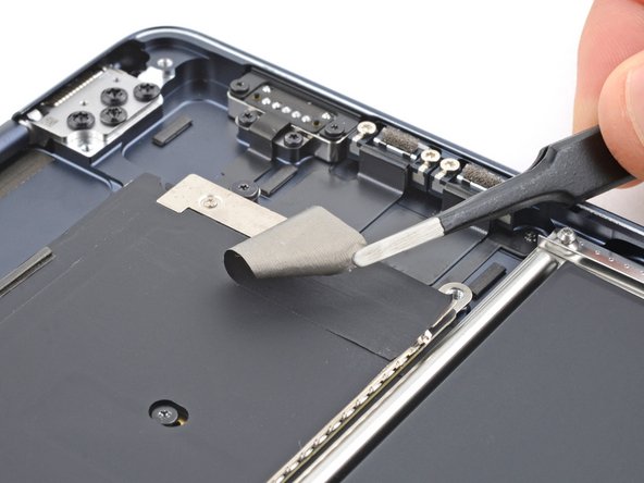

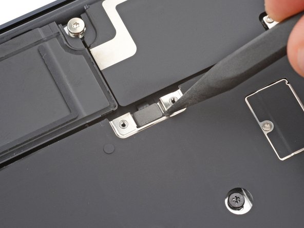

  8. MacBook Air 15" 2023 Battery Replacement, Remove the battery connector cover tape: crwdns2935265:08crwdnd2935265:01crwdnd2935265:03crwdne2935265:0 MacBook Air 15" 2023 Battery Replacement, Remove the battery connector cover tape: crwdns2935265:08crwdnd2935265:02crwdnd2935265:03crwdne2935265:0 MacBook Air 15" 2023 Battery Replacement, Remove the battery connector cover tape: crwdns2935265:08crwdnd2935265:03crwdnd2935265:03crwdne2935265:0
    • Use blunt nose tweezers or your fingers to remove the piece of tape covering the battery connector cover.
    • During reassembly, use the leftover adhesive to secure the tape to the cover.
  9. MacBook Air 15" 2023 Battery Replacement, Remove the battery connector cover: crwdns2935265:09crwdnd2935265:01crwdnd2935265:03crwdne2935265:0 MacBook Air 15" 2023 Battery Replacement, Remove the battery connector cover: crwdns2935265:09crwdnd2935265:02crwdnd2935265:03crwdne2935265:0 MacBook Air 15" 2023 Battery Replacement, Remove the battery connector cover: crwdns2935265:09crwdnd2935265:03crwdnd2935265:03crwdne2935265:0
    • Use a 3IP Torx Plus screwdriver to remove the two 1.5 mm‑long screws securing the battery connector cover.
    • Remove the cover.

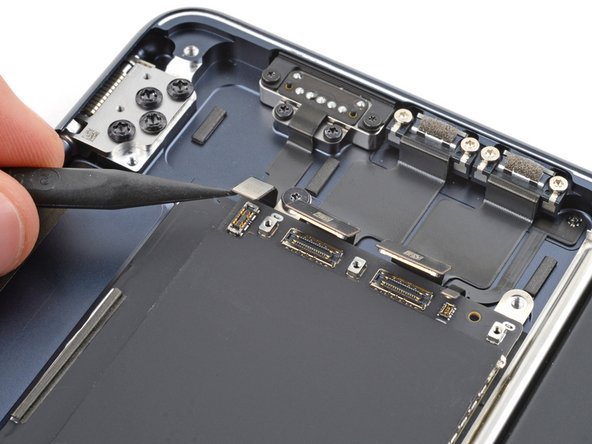

  10. MacBook Air 15" 2023 Battery Replacement, Disconnect the battery: crwdns2935265:010crwdnd2935265:01crwdnd2935265:02crwdne2935265:0 MacBook Air 15" 2023 Battery Replacement, Disconnect the battery: crwdns2935265:010crwdnd2935265:02crwdnd2935265:02crwdne2935265:0
    • Use an opening pick to pry up and disconnect the battery connector.
    • To reconnect a press connector, align it over the socket and gently press down on one side until it clicks into place, then press down on the other side. It might take a few tries to align the connector.

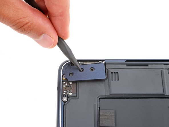

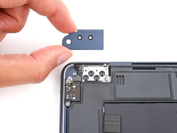

  12. MacBook Air 15" 2023 Battery Replacement, Remove the covers: crwdns2935265:012crwdnd2935265:01crwdnd2935265:01crwdne2935265:0
    • Remove the speaker cable cover.
  13. MacBook Air 15" 2023 Battery Replacement: crwdns2935265:013crwdnd2935265:01crwdnd2935265:03crwdne2935265:0 MacBook Air 15" 2023 Battery Replacement: crwdns2935265:013crwdnd2935265:02crwdnd2935265:03crwdne2935265:0 MacBook Air 15" 2023 Battery Replacement: crwdns2935265:013crwdnd2935265:03crwdnd2935265:03crwdne2935265:0
    • Insert the point of a spudger into one of the left hinge cover's screw holes.
    • Push the hinge cover away from the back edge to dislodge it.
    • Remove the hinge cover.

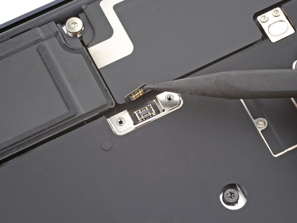

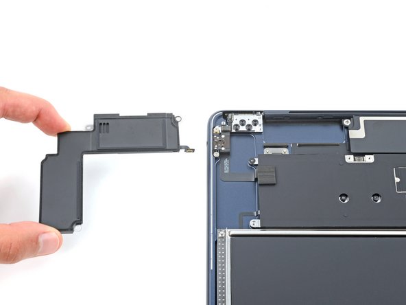

  14. MacBook Air 15" 2023 Battery Replacement, Disconnect the right speaker: crwdns2935265:014crwdnd2935265:01crwdnd2935265:03crwdne2935265:0 MacBook Air 15" 2023 Battery Replacement, Disconnect the right speaker: crwdns2935265:014crwdnd2935265:02crwdnd2935265:03crwdne2935265:0 MacBook Air 15" 2023 Battery Replacement, Disconnect the right speaker: crwdns2935265:014crwdnd2935265:03crwdnd2935265:03crwdne2935265:0
    • Use the point of a spudger to pry up and disconnect the right speaker press connector.
  15. MacBook Air 15" 2023 Battery Replacement, Unfasten the right speaker: crwdns2935265:015crwdnd2935265:01crwdnd2935265:02crwdne2935265:0 MacBook Air 15" 2023 Battery Replacement, Unfasten the right speaker: crwdns2935265:015crwdnd2935265:02crwdnd2935265:02crwdne2935265:0
    • Remove the three screws securing the right speaker:
    • One 5.5 mm‑long 4IP Torx Plus screw
    • One 2.7 mm‑long 4IP Torx Plus screw
    • One 3.5 mm‑long 6IP Torx Plus screw
  16. MacBook Air 15" 2023 Battery Replacement, Remove the right speaker: crwdns2935265:016crwdnd2935265:01crwdnd2935265:03crwdne2935265:0 MacBook Air 15" 2023 Battery Replacement, Remove the right speaker: crwdns2935265:016crwdnd2935265:02crwdnd2935265:03crwdne2935265:0 MacBook Air 15" 2023 Battery Replacement, Remove the right speaker: crwdns2935265:016crwdnd2935265:03crwdnd2935265:03crwdne2935265:0
    • Make sure the cable on the top right edge of the speaker doesn't get caught on the logic board, as it may tear.
    • Lift the speaker's left edge over the frame and slide it to the left to remove it.
    • During reassembly, slide the speaker cable under the left edge of the antenna bar assembly before laying the speaker in its recess.

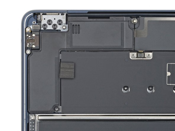

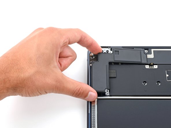

  20. MacBook Air 15" 2023 Battery Replacement, Disconnect the left speaker: crwdns2935265:020crwdnd2935265:01crwdnd2935265:03crwdne2935265:0 MacBook Air 15" 2023 Battery Replacement, Disconnect the left speaker: crwdns2935265:020crwdnd2935265:02crwdnd2935265:03crwdne2935265:0 MacBook Air 15" 2023 Battery Replacement, Disconnect the left speaker: crwdns2935265:020crwdnd2935265:03crwdnd2935265:03crwdne2935265:0
    • Use the point of a spudger to pry up and disconnect the left speaker press connector.
  21. MacBook Air 15" 2023 Battery Replacement, Unfasten the left speaker: crwdns2935265:021crwdnd2935265:01crwdnd2935265:02crwdne2935265:0 MacBook Air 15" 2023 Battery Replacement, Unfasten the left speaker: crwdns2935265:021crwdnd2935265:02crwdnd2935265:02crwdne2935265:0
  22. MacBook Air 15" 2023 Battery Replacement, Remove the left speaker: crwdns2935265:022crwdnd2935265:01crwdnd2935265:03crwdne2935265:0 MacBook Air 15" 2023 Battery Replacement, Remove the left speaker: crwdns2935265:022crwdnd2935265:02crwdnd2935265:03crwdne2935265:0 MacBook Air 15" 2023 Battery Replacement, Remove the left speaker: crwdns2935265:022crwdnd2935265:03crwdnd2935265:03crwdne2935265:0
    • Make sure the cable on the top left edge of the speaker doesn't get caught on the logic board, as it may tear.
    • Lift the speaker's right edge over the frame and slide it to the right to remove it.
    • During reassembly, slide the speaker cable under the right edge of the antenna bar assembly before laying the speaker in its recess.

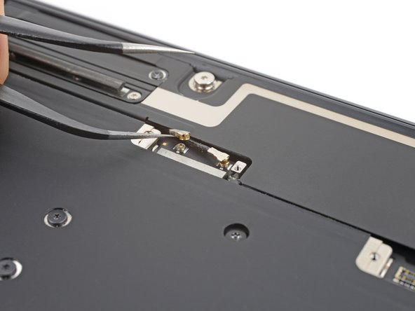

  23. MacBook Air 15" 2023 Battery Replacement, Remove the antenna cables cover: crwdns2935265:023crwdnd2935265:01crwdnd2935265:03crwdne2935265:0 MacBook Air 15" 2023 Battery Replacement, Remove the antenna cables cover: crwdns2935265:023crwdnd2935265:02crwdnd2935265:03crwdne2935265:0 MacBook Air 15" 2023 Battery Replacement, Remove the antenna cables cover: crwdns2935265:023crwdnd2935265:03crwdnd2935265:03crwdne2935265:0
    • Use a 3IP Torx Plus screwdriver to remove the two 1.5 mm‑long screws securing the antenna cables cover.
    • Remove the cover.

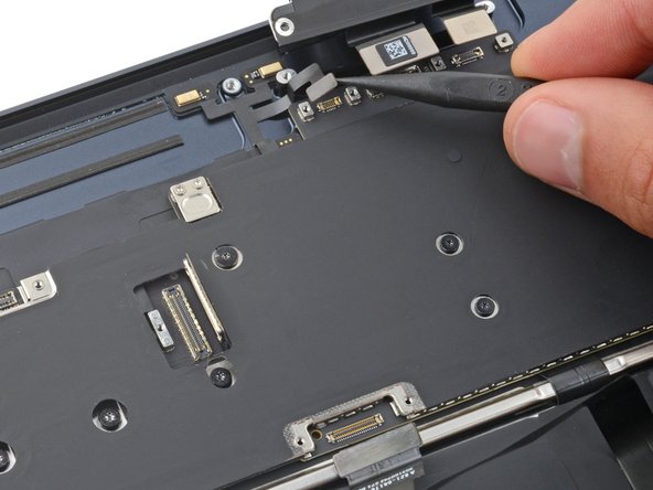

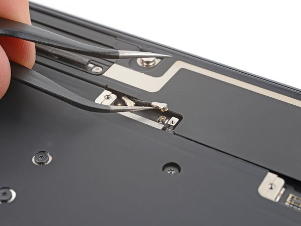

  24. MacBook Air 15" 2023 Battery Replacement, Disconnect the antenna bar: crwdns2935265:024crwdnd2935265:01crwdnd2935265:03crwdne2935265:0 MacBook Air 15" 2023 Battery Replacement, Disconnect the antenna bar: crwdns2935265:024crwdnd2935265:02crwdnd2935265:03crwdne2935265:0 MacBook Air 15" 2023 Battery Replacement, Disconnect the antenna bar: crwdns2935265:024crwdnd2935265:03crwdnd2935265:03crwdne2935265:0
    $3.99
    • Insert one arm of a pair of angled tweezers under the metal neck of one of the antenna connectors and lift straight up to disconnect it.
    • Disconnect the other antenna.
    • To reconnect antenna connectors, hold each one in place over its socket and press down with the flat end of your spudger. The connector will snap into place.

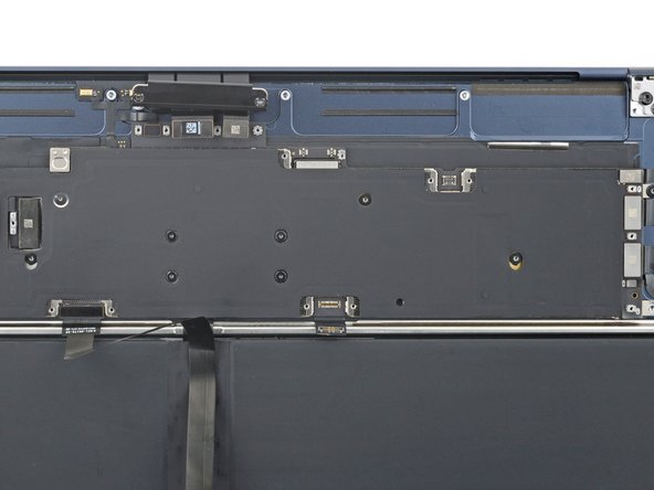

  29. MacBook Air 15" 2023 Battery Replacement, Disconnect the display and camera: crwdns2935265:029crwdnd2935265:01crwdnd2935265:03crwdne2935265:0 MacBook Air 15" 2023 Battery Replacement, Disconnect the display and camera: crwdns2935265:029crwdnd2935265:02crwdnd2935265:03crwdne2935265:0 MacBook Air 15" 2023 Battery Replacement, Disconnect the display and camera: crwdns2935265:029crwdnd2935265:03crwdnd2935265:03crwdne2935265:0
    • Use a spudger to pry up and disconnect the display and camera cable press connectors.
  30. MacBook Air 15" 2023 Battery Replacement, Reassembly information: crwdns2935265:030crwdnd2935265:01crwdnd2935265:03crwdne2935265:0 MacBook Air 15" 2023 Battery Replacement, Reassembly information: crwdns2935265:030crwdnd2935265:02crwdnd2935265:03crwdne2935265:0 MacBook Air 15" 2023 Battery Replacement, Reassembly information: crwdns2935265:030crwdnd2935265:03crwdnd2935265:03crwdne2935265:0
    • During reassembly, use the flat end of a spudger to gently push the display and camera cables under the logic board.

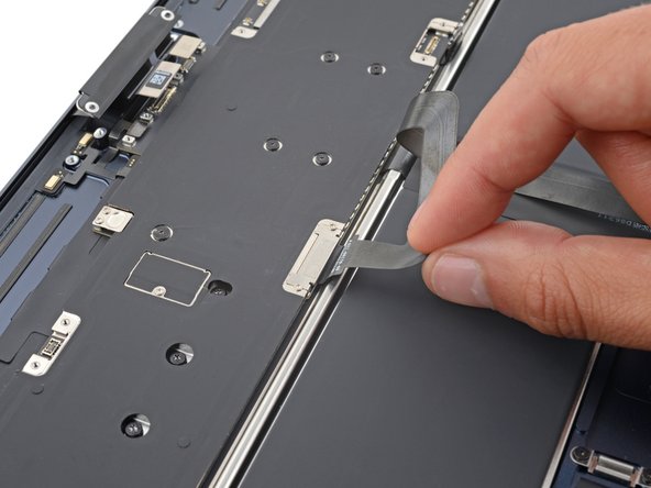

  33. MacBook Air 15" 2023 Battery Replacement, Separate the trackpad cable adhesive: crwdns2935265:033crwdnd2935265:01crwdnd2935265:02crwdne2935265:0 MacBook Air 15" 2023 Battery Replacement, Separate the trackpad cable adhesive: crwdns2935265:033crwdnd2935265:02crwdnd2935265:02crwdne2935265:0
    Tesa 61395 Tape
    $2.99
    • Light adhesive secures the trackpad cable to its metal cover.
    • Pull the trackpad cable away from its cover to separate the adhesive securing it.
    • During reassembly, use the leftover adhesive to secure the trackpad cable to the cover. If the cable doesn't stick, use double-sided tape to secure it.

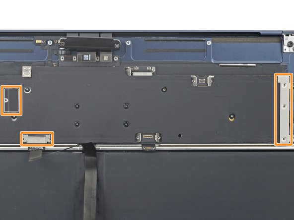

  34. MacBook Air 15" 2023 Battery Replacement, Remove the connector covers: crwdns2935265:034crwdnd2935265:01crwdnd2935265:03crwdne2935265:0 MacBook Air 15" 2023 Battery Replacement, Remove the connector covers: crwdns2935265:034crwdnd2935265:02crwdnd2935265:03crwdne2935265:0 MacBook Air 15" 2023 Battery Replacement, Remove the connector covers: crwdns2935265:034crwdnd2935265:03crwdnd2935265:03crwdne2935265:0
    • Use a 3IP Torx Plus screwdriver to remove the six 1.5 mm‑long screws securing the interconnect, trackpad, and MagSafe/Thunderbolt connector covers.
    • Remove the three connector covers.

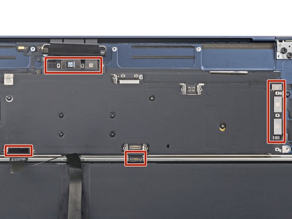

  35. MacBook Air 15" 2023 Battery Replacement, Disconnect the logic board cables: crwdns2935265:035crwdnd2935265:01crwdnd2935265:03crwdne2935265:0 MacBook Air 15" 2023 Battery Replacement, Disconnect the logic board cables: crwdns2935265:035crwdnd2935265:02crwdnd2935265:03crwdne2935265:0 MacBook Air 15" 2023 Battery Replacement, Disconnect the logic board cables: crwdns2935265:035crwdnd2935265:03crwdnd2935265:03crwdne2935265:0
    • Use a spudger to pry up and disconnect all seven press connectors from the logic board:
    • One for the interconnect cable
    • One for the trackpad cable
    • One for the microphone array cable
    • Four on the right side of the logic board for the MagSafe, Thunderbolt and Hall effect sensor cables

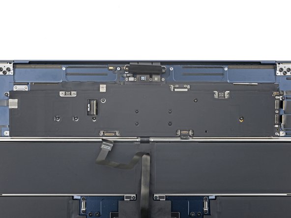

  36. MacBook Air 15" 2023 Battery Replacement, Unfasten the logic board: crwdns2935265:036crwdnd2935265:01crwdnd2935265:02crwdne2935265:0 MacBook Air 15" 2023 Battery Replacement, Unfasten the logic board: crwdns2935265:036crwdnd2935265:02crwdnd2935265:02crwdne2935265:0
    • Use a 3IP Torx Plus screwdriver to remove the two screws on the upper left edge of the logic board:
    • One 2.6 mm‑long screw
    • One 4.7 mm‑long screw
    • Use a 5IP Torx Plus screwdriver to remove the six remaining screws securing the logic board:
    • Three 3.1 mm‑long screws
    • Two 3.8 mm‑long screws
    • One 3.6 mm‑long screw

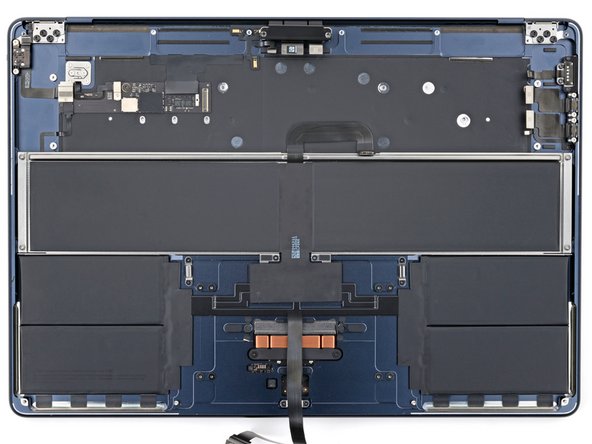

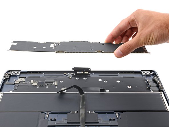

  37. MacBook Air 15" 2023 Battery Replacement, Remove the logic board: crwdns2935265:037crwdnd2935265:01crwdnd2935265:03crwdne2935265:0 MacBook Air 15" 2023 Battery Replacement, Remove the logic board: crwdns2935265:037crwdnd2935265:02crwdnd2935265:03crwdne2935265:0 MacBook Air 15" 2023 Battery Replacement, Remove the logic board: crwdns2935265:037crwdnd2935265:03crwdnd2935265:03crwdne2935265:0
    • Grip the right side of the logic board and remove it.
    • During reassembly:
    • Lower the logic board into place, making sure no cables get stuck underneath.
    • Carefully check the edges of the logic board to see if any cables got stuck underneath. If any did, use the point of a spudger to gently pull them out.

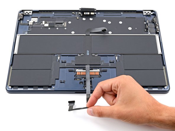

  38. MacBook Air 15" 2023 Battery Replacement, Reposition the trackpad cable: crwdns2935265:038crwdnd2935265:01crwdnd2935265:02crwdne2935265:0 MacBook Air 15" 2023 Battery Replacement, Reposition the trackpad cable: crwdns2935265:038crwdnd2935265:02crwdnd2935265:02crwdne2935265:0
    • Move the trackpad cable over the bottom edge of the MacBook so it's out of the way of the battery.

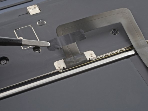

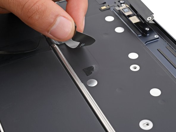

  39. MacBook Air 15" 2023 Battery Replacement, Separate the battery cable adhesive: crwdns2935265:039crwdnd2935265:01crwdnd2935265:02crwdne2935265:0 MacBook Air 15" 2023 Battery Replacement, Separate the battery cable adhesive: crwdns2935265:039crwdnd2935265:02crwdnd2935265:02crwdne2935265:0
    Tesa 61395 Tape
    $2.99
    • Light adhesive secures the top of the battery cable to the frame.
    • Lift the battery cable from the frame to separate the adhesive securing it.
    • If your battery cable comes with adhesive, remove the plastic liner and press the cable into place on the trackpad.
    • If the cable doesn't have adhesive, use a strip of double-sided tape to secure it to the trackpad.
  40. MacBook Air 15" 2023 Battery Replacement, Unfasten the battery tray: crwdns2935265:040crwdnd2935265:01crwdnd2935265:02crwdne2935265:0 MacBook Air 15" 2023 Battery Replacement, Unfasten the battery tray: crwdns2935265:040crwdnd2935265:02crwdnd2935265:02crwdne2935265:0
    • Use a 4IP Torx Plus screwdriver to remove the four 4.6 mm‑long screws securing the upper edges of the battery tray.
    • Use a 3IP Torx Plus screwdriver to remove the two 2.5 mm‑long screws securing the center of the battery tray.

  42. MacBook Air 15" 2023 Battery Replacement, Peel up the stretch-release pull tabs: crwdns2935265:042crwdnd2935265:01crwdnd2935265:03crwdne2935265:0 MacBook Air 15" 2023 Battery Replacement, Peel up the stretch-release pull tabs: crwdns2935265:042crwdnd2935265:02crwdnd2935265:03crwdne2935265:0 MacBook Air 15" 2023 Battery Replacement, Peel up the stretch-release pull tabs: crwdns2935265:042crwdnd2935265:03crwdnd2935265:03crwdne2935265:0
    • Use the point of a spudger and tweezers to separate and peel up the eight pull tabs.
    • Don't pull on the tabs yet.

  46. MacBook Air 15" 2023 Battery Replacement, Remove the battery: crwdns2935265:046crwdnd2935265:01crwdnd2935265:02crwdne2935265:0 MacBook Air 15" 2023 Battery Replacement, Remove the battery: crwdns2935265:046crwdnd2935265:02crwdnd2935265:02crwdne2935265:0
    Stretch Release Battery Adhesive
    $3.99
    • Remove the battery.
    • Remove any remaining adhesive strips with tweezers or your fingers.
    • Clean up the adhesive residue with a few drops of isopropyl alcohol and a lint-free or microfiber cloth.
    • Before removing any adhesive liners, place the battery in its recess and make sure it fits.
    • If your replacement battery comes with adhesive, remove the plastic liners and firmly press each cell into place.
    • If your replacement battery doesn't come with adhesive, secure it with stretch-release adhesive.
    • Alternatively, you can use strong double-sided tape to secure the battery.
