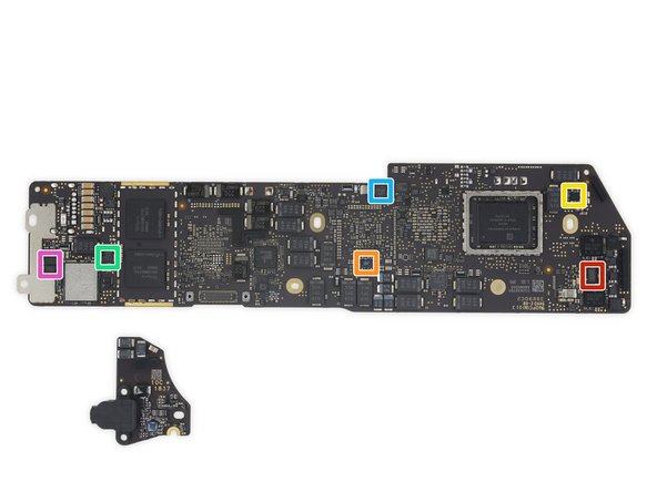

    • Just six Torx screws and a few cable connectors stand between us and logic board removal—not bad! Certainly nothing our Marlin Screwdriver Set can't handle.
    • Out it comes! The Air's logic board is not mustachioed like the Pro's, nor is it quite so minuscule as the MacBook's.
    • So far this is easy, but we'd prefer to see upgradeable components or straightforward battery access—AKA device-life extenders—over board access at this point.
    • Next we snag the daughterboard, which hosts a (highly endangered) headphone jack and some connectors for the speaker and Touch ID sensor.
    • Also residing on this board: a Cirrus Logic CS42L83A audio codec.
  6. MacBook Air 13" Retina 2018 Teardown: crwdns2935265:06crwdnd2935265:01crwdnd2935265:02crwdne2935265:0 MacBook Air 13" Retina 2018 Teardown: crwdns2935265:06crwdnd2935265:02crwdnd2935265:02crwdne2935265:0
    • This board may be small, but it's still packing some decent processing power:
    • Intel SREKQ Core i5-8210Y processor
    • Apple APL1027 339S00535 T2 coprocessor
    • SanDisk SDSGFBF12 043G flash storage +1 on the back (43 GB each/128 GB total)
    • Intel JHL7540 Thunderbolt 3 controller
    • 338S00267-A0 (likely an Apple PMIC)
    • Macronix W25Q80DVUXIE 8 Mb serial NOR flash memory
    • Vishay SIC532 and Texas Instruments CSD58873Q3D power stages

Am I losing my eyesight, or is that fan not directly connected to any type of heat dissipating hardware? Looks like it’s either just providing a general low-pressure-air-flow throughout the internals - OR - it pushes air back through that antenna/heatsink-bracket-type-thing and coming out the other end of it?
Could you confirm or explain this in more detail?
alexander.lagergren - crwdns2934203:0crwdne2934203:0
I think it is just an exhaust fan, that removes hot air from a laptop case outside (from the right side of the case, under the screen) and creates a negative pressure inside, which helps a laptop to “suck“ some cool air from the outside through the intake on the left side of case, under the screen. The shape of the radiator ribs also suggests some airflow from left/right side of the case to the opposite side.
Serge B. -
The only thing that fan is doing is moving a (tiny) bit of air indirectly across the logic board and the heatsink. Or at least that is what I think it does. As there is no direct heat conduction from logic board to case, the fan isn’t there to cool the case, that’s for sure.
Federico Barutto -
Yeah it is just a case ventilation fan, it doesn’t blow any heatsinks directly. Although with the very low TDP of the processor, a case fan with radiator type heat sink should do the job.
Tom Chai -
Yes, as the 12” Macbook with a ~5W TDP chip manages without a fan, I’m sure a slower general airflow together with that heatsink works well for the 7W chip in the 2018 MBA.
And when looking closer - the vents on either side of the antenna bracket, that the fan exhausts through on one side - air is drawn in on the other side and then guided by the vanes in the ventilation holes, allowing it to flow easily from right to left (when viewing bottom/inside of the MBA) over the heatsink cooling fins. There doesn’t appear to be any other openings in the chassi, so Apple has probably designed the airflow pretty efficiently in this fashion.
Pretty cool! Only Mac laptop I’ve seen with a fan but without heat-pipes/sinks by the fan.
