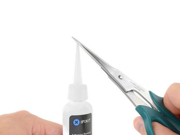

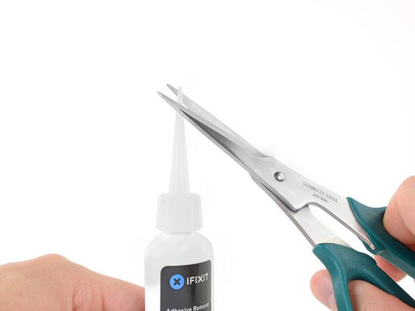

    3. Retina MacBook 2015 Battery Replacement: crwdns2935265:038crwdnd2935265:01crwdnd2935265:03crwdne2935265:0 Retina MacBook 2015 Battery Replacement: crwdns2935265:038crwdnd2935265:02crwdnd2935265:03crwdne2935265:0 Retina MacBook 2015 Battery Replacement: crwdns2935265:038crwdnd2935265:03crwdnd2935265:03crwdne2935265:0
      • Pull off the black rubber stopper from your bottle of adhesive remover.
      • Twist to loosen or remove the bottle cap before you cut the applicator tip.
      • This unseals the bottle and allows the pressure to equalize before you cut the applicator tip. If you skip this step, the adhesive remover may spray out unexpectedly when the tip is cut.
      • Use scissors to cut off the sealed tip of the applicator.
      • Cutting close to the narrow tip will give you better control so you can apply the adhesive remover in small amounts.
      • Twist and close the bottle cap securely before you proceed further.
