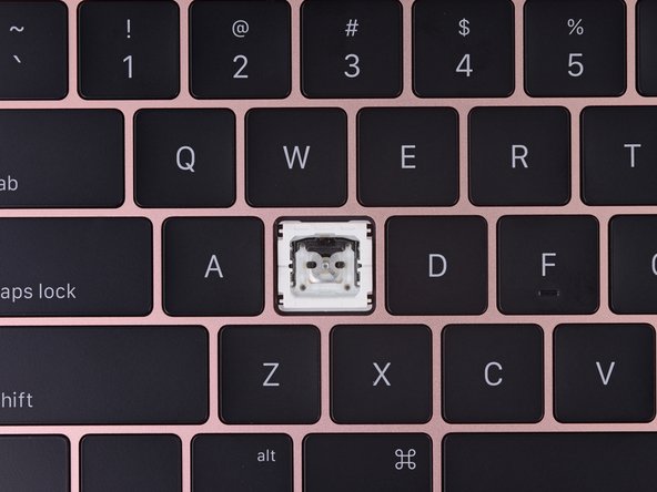

    • Rumor has it that the second gen butterfly mechanism inherited from the Pro makes this MacBook way more usable—so what's inside?
    • Comparing the space gray "new" keyboard to the rose gold MacBook of yesteryear, we can see:
    • The mechanical switch that detects the keystroke is a simpler rounder dome, not the fancy 'x' shape it once was.
    • The plastic butterfly mechanism also accommodates the new switch, swapping to a new, slightly thinner frame.
    • While not really a mechanical change, the control and option keys got some new ink. They now mark keyboard shortcuts rather than translating for PC users.
