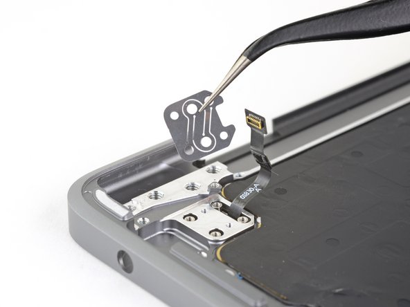

    • Use a T3 Torx driver to remove the six 1.6 mm screws securing the Touch ID sensor and its bracket.

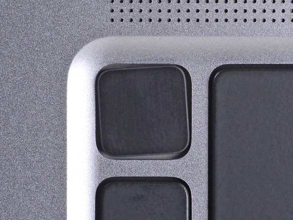

    • During reassembly, if you want your Touch ID button to be straight, don't tighten down the six screws until you adjust its position on the keyboard.
    • Remove the Touch ID sensor bracket.
  12. MacBook Air 13" Early 2020 Touch ID Sensor Replacement, Remove the Touch ID sensor: crwdns2935265:012crwdnd2935265:01crwdnd2935265:01crwdne2935265:0
    • Turn the MacBook right-side up and open the display.
    • Remove the Touch ID sensor.
