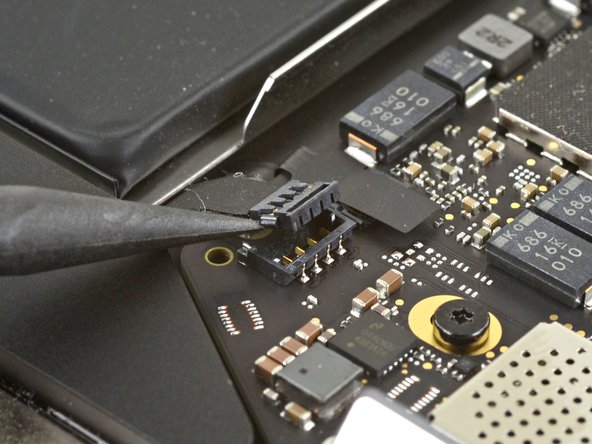

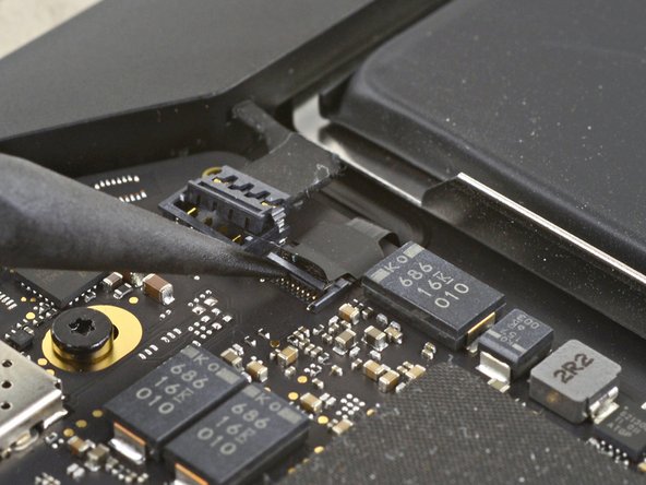

  3. MacBook Air 13" Early 2020 Logic Board Replacement, Disconnect the battery: crwdns2935265:03crwdnd2935265:01crwdnd2935265:01crwdne2935265:0
    • Peel back the tape covering the battery connector enough to reveal the connector underneath.
  4. MacBook Air 13" Early 2020 Logic Board Replacement: crwdns2935265:04crwdnd2935265:01crwdnd2935265:02crwdne2935265:0 MacBook Air 13" Early 2020 Logic Board Replacement: crwdns2935265:04crwdnd2935265:02crwdnd2935265:02crwdne2935265:0
    • Use a spudger to slide the battery connector parallel to the logic board and out of its socket on the logic board.

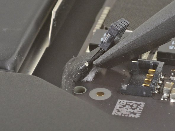

  12. MacBook Air 13" Early 2020 Logic Board Replacement: crwdns2935265:012crwdnd2935265:01crwdnd2935265:01crwdne2935265:0
    • Peel back the black tape covering the fan cable connector.
  13. MacBook Air 13" Early 2020 Logic Board Replacement: crwdns2935265:013crwdnd2935265:01crwdnd2935265:03crwdne2935265:0 MacBook Air 13" Early 2020 Logic Board Replacement: crwdns2935265:013crwdnd2935265:02crwdnd2935265:03crwdne2935265:0 MacBook Air 13" Early 2020 Logic Board Replacement: crwdns2935265:013crwdnd2935265:03crwdnd2935265:03crwdne2935265:0
    • Use the tip of a spudger to lift up the locking flap on the fan cable's ZIF connector.
    • Slide the fan cable out of the ZIF connector.

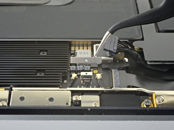

  14. MacBook Air 13" Early 2020 Logic Board Replacement: crwdns2935265:014crwdnd2935265:01crwdnd2935265:02crwdne2935265:0 MacBook Air 13" Early 2020 Logic Board Replacement: crwdns2935265:014crwdnd2935265:02crwdnd2935265:02crwdne2935265:0
    • Use a T4 Torx driver to remove the 1.4 mm screw securing the antenna cable cover.
    • Remove the antenna cable cover.

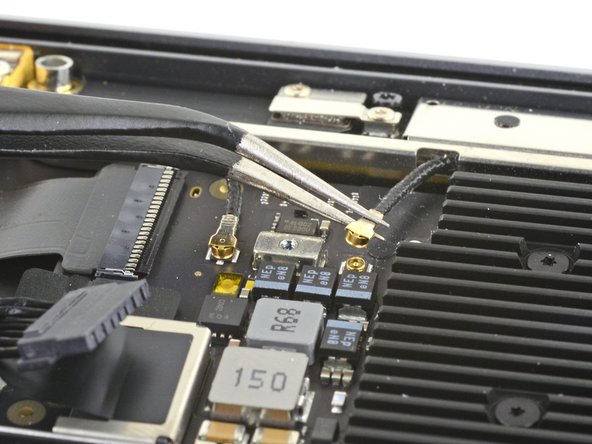

  15. MacBook Air 13" Early 2020 Logic Board Replacement: crwdns2935265:015crwdnd2935265:01crwdnd2935265:03crwdne2935265:0 MacBook Air 13" Early 2020 Logic Board Replacement: crwdns2935265:015crwdnd2935265:02crwdnd2935265:03crwdne2935265:0 MacBook Air 13" Early 2020 Logic Board Replacement: crwdns2935265:015crwdnd2935265:03crwdnd2935265:03crwdne2935265:0
    • Use a pair of tweezers to grip the antenna connector close to its base.
    • Pull straight up to disconnect the cable.
    • Repeat for the second antenna cable.
