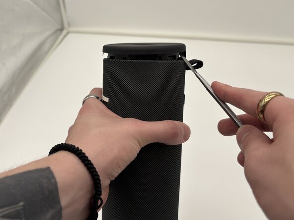

    • Place the end of a metal spudger in the seam between the top cover and outer case of the speaker. Work your way around the seam of the cover to loosen it.
    • This will take force as it is glued down with the waterproofing sealant.
    • Be careful when using the metal spudger. It is sharp and can cause damage to your device and yourself.
    • Separate the top cover of the speaker from the case.

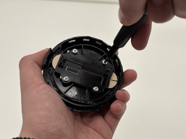

    • Use a Phillips #1 screwdriver to remove four screws from the underside of the top cover of the speaker.
    • Remove the black bracket covering the button board.

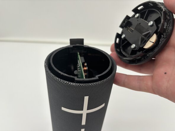

    • Remove the circuit board from the cap.
