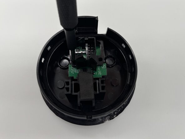

    1. Logitech UE Megaboom 4 Charging Port Replacement, Charging Port: crwdns2935265:05crwdnd2935265:01crwdnd2935265:01crwdne2935265:0
      • Remove the cover from the USB-C charging port end of the device.
      • The port should be visible from the outside.

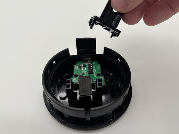

    2. Logitech UE Megaboom 4 Charging Port Replacement: crwdns2935265:06crwdnd2935265:01crwdnd2935265:03crwdne2935265:0 Logitech UE Megaboom 4 Charging Port Replacement: crwdns2935265:06crwdnd2935265:02crwdnd2935265:03crwdne2935265:0 Logitech UE Megaboom 4 Charging Port Replacement: crwdns2935265:06crwdnd2935265:03crwdnd2935265:03crwdne2935265:0
      • Use a Phillips #1 screwdriver to remove the two screws securing the I/O board inside the speaker's end cover.
      • Set the screws aside for reassembly.
      • Remove the black plastic bracket from the top of the I/O board.
    3. Logitech UE Megaboom 4 Charging Port Replacement: crwdns2935265:07crwdnd2935265:01crwdnd2935265:01crwdne2935265:0
      • Remove the board with the charging port from the inside cover.
      • Take note of the charging port placement for reassembly.
