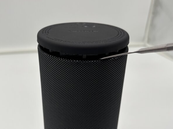

      • Flip your speaker upside down so the charging port side is faced upwards.
      • Take a metal spudger in between the rubber bottom and the mesh case.
      • Work your way around the base of the speaker until the top separates from the case of the speaker.
      • This will take force.
      • Use the metal spudger carefully. Improper use may lead to injury.

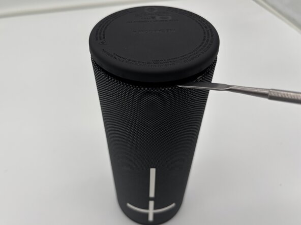

    2. Logitech UE Megaboom 4 Battery Replacement: crwdns2935265:02crwdnd2935265:01crwdnd2935265:01crwdne2935265:0
      • Remove the bottom of the speaker and place it off to the side.
      • Once the glued seal is broken you will be able to pull it off with your hands.

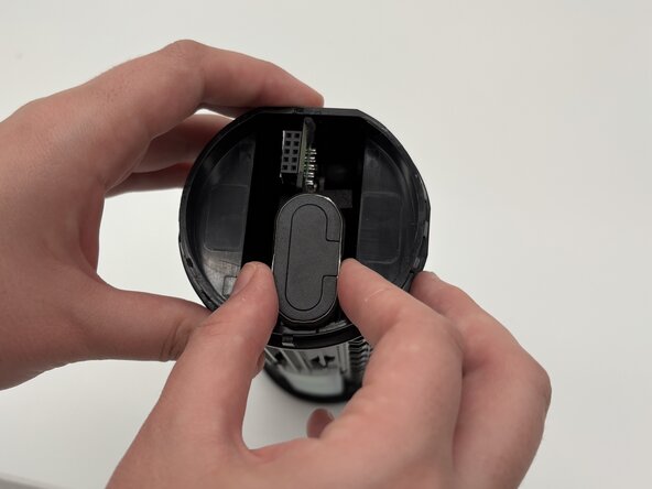

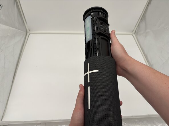

    3. Logitech UE Megaboom 4 Battery Replacement: crwdns2935265:03crwdnd2935265:01crwdnd2935265:03crwdne2935265:0 Logitech UE Megaboom 4 Battery Replacement: crwdns2935265:03crwdnd2935265:02crwdnd2935265:03crwdne2935265:0 Logitech UE Megaboom 4 Battery Replacement: crwdns2935265:03crwdnd2935265:03crwdnd2935265:03crwdne2935265:0
      • Push with your thumbs on the two plastic pieces on the inside of your speaker.
      • The inside components will begin to slide out of the top from the mesh casing.

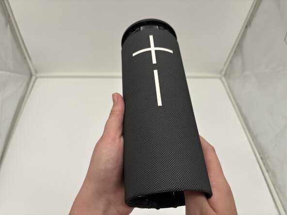

    4. Logitech UE Megaboom 4 Battery Replacement: crwdns2935265:04crwdnd2935265:01crwdnd2935265:01crwdne2935265:0
      • The case and internal components of your speaker should now be separated.

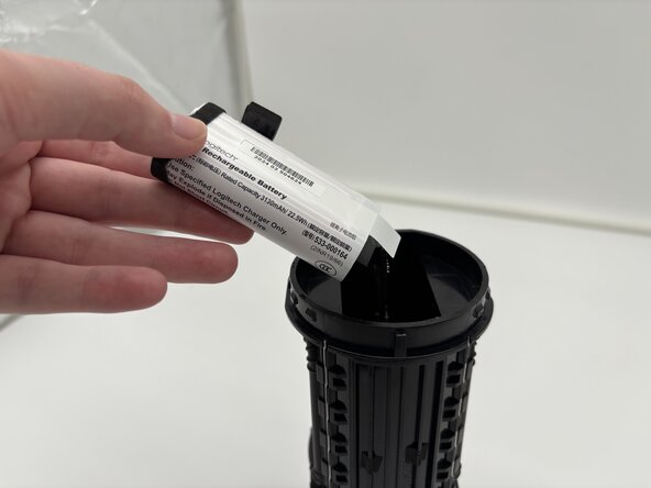

      • Pull the battery out with your fingers.
      • When pulling the battery out, you may need to wiggle it a little bit or use a rubber grip on your fingers.
    6. Logitech UE Megaboom 4 Battery Replacement: crwdns2935265:06crwdnd2935265:01crwdnd2935265:01crwdne2935265:0
      • When installing the new battery, ensure that the battery connector aligns with the connector on the speaker so they don't get damaged.
