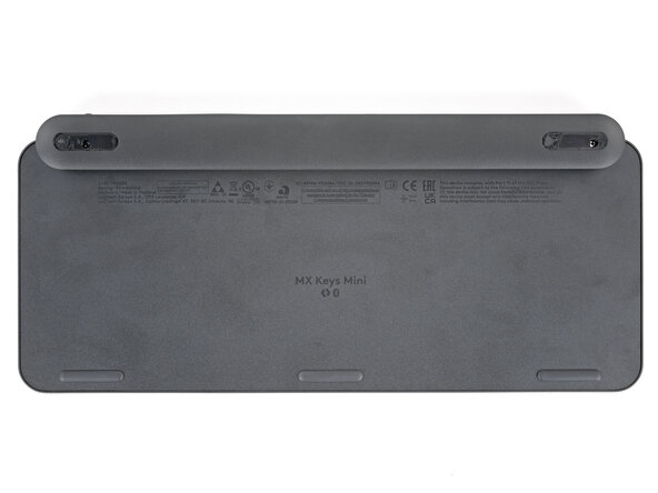

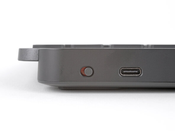

    • Slide the keyboard's power switch into the OFF position.
    • A red indicator should be visible beneath the switch.
    • Unplug all cables from your keyboard.
    • Lay your keyboard down with the feet facing up on a clean work surface.
    • If your work surface may scratch the keyboard, place a soft towel under it.

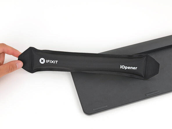

    • Heat an iOpener and lay it on the top left foot for one minute.
    • Alternatively, you can use a hair dryer on the Low heat setting to soften the adhesive.
    • If you're using a hair dryer, only heat the feet a few seconds at a time or you may warp the plastic.

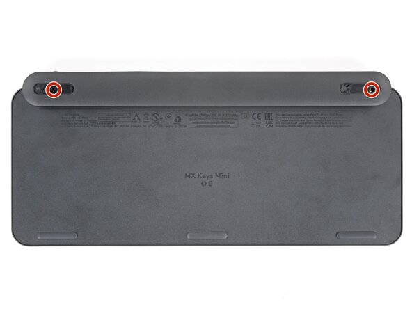

  5. Logitech MX Keys Mini Battery Replacement, Remove the battery cover: crwdns2935265:05crwdnd2935265:01crwdnd2935265:03crwdne2935265:0 Logitech MX Keys Mini Battery Replacement, Remove the battery cover: crwdns2935265:05crwdnd2935265:02crwdnd2935265:03crwdne2935265:0 Logitech MX Keys Mini Battery Replacement, Remove the battery cover: crwdns2935265:05crwdnd2935265:03crwdnd2935265:03crwdne2935265:0
    • Plastic film may be covering the screws in the top edge foot recesses.
    • Use the pointed end of a spudger to poke through each film so you can access the screw underneath.
  6. Logitech MX Keys Mini Battery Replacement: crwdns2935265:06crwdnd2935265:01crwdnd2935265:02crwdne2935265:0 Logitech MX Keys Mini Battery Replacement: crwdns2935265:06crwdnd2935265:02crwdnd2935265:02crwdne2935265:0
    • Use a Phillips screwdriver to remove the two 7.7 mm‑long screws securing the battery cover.

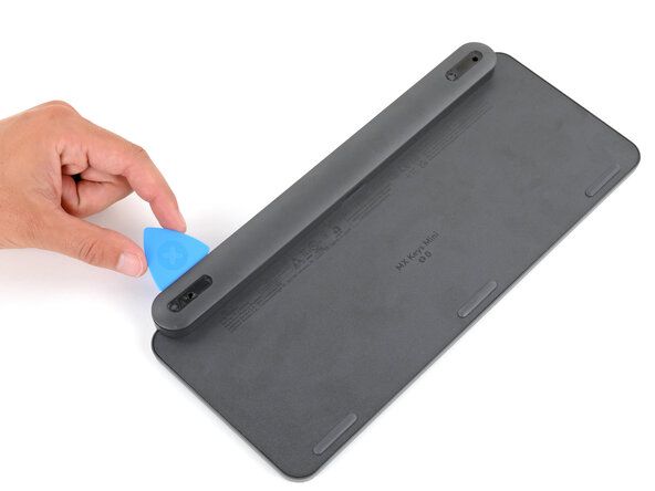

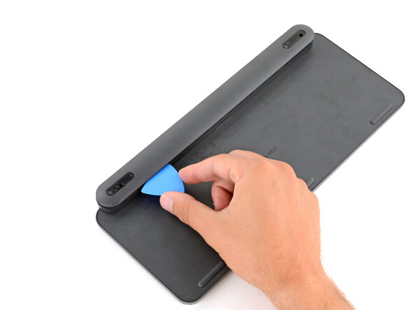

    • Plastic clips secure the battery cover.
    • Insert an opening pick between the battery cover and keyboard.
    • Slide the pick along the top and bottom edges to release the clips.
  8. Logitech MX Keys Mini Battery Replacement: crwdns2935265:08crwdnd2935265:01crwdnd2935265:02crwdne2935265:0 Logitech MX Keys Mini Battery Replacement: crwdns2935265:08crwdnd2935265:02crwdnd2935265:02crwdne2935265:0

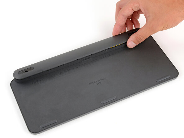

    • Remove the battery cover.
    • During reassembly:
    • Place the battery cover onto the keyboard assembly so the screw holes line up with their posts.
    • Press down firmly along the battery cover to engage its clips.
    • You should feel and hear distinct "clicks" as the clips engage.

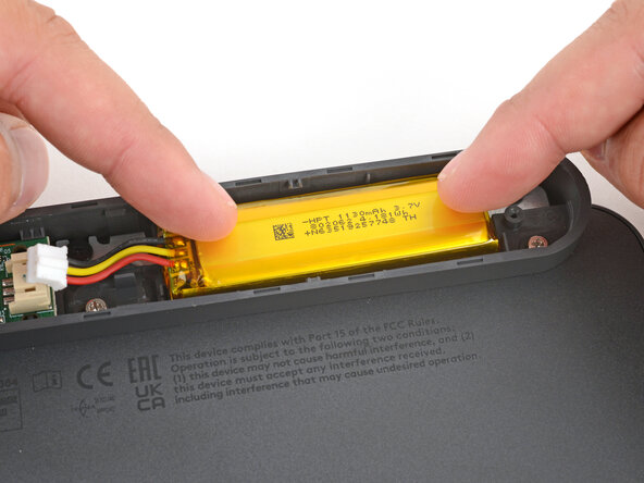

  9. Logitech MX Keys Mini Battery Replacement, Remove the battery: crwdns2935265:09crwdnd2935265:01crwdnd2935265:03crwdne2935265:0 Logitech MX Keys Mini Battery Replacement, Remove the battery: crwdns2935265:09crwdnd2935265:02crwdnd2935265:03crwdne2935265:0 Logitech MX Keys Mini Battery Replacement, Remove the battery: crwdns2935265:09crwdnd2935265:03crwdnd2935265:03crwdne2935265:0
    $3.99

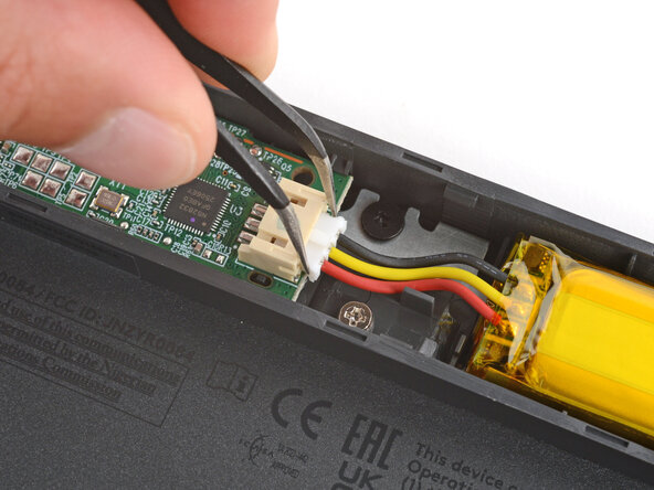

    • Use a pair of angled tweezers to firmly grip the battery connector and slide it straight out of its socket.
    • If you're having trouble, gently rock the connector side-to-side to help loosen it.
    • Insert the connector into its socket so the side with raised plastic in the center is facing up.
    • Push on the edges of the connector with the flat end of a spudger until it's fully seated in the socket.
  10. Logitech MX Keys Mini Battery Replacement: crwdns2935265:010crwdnd2935265:01crwdnd2935265:03crwdne2935265:0 Logitech MX Keys Mini Battery Replacement: crwdns2935265:010crwdnd2935265:02crwdnd2935265:03crwdne2935265:0 Logitech MX Keys Mini Battery Replacement: crwdns2935265:010crwdnd2935265:03crwdnd2935265:03crwdne2935265:0

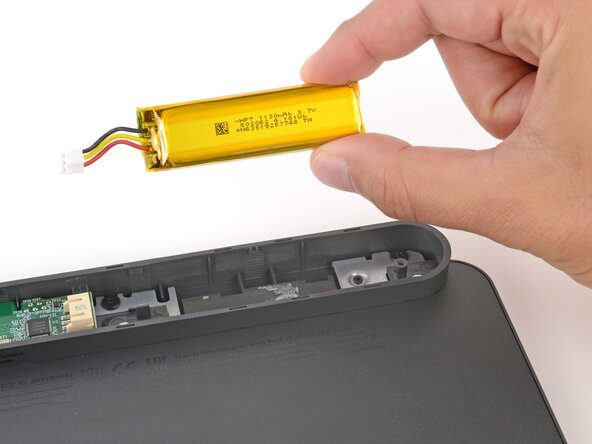

    • Insert the flat end of a spudger underneath the right edge of the battery, opposite the cables.
    • Slide the spudger underneath the battery and gently lift to separate the adhesive securing it to the keyboard.
    • Make sure you push the spudger underneath the battery and not into it. Don't bend or deform the battery.
    • If the battery isn't separating, apply a few drops of isopropyl alcohol (>90%) to its edge and slightly tilt the keyboard. Wait one minute for the alcohol to soften the adhesive and try again.
    • Remove the battery.
