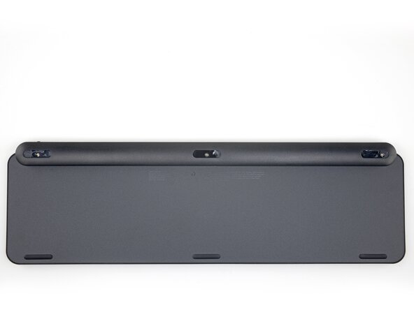

    • Slide the keyboard's power switch into the OFF position.
    • A red indicator should be visible beneath the switch.
    • Unplug all cables from your keyboard.
    • Lay your keyboard down with the feet facing up on a clean work surface.
    • If your work surface may scratch the keyboard, place a soft towel under it.
  2. Logitech MX Keys Battery Replacement, Remove the feet: crwdns2935265:02crwdnd2935265:01crwdnd2935265:02crwdne2935265:0 Logitech MX Keys Battery Replacement, Remove the feet: crwdns2935265:02crwdnd2935265:02crwdnd2935265:02crwdne2935265:0

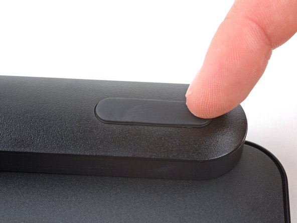

    • Heat an iOpener and lay it on the top left foot for one minute.
    • Alternatively, you can use a hair dryer on the Low heat setting to soften the adhesive.
    • If you're using a hair dryer, only heat the feet a few seconds at a time or you may warp the plastic.
  3. Logitech MX Keys Battery Replacement: crwdns2935265:03crwdnd2935265:01crwdnd2935265:03crwdne2935265:0 Logitech MX Keys Battery Replacement: crwdns2935265:03crwdnd2935265:02crwdnd2935265:03crwdne2935265:0 Logitech MX Keys Battery Replacement: crwdns2935265:03crwdnd2935265:03crwdnd2935265:03crwdne2935265:0
    • The foot should come up without much force. If it feels stuck, apply more heat and try again.
    • Insert the point of a spudger under an end of the foot.
    • Push the spudger underneath the foot and lift until you can grip it with your fingers.
    • Peel the foot up and remove it.
    • Repeat the process to remove the remaining feet.
    • If you're replacing the battery, you only need to remove the feet along the top edge.

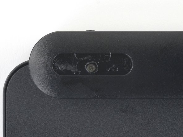

    • Plastic film may be covering the screws in the top edge foot recesses.
    • Use the pointed end of a spudger to poke through each film so you can access the screw underneath.

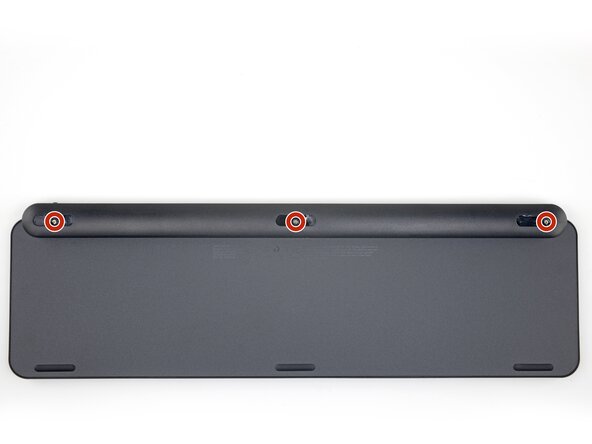

  6. Logitech MX Keys Battery Replacement: crwdns2935265:06crwdnd2935265:01crwdnd2935265:02crwdne2935265:0 Logitech MX Keys Battery Replacement: crwdns2935265:06crwdnd2935265:02crwdnd2935265:02crwdne2935265:0
    • Use a Phillips screwdriver to remove the three 7.6 mm‑long screws securing the battery cover.

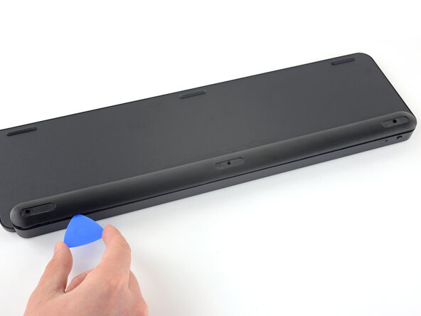

    • Plastic clips secure the battery cover.
    • Insert an opening pick between the top edge of the battery cover and keyboard.
    • Slide the pick along the top edge to release the clips.

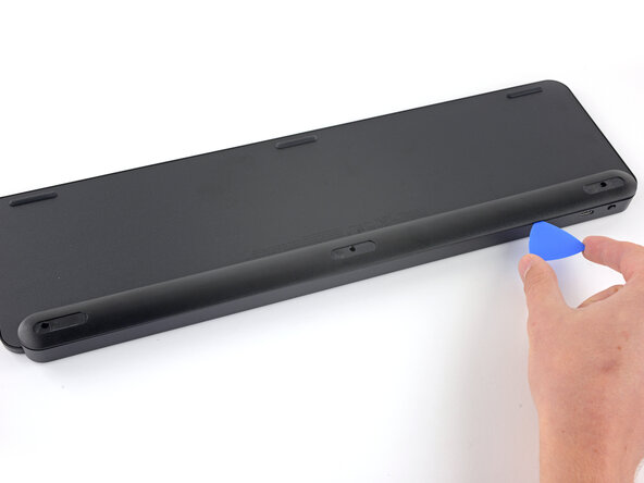

  8. Logitech MX Keys Battery Replacement: crwdns2935265:08crwdnd2935265:01crwdnd2935265:02crwdne2935265:0 Logitech MX Keys Battery Replacement: crwdns2935265:08crwdnd2935265:02crwdnd2935265:02crwdne2935265:0

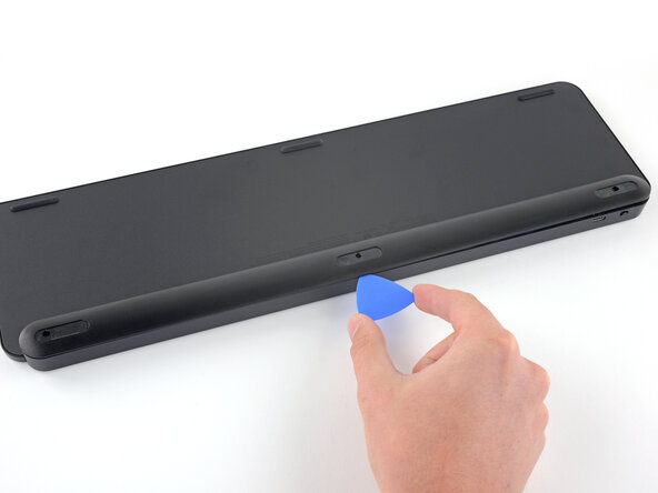

    • Insert an opening pick between the bottom edge of battery cover and keyboard.
    • Slide the pick along the bottom edge to release the remaining clips.
  9. Logitech MX Keys Battery Replacement: crwdns2935265:09crwdnd2935265:01crwdnd2935265:02crwdne2935265:0 Logitech MX Keys Battery Replacement: crwdns2935265:09crwdnd2935265:02crwdnd2935265:02crwdne2935265:0
    • Remove the battery cover.

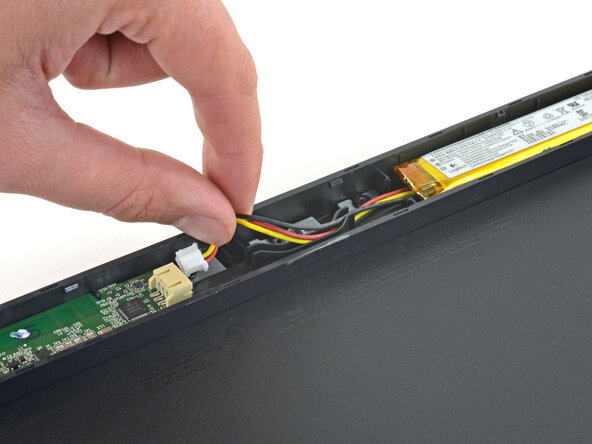

  10. Logitech MX Keys Battery Replacement, Remove the battery: crwdns2935265:010crwdnd2935265:01crwdnd2935265:03crwdne2935265:0 Logitech MX Keys Battery Replacement, Remove the battery: crwdns2935265:010crwdnd2935265:02crwdnd2935265:03crwdne2935265:0 Logitech MX Keys Battery Replacement, Remove the battery: crwdns2935265:010crwdnd2935265:03crwdnd2935265:03crwdne2935265:0
    $3.99

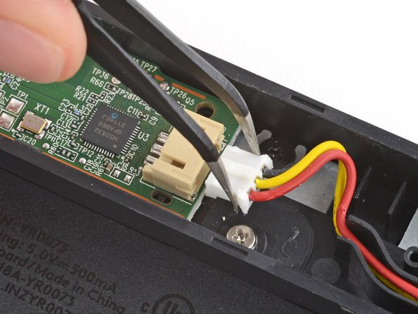

    • Use a pair of angled tweezers to firmly grip the battery connector and slide it straight out of its socket.
    • If you're having trouble, gently rock the connector side-to-side to help loosen it.
    • During reassembly:
    • Insert the connector into its socket so the side with raised plastic in the center is facing up.
    • Push on the edges of the connector with the flat end of a spudger until it's fully seated in the socket.
  11. Logitech MX Keys Battery Replacement: crwdns2935265:011crwdnd2935265:01crwdnd2935265:02crwdne2935265:0 Logitech MX Keys Battery Replacement: crwdns2935265:011crwdnd2935265:02crwdnd2935265:02crwdne2935265:0

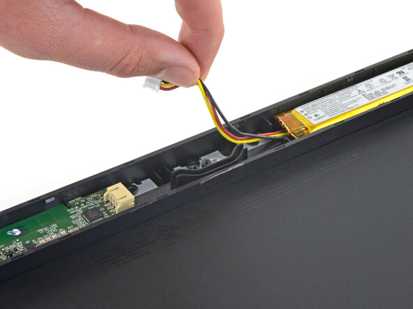

    • Pull the three battery cables out of their channel in the keyboard.
    • During reassembly, route all three cables through their channel so they're on top of each other.

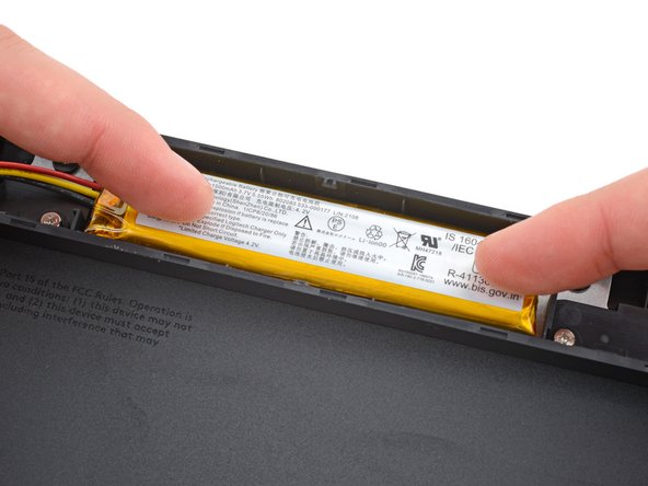

  12. Logitech MX Keys Battery Replacement: crwdns2935265:012crwdnd2935265:01crwdnd2935265:03crwdne2935265:0 Logitech MX Keys Battery Replacement: crwdns2935265:012crwdnd2935265:02crwdnd2935265:03crwdne2935265:0 Logitech MX Keys Battery Replacement: crwdns2935265:012crwdnd2935265:03crwdnd2935265:03crwdne2935265:0

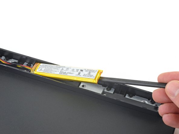

    • Insert the flat end of a spudger underneath the right edge of the battery, opposite the cables.
    • Slide the spudger underneath the battery and gently lift to separate the adhesive securing it to the keyboard.
    • Make sure you push the spudger underneath the battery and not into it. Don't bend or deform the battery.
    • If the battery isn't separating, apply a few drops of isopropyl alcohol (>90%) to its edge and slightly tilt the keyboard. Wait one minute for the alcohol to soften the adhesive and try again.
    • Remove the battery.
