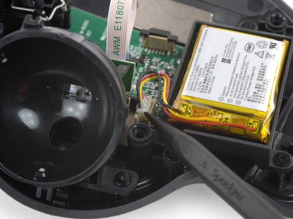

  13. Logitech MX Ergo Battery Replacement, Disconnect the battery: crwdns2935265:013crwdnd2935265:01crwdnd2935265:02crwdne2935265:0 Logitech MX Ergo Battery Replacement, Disconnect the battery: crwdns2935265:013crwdnd2935265:02crwdnd2935265:02crwdne2935265:0
    • Use the pointed end of a spudger to push up and the battery connector, loosening it in its socket.
    • You don't need to push the connector completely out of its socket yet—you'll do so in a few steps.
  14. Logitech MX Ergo Battery Replacement, Pry out the battery: crwdns2935265:014crwdnd2935265:01crwdnd2935265:03crwdne2935265:0 Logitech MX Ergo Battery Replacement, Pry out the battery: crwdns2935265:014crwdnd2935265:02crwdnd2935265:03crwdne2935265:0 Logitech MX Ergo Battery Replacement, Pry out the battery: crwdns2935265:014crwdnd2935265:03crwdnd2935265:03crwdne2935265:0
    • Insert the long edge of an opening pick between the long edge of the battery and its housing, at the side opposite the battery cable.
    • Use your opening pick to pry up the battery and separate its adhesive. Apply steady, constant force and slide the pick farther under the battery as necessary.
    • Make sure you push the pick underneath the battery and not into it. Don't bend or deform the battery.

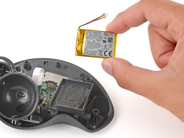

  15. Logitech MX Ergo Battery Replacement: crwdns2935265:015crwdnd2935265:01crwdnd2935265:02crwdne2935265:0 Logitech MX Ergo Battery Replacement: crwdns2935265:015crwdnd2935265:02crwdnd2935265:02crwdne2935265:0
    • Use your fingers to lift the battery out of its housing.

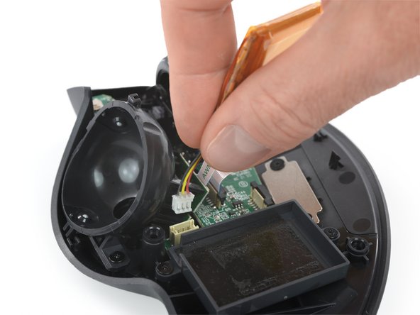

  16. Logitech MX Ergo Battery Replacement, Remove the battery: crwdns2935265:016crwdnd2935265:01crwdnd2935265:03crwdne2935265:0 Logitech MX Ergo Battery Replacement, Remove the battery: crwdns2935265:016crwdnd2935265:02crwdnd2935265:03crwdne2935265:0 Logitech MX Ergo Battery Replacement, Remove the battery: crwdns2935265:016crwdnd2935265:03crwdnd2935265:03crwdne2935265:0
    Tesa 61395 Tape
    $2.99
    • Use your fingers to grip the battery cables as close to the connector as possible and pull the connector straight up and out of its socket.
    • Remove the battery.
    • During reassembly:
    • Never install a deformed or damaged battery, as doing so is a potential safety hazard. Replace it with a new battery.
    • If the battery adhesive is still sticky, you can reuse it. Otherwise, remove all the old battery adhesive.
    • If your new battery has adhesive pre-installed, remove the plastic liner to expose the adhesive. Otherwise, apply strips of thin, double-sided tape to the battery well (not directly to the battery) where the old adhesive was.
    • Firmly press the battery into place, making sure the cables are on the side closest to their socket.
Compare your new replacement part to the original part—you may need to transfer remaining components or remove adhesive backings from the new part before you install it.
