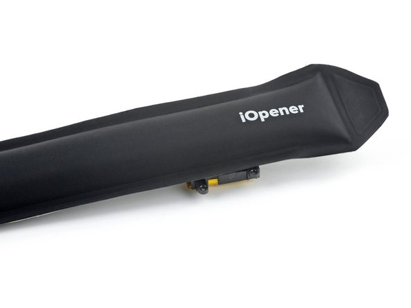

    • If you're planning to reuse your existing mouse feet, the adhesive needs to be thoroughly heated to cleanly remove them.
    • Heat an iOpener and lay it on the mouse feet for about two minutes to soften the adhesive.

    • Apply a heated iOpener to the board on the underside of the mouse's top half for two minutes.
    • Gently slide the tip of an opening pick under the cable to separate its adhesive.

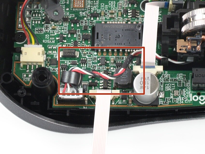

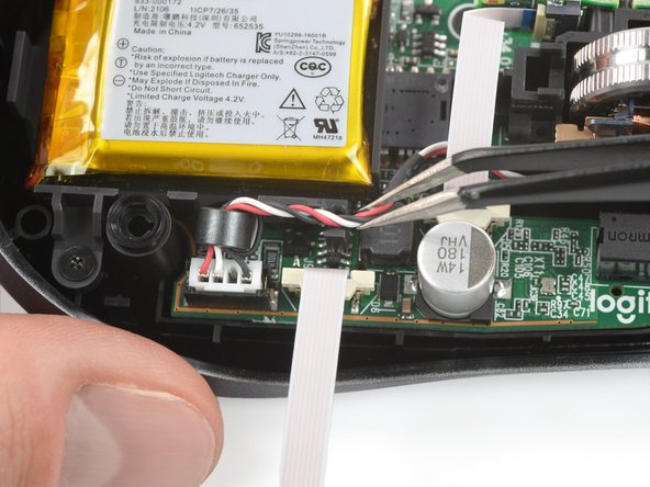

  11. Logitech MX Anywhere 3 for Mac Battery Replacement, Reposition the wheel assembly cable: crwdns2935265:011crwdnd2935265:01crwdnd2935265:02crwdne2935265:0 Logitech MX Anywhere 3 for Mac Battery Replacement, Reposition the wheel assembly cable: crwdns2935265:011crwdnd2935265:02crwdnd2935265:02crwdne2935265:0
    • Use a pair of tweezers (or the point of a spudger) to lift the wheel assembly cables out from under their clip on the battery housing.

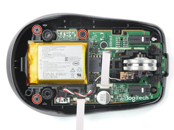

  12. Logitech MX Anywhere 3 for Mac Battery Replacement, Remove the battery housing screws: crwdns2935265:012crwdnd2935265:01crwdnd2935265:02crwdne2935265:0 Logitech MX Anywhere 3 for Mac Battery Replacement, Remove the battery housing screws: crwdns2935265:012crwdnd2935265:02crwdnd2935265:02crwdne2935265:0
    • Use a Phillips screwdriver to remove the three 3.4 mm‑long screws securing the battery housing.

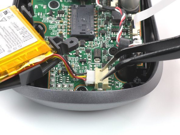

  14. Logitech MX Anywhere 3 for Mac Battery Replacement, Disconnect the battery: crwdns2935265:014crwdnd2935265:01crwdnd2935265:02crwdne2935265:0 Logitech MX Anywhere 3 for Mac Battery Replacement, Disconnect the battery: crwdns2935265:014crwdnd2935265:02crwdnd2935265:02crwdne2935265:0
    • Insert each arm of a pair of pointed tweezers into the small cutouts on the top of the battery connector socket.
    • Slowly push the connector out of its socket, just enough to grip the top of the connector with another pair of tweezers or your fingers.
    • Be careful not to let your tweezers slip out and damage the motherboard.
    • Pull the battery connector completely out of its socket to disconnect it.

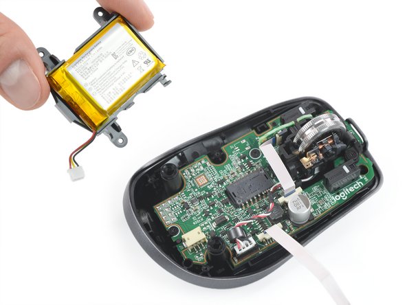

  15. Logitech MX Anywhere 3 for Mac Battery Replacement, Remove the battery housing: crwdns2935265:015crwdnd2935265:01crwdnd2935265:02crwdne2935265:0 Logitech MX Anywhere 3 for Mac Battery Replacement, Remove the battery housing: crwdns2935265:015crwdnd2935265:02crwdnd2935265:02crwdne2935265:0
    • Remove the battery housing.

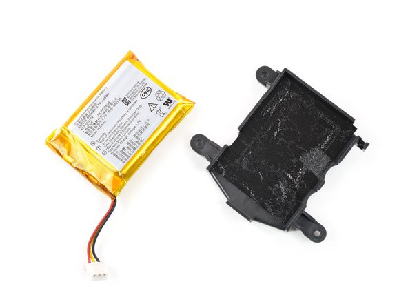

  16. Logitech MX Anywhere 3 for Mac Battery Replacement, Soften the battery adhesive: crwdns2935265:016crwdnd2935265:01crwdnd2935265:02crwdne2935265:0 Logitech MX Anywhere 3 for Mac Battery Replacement, Soften the battery adhesive: crwdns2935265:016crwdnd2935265:02crwdnd2935265:02crwdne2935265:0

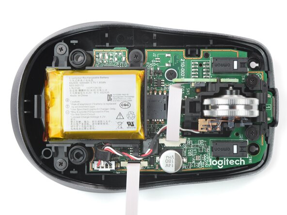

    • The battery is secured in its housing with mild adhesive.
    • Flip the battery housing over so the battery is facing down.
    • Lay a heated iOpener on the battery housing for two minutes to soften the battery adhesive.
  17. Logitech MX Anywhere 3 for Mac Battery Replacement, Remove the battery: crwdns2935265:017crwdnd2935265:01crwdnd2935265:03crwdne2935265:0 Logitech MX Anywhere 3 for Mac Battery Replacement, Remove the battery: crwdns2935265:017crwdnd2935265:02crwdnd2935265:03crwdne2935265:0 Logitech MX Anywhere 3 for Mac Battery Replacement, Remove the battery: crwdns2935265:017crwdnd2935265:03crwdnd2935265:03crwdne2935265:0
    Tesa 61395 Tape
    $5.99
    • Be careful not not to bend, crease, deform, poke, or puncture the battery with your tool—a damaged battery is a potential fire hazard.
    • Insert the flat end of a spudger between the battery and its housing through one of the cutouts.
    • Use the spudger to pry the battery away from the housing to separate its adhesive.
    • Remove the battery.
    • To install a new battery:
    • Use tweezers or your fingers to peel all the old adhesive off the battery housing—it shouldn't leave any residue.
    • If your new battery doesn't come with adhesive pre‑installed, apply a couple strips of double-sided tape to the battery housing.
    • Orient your new battery so the sticker is facing up and the cables are on the short side of the housing that protrudes outward. Press the battery firmly into place to secure it.
