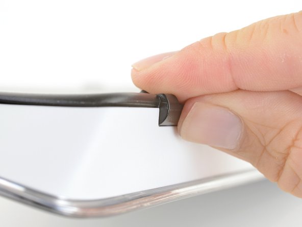

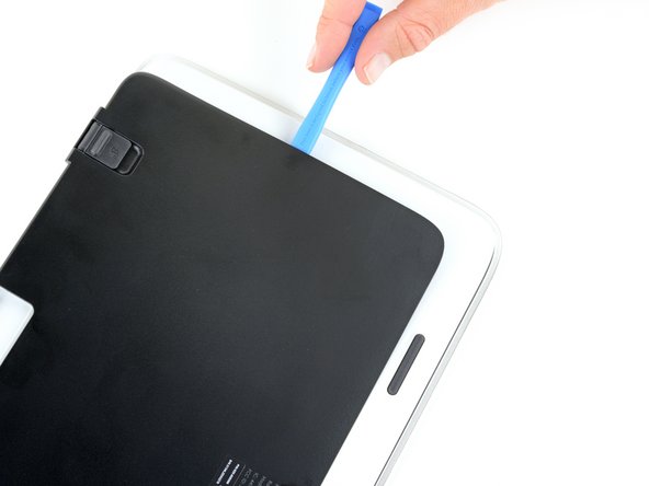

  3. Logitech K800 Battery Replacement, Pry up the rear cover: crwdns2935265:03crwdnd2935265:01crwdnd2935265:02crwdne2935265:0 Logitech K800 Battery Replacement, Pry up the rear cover: crwdns2935265:03crwdnd2935265:02crwdnd2935265:02crwdne2935265:0
    • Slide the edge of an opening tool underneath the bottom edge of the rear cover and pry the cover up to create a gap.
    • You will pry the rear cover away from the keyboard for the next two steps. There are adhesive and clips holding the cover down that will make prying difficult.

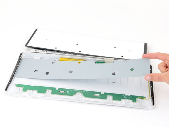

  14. Logitech K800 Battery Replacement, Move the backlight out of the way: crwdns2935265:014crwdnd2935265:01crwdnd2935265:02crwdne2935265:0 Logitech K800 Battery Replacement, Move the backlight out of the way: crwdns2935265:014crwdnd2935265:02crwdnd2935265:02crwdne2935265:0
    • Gently flip the backlight up and over the top of the keyboard to reveal the keyboard backplate.
    • Take care not to strain or crease the backlight ribbon cable.
  15. Logitech K800 Battery Replacement, Remove the backplate: crwdns2935265:015crwdnd2935265:01crwdnd2935265:03crwdne2935265:0 Logitech K800 Battery Replacement, Remove the backplate: crwdns2935265:015crwdnd2935265:02crwdnd2935265:03crwdne2935265:0 Logitech K800 Battery Replacement, Remove the backplate: crwdns2935265:015crwdnd2935265:03crwdnd2935265:03crwdne2935265:0
    • Grasp one end of the backplate and lift it off of the keyboard case.
    • Remove the backplate.
