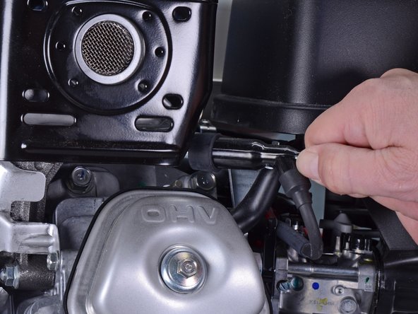

  3. Little Wonder GX270 Honda Maximum Output Blower Fan Replacement: crwdns2935265:03crwdnd2935265:01crwdnd2935265:02crwdne2935265:0 Little Wonder GX270 Honda Maximum Output Blower Fan Replacement: crwdns2935265:03crwdnd2935265:02crwdnd2935265:02crwdne2935265:0
    • Grab the plastic housing at the end of the spark plug wire.
    • Pull firmly to disconnect the wire from the spark plug.

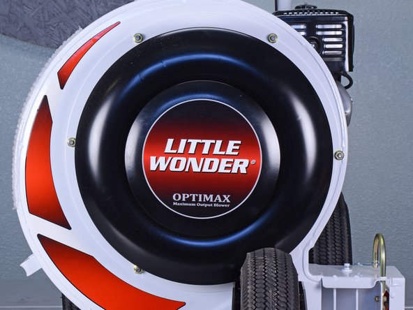

  4. Little Wonder GX270 Honda Maximum Output Blower Fan Replacement, Remove the intake guard: crwdns2935265:04crwdnd2935265:01crwdnd2935265:01crwdne2935265:0
    • Use a 1/2 inch wrench to remove the intake guard bolt behind the front wheel.
  5. Little Wonder GX270 Honda Maximum Output Blower Fan Replacement: crwdns2935265:05crwdnd2935265:01crwdnd2935265:02crwdne2935265:0 Little Wonder GX270 Honda Maximum Output Blower Fan Replacement: crwdns2935265:05crwdnd2935265:02crwdnd2935265:02crwdne2935265:0
    • Use a 1/2 inch socket to remove the five bolts securing the intake guard.

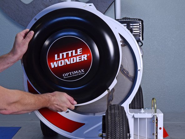

  6. Little Wonder GX270 Honda Maximum Output Blower Fan Replacement: crwdns2935265:06crwdnd2935265:01crwdnd2935265:02crwdne2935265:0 Little Wonder GX270 Honda Maximum Output Blower Fan Replacement: crwdns2935265:06crwdnd2935265:02crwdnd2935265:02crwdne2935265:0
    • Remove the intake guard.

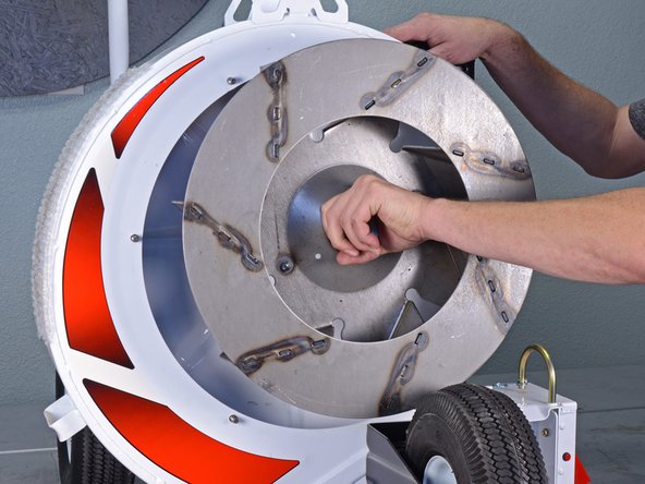

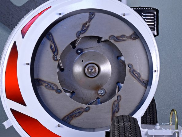

  7. Little Wonder GX270 Honda Maximum Output Blower Fan Replacement, Remove the fan blade: crwdns2935265:07crwdnd2935265:01crwdnd2935265:02crwdne2935265:0 Little Wonder GX270 Honda Maximum Output Blower Fan Replacement, Remove the fan blade: crwdns2935265:07crwdnd2935265:02crwdnd2935265:02crwdne2935265:0
    • Use an impact wrench to remove the 5/8 inch bolt securing the fan blade to the spindle.
  8. Little Wonder GX270 Honda Maximum Output Blower Fan Replacement: crwdns2935265:08crwdnd2935265:01crwdnd2935265:02crwdne2935265:0 Little Wonder GX270 Honda Maximum Output Blower Fan Replacement: crwdns2935265:08crwdnd2935265:02crwdnd2935265:02crwdne2935265:0
    • Remove the fan plug bolt and fan plug.
  9. Little Wonder GX270 Honda Maximum Output Blower Fan Replacement: crwdns2935265:09crwdnd2935265:01crwdnd2935265:02crwdne2935265:0 Little Wonder GX270 Honda Maximum Output Blower Fan Replacement: crwdns2935265:09crwdnd2935265:02crwdnd2935265:02crwdne2935265:0
    • Remove the fan blade.

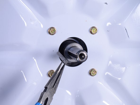

  10. Little Wonder GX270 Honda Maximum Output Blower Fan Replacement: crwdns2935265:010crwdnd2935265:01crwdnd2935265:02crwdne2935265:0 Little Wonder GX270 Honda Maximum Output Blower Fan Replacement: crwdns2935265:010crwdnd2935265:02crwdnd2935265:02crwdne2935265:0

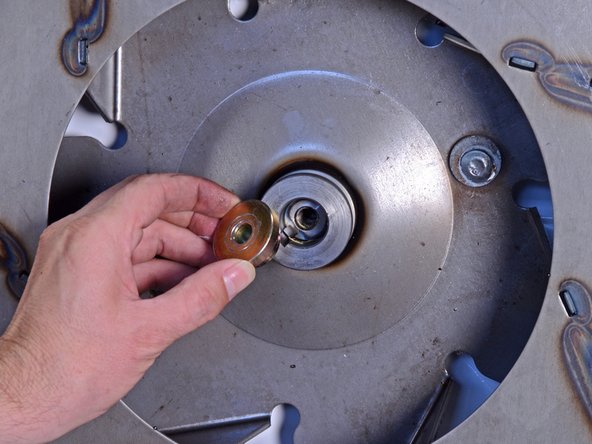

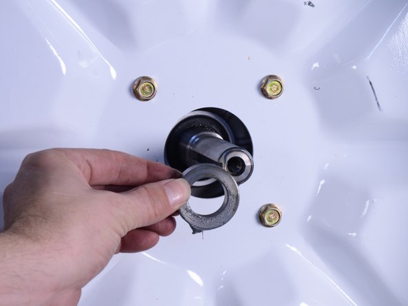

    • Use a pair of pliers to remove the key from the spindle.
  11. Little Wonder GX270 Honda Maximum Output Blower Fan Replacement: crwdns2935265:011crwdnd2935265:01crwdnd2935265:02crwdne2935265:0 Little Wonder GX270 Honda Maximum Output Blower Fan Replacement: crwdns2935265:011crwdnd2935265:02crwdnd2935265:02crwdne2935265:0
    • Remove the fan spacer.
    • Wipe the old grease off the spindle with a shop towel and apply new grease before installing the replacement parts.
