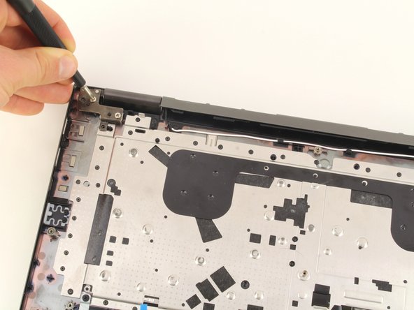

  23. Lenovo YOGA 730-15IKB Screen Replacement, Screen: crwdns2935265:023crwdnd2935265:01crwdnd2935265:02crwdne2935265:0 Lenovo YOGA 730-15IKB Screen Replacement, Screen: crwdns2935265:023crwdnd2935265:02crwdnd2935265:02crwdne2935265:0
    • Remove four 4mm (silver colored) Phillips #1 screws.
    • For reassembly, pay close attention to where you reattach these screws. The holes closest to the corner need to be left free. They will be used when you reattach the back cover.
  24. Lenovo YOGA 730-15IKB Screen Replacement: crwdns2935265:024crwdnd2935265:01crwdnd2935265:03crwdne2935265:0 Lenovo YOGA 730-15IKB Screen Replacement: crwdns2935265:024crwdnd2935265:02crwdnd2935265:03crwdne2935265:0 Lenovo YOGA 730-15IKB Screen Replacement: crwdns2935265:024crwdnd2935265:03crwdnd2935265:03crwdne2935265:0

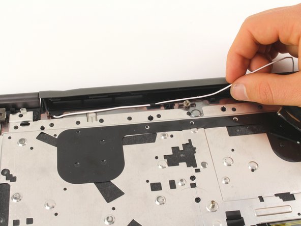

  25. Lenovo YOGA 730-15IKB Screen Replacement: crwdns2935265:025crwdnd2935265:01crwdnd2935265:02crwdne2935265:0 Lenovo YOGA 730-15IKB Screen Replacement: crwdns2935265:025crwdnd2935265:02crwdnd2935265:02crwdne2935265:0
    • Tilt the keyboard up to make a 90 degree angle with the screen. This makes it easier to move the display and antenna cables.
    • On the back of the keyboard, slide the white antenna cable past the edge of the hinge.
    • Pull the keyboard upward and towards the front of the screen to make room for the cable.

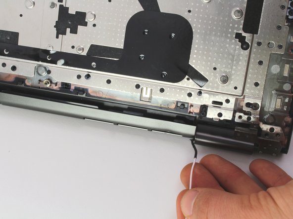

  26. Lenovo YOGA 730-15IKB Screen Replacement: crwdns2935265:026crwdnd2935265:01crwdnd2935265:01crwdne2935265:0
    • Pull the thick display cable and the black antenna cable past the hinge.
    • Tilt the left side of the keyboard upward. This helps create some room around the hinge.

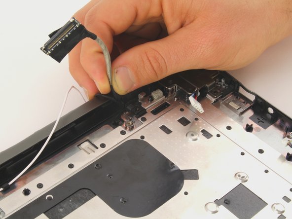

  27. Lenovo YOGA 730-15IKB Screen Replacement: crwdns2935265:027crwdnd2935265:01crwdnd2935265:01crwdne2935265:0
    • Pull the keyboard up away from the screen. After the display and antenna wires have been moved, the keyboard should easily come apart from the screen.
