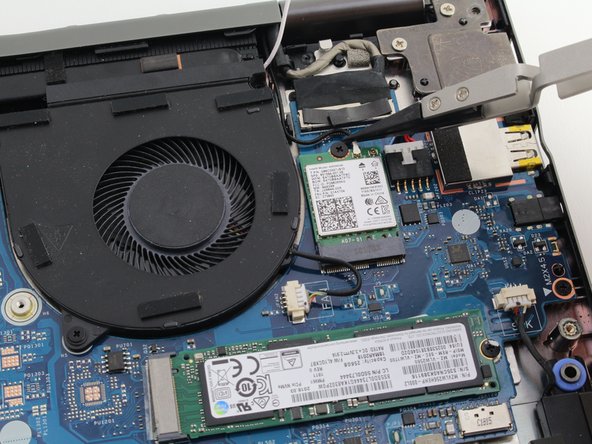

  4. Lenovo YOGA 730-15IKB Wireless Card Replacement, Wireless Card: crwdns2935265:04crwdnd2935265:01crwdnd2935265:01crwdne2935265:0
    • Remove the sticky tape from the top edge of the wireless card.
  5. Lenovo YOGA 730-15IKB Wireless Card Replacement: crwdns2935265:05crwdnd2935265:01crwdnd2935265:03crwdne2935265:0 Lenovo YOGA 730-15IKB Wireless Card Replacement: crwdns2935265:05crwdnd2935265:02crwdnd2935265:03crwdne2935265:0 Lenovo YOGA 730-15IKB Wireless Card Replacement: crwdns2935265:05crwdnd2935265:03crwdnd2935265:03crwdne2935265:0
    • Pull the black and white antenna wires off of the wireless card.
    • For reassembly, the white wire connects to the right terminal marked "1." The black wire connects to the left terminal marked "2."

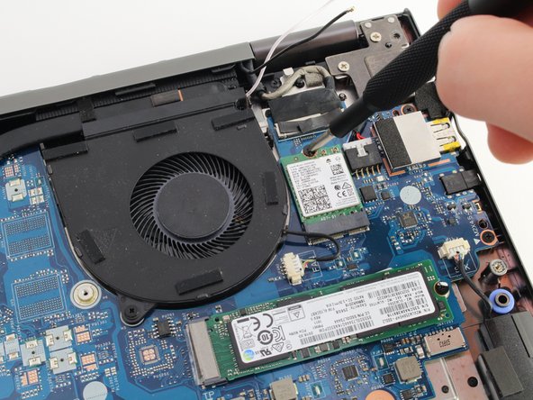

  6. Lenovo YOGA 730-15IKB Wireless Card Replacement: crwdns2935265:06crwdnd2935265:01crwdnd2935265:02crwdne2935265:0 Lenovo YOGA 730-15IKB Wireless Card Replacement: crwdns2935265:06crwdnd2935265:02crwdnd2935265:02crwdne2935265:0
    • Remove one 2mm Phillips #1 screw.

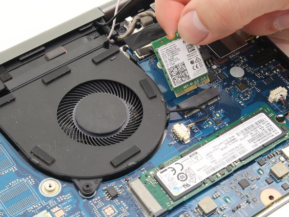

  7. Lenovo YOGA 730-15IKB Wireless Card Replacement: crwdns2935265:07crwdnd2935265:01crwdnd2935265:02crwdne2935265:0 Lenovo YOGA 730-15IKB Wireless Card Replacement: crwdns2935265:07crwdnd2935265:02crwdnd2935265:02crwdne2935265:0
    • Pull the wireless card out of the socket at its resting angle.
    • Do not pull straight upward. Pull towards the hinges at the back of the laptop.
