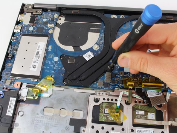

  11. Lenovo YOGA 730-15IKB Heat Sink Replacement, Heat Sink: crwdns2935265:011crwdnd2935265:01crwdnd2935265:03crwdne2935265:0 Lenovo YOGA 730-15IKB Heat Sink Replacement, Heat Sink: crwdns2935265:011crwdnd2935265:02crwdnd2935265:03crwdne2935265:0 Lenovo YOGA 730-15IKB Heat Sink Replacement, Heat Sink: crwdns2935265:011crwdnd2935265:03crwdnd2935265:03crwdne2935265:0
    • Remove three 4mm Phillips #1 screws.
    • Do not remove the springs that are attached to the screws.
  12. Lenovo YOGA 730-15IKB Heat Sink Replacement: crwdns2935265:012crwdnd2935265:01crwdnd2935265:02crwdne2935265:0 Lenovo YOGA 730-15IKB Heat Sink Replacement: crwdns2935265:012crwdnd2935265:02crwdnd2935265:02crwdne2935265:0
    • Pull the heat sink up to remove it from the motherboard.
    • If the heat sink is not lifting up easily, try using an opening tool to gently pry the heat sink away from the motherboard. The thermal paste on the underside of the heat sink may be sticking to the motherboard.
    • It is good practice to always apply new thermal paste before reattaching the heat sink. See this guide for more instructions on using thermal paste.
