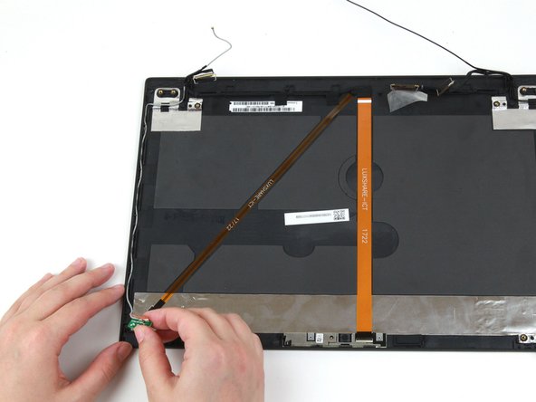

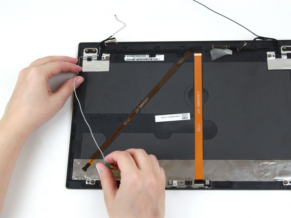

  48. Lenovo ThinkPad T470 WLAN Antennas Replacement, Display Assembly: crwdns2935265:048crwdnd2935265:01crwdnd2935265:02crwdne2935265:0 Lenovo ThinkPad T470 WLAN Antennas Replacement, Display Assembly: crwdns2935265:048crwdnd2935265:02crwdnd2935265:02crwdne2935265:0
    • Use your fingers to remove the camera cable from its slot.
  49. Lenovo ThinkPad T470 WLAN Antennas Replacement: crwdns2935265:049crwdnd2935265:01crwdnd2935265:03crwdne2935265:0 Lenovo ThinkPad T470 WLAN Antennas Replacement: crwdns2935265:049crwdnd2935265:02crwdnd2935265:03crwdne2935265:0 Lenovo ThinkPad T470 WLAN Antennas Replacement: crwdns2935265:049crwdnd2935265:03crwdnd2935265:03crwdne2935265:0
    • Use your fingers to lift the black and blue wires out of their slots along the top of the laptop.
  50. Lenovo ThinkPad T470 WLAN Antennas Replacement: crwdns2935265:050crwdnd2935265:01crwdnd2935265:02crwdne2935265:0 Lenovo ThinkPad T470 WLAN Antennas Replacement: crwdns2935265:050crwdnd2935265:02crwdnd2935265:02crwdne2935265:0
    • Use your fingers to lift the red and gray wires out of their slots.
  51. Lenovo ThinkPad T470 WLAN Antennas Replacement: crwdns2935265:051crwdnd2935265:01crwdnd2935265:02crwdne2935265:0 Lenovo ThinkPad T470 WLAN Antennas Replacement: crwdns2935265:051crwdnd2935265:02crwdnd2935265:02crwdne2935265:0
    • Use your fingers to lift the LCD cable out of its slot.

  75. Lenovo ThinkPad T470 WLAN Antennas Replacement, WLAN Antennas: crwdns2935265:075crwdnd2935265:01crwdnd2935265:03crwdne2935265:0 Lenovo ThinkPad T470 WLAN Antennas Replacement, WLAN Antennas: crwdns2935265:075crwdnd2935265:02crwdnd2935265:03crwdne2935265:0 Lenovo ThinkPad T470 WLAN Antennas Replacement, WLAN Antennas: crwdns2935265:075crwdnd2935265:03crwdnd2935265:03crwdne2935265:0
    • Use a spudger to pry the WLAN antenna away from the display assembly in the bottom left-hand corner.
    • Use one hand to hold the WLAN antenna board.
    • Use your other hand to remove the gray wire from its slots along the left side of the laptop.
