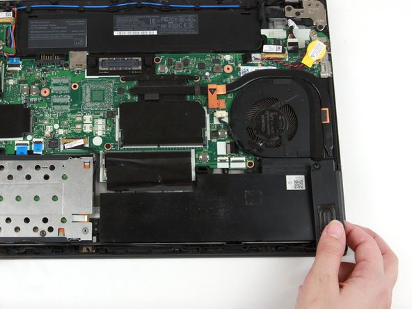

    • Use a Phillips #1 screwdriver to remove the single 5 mm screw from the speaker to the right of the internal battery.

    • Lift up the speaker to the right of the internal battery.
