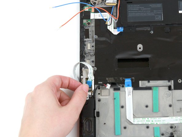

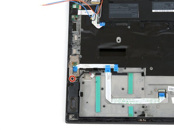

  48. Lenovo ThinkPad T470 Fingerprint Reader Replacement, Fingerprint Reader: crwdns2935265:048crwdnd2935265:01crwdnd2935265:02crwdne2935265:0 Lenovo ThinkPad T470 Fingerprint Reader Replacement, Fingerprint Reader: crwdns2935265:048crwdnd2935265:02crwdnd2935265:02crwdne2935265:0
    • Use a Phillips #1 screwdriver to remove the single 4 mm screw from the fingerprint reader bracket.
  49. Lenovo ThinkPad T470 Fingerprint Reader Replacement: crwdns2935265:049crwdnd2935265:01crwdnd2935265:02crwdne2935265:0 Lenovo ThinkPad T470 Fingerprint Reader Replacement: crwdns2935265:049crwdnd2935265:02crwdnd2935265:02crwdne2935265:0
    • Peel up the white ribbon cable.
    • Potential for device damage: The cable may be attached to the laptop with strong adhesive, so be cautious not to tear it.

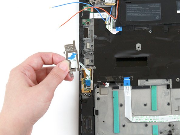

  50. Lenovo ThinkPad T470 Fingerprint Reader Replacement: crwdns2935265:050crwdnd2935265:01crwdnd2935265:03crwdne2935265:0 Lenovo ThinkPad T470 Fingerprint Reader Replacement: crwdns2935265:050crwdnd2935265:02crwdnd2935265:03crwdne2935265:0 Lenovo ThinkPad T470 Fingerprint Reader Replacement: crwdns2935265:050crwdnd2935265:03crwdnd2935265:03crwdne2935265:0
    • Use the flat end of a spudger to pry the metal bracket away from the fingerprint reader.
    • Use your fingers to lift the bracket up and away from the fingerprint reader.
