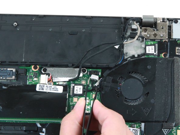

    • Use your fingers to lift the gray wire out its slot.
  10. Lenovo ThinkPad T460 USB Board Cable Replacement: crwdns2935265:010crwdnd2935265:01crwdnd2935265:02crwdne2935265:0 Lenovo ThinkPad T460 USB Board Cable Replacement: crwdns2935265:010crwdnd2935265:02crwdnd2935265:02crwdne2935265:0

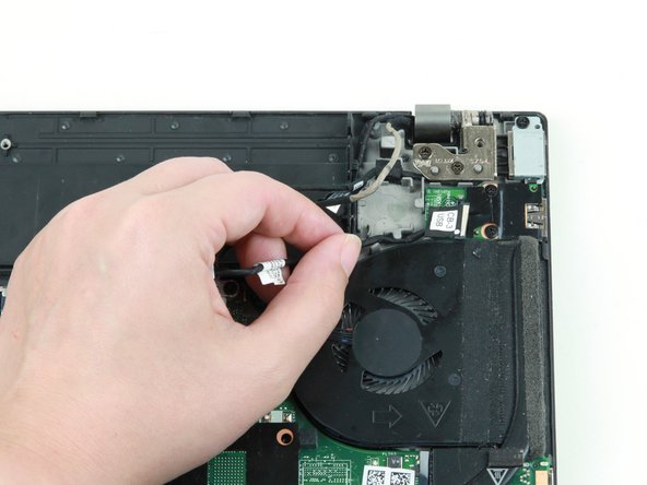

    • Use your fingers to lift the black wire out of its slot.

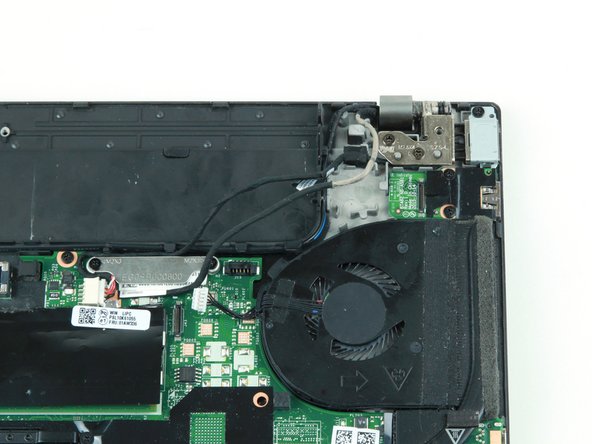

  11. Lenovo ThinkPad T460 USB Board Cable Replacement: crwdns2935265:011crwdnd2935265:01crwdnd2935265:02crwdne2935265:0 Lenovo ThinkPad T460 USB Board Cable Replacement: crwdns2935265:011crwdnd2935265:02crwdnd2935265:02crwdne2935265:0
    • Use a pair of blunt nose tweezers to pull the white fan connector out of its socket on the motherboard.
    • This connector may be difficult to remove. You can use a pair of tweezers to gently rock the connector back and forth until it is free from the socket.

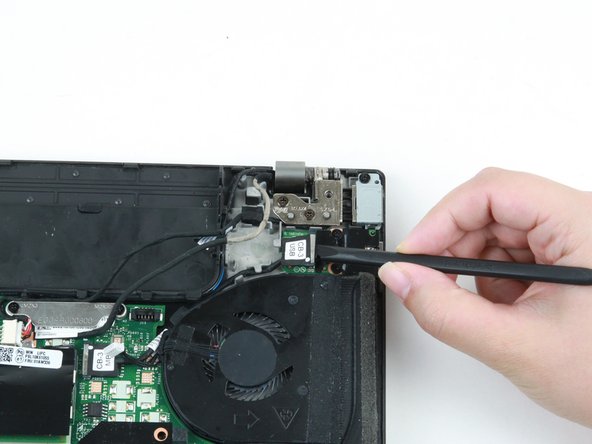

    • Use the flat end of a spudger to detach the USB cable from the USB board.

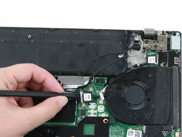

  13. Lenovo ThinkPad T460 USB Board Cable Replacement: crwdns2935265:013crwdnd2935265:01crwdnd2935265:02crwdne2935265:0 Lenovo ThinkPad T460 USB Board Cable Replacement: crwdns2935265:013crwdnd2935265:02crwdnd2935265:02crwdne2935265:0
    • Use the flat end of a spudger to detach the USB cable from the motherboard.

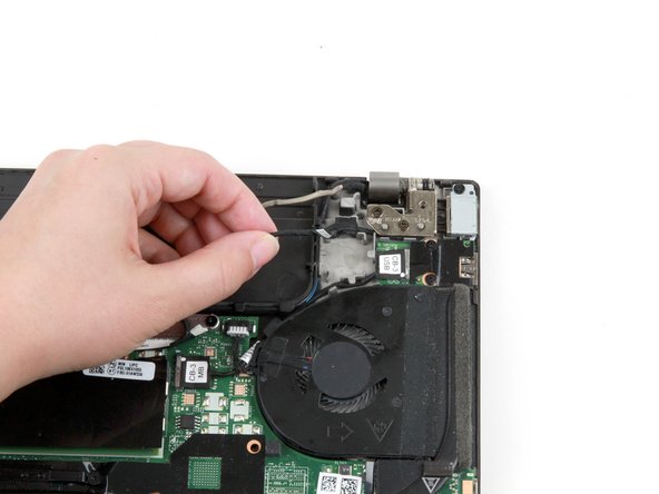

  14. Lenovo ThinkPad T460 USB Board Cable Replacement: crwdns2935265:014crwdnd2935265:01crwdnd2935265:03crwdne2935265:0 Lenovo ThinkPad T460 USB Board Cable Replacement: crwdns2935265:014crwdnd2935265:02crwdnd2935265:03crwdne2935265:0 Lenovo ThinkPad T460 USB Board Cable Replacement: crwdns2935265:014crwdnd2935265:03crwdnd2935265:03crwdne2935265:0
    • Use your fingers to lift the USB board cable up and away from the laptop.
