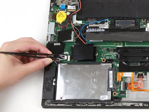

  12. Lenovo ThinkPad T460 Speakers Replacement, Speakers: crwdns2935265:012crwdnd2935265:01crwdnd2935265:02crwdne2935265:0 Lenovo ThinkPad T460 Speakers Replacement, Speakers: crwdns2935265:012crwdnd2935265:02crwdnd2935265:02crwdne2935265:0
    • Use a pair of blunt nose tweezers to pull the white speaker connector out of its socket on the motherboard.
    • This connector may be difficult to remove. You can use a pair of tweezers to gently rock the connector back and forth until it is free from the socket.
